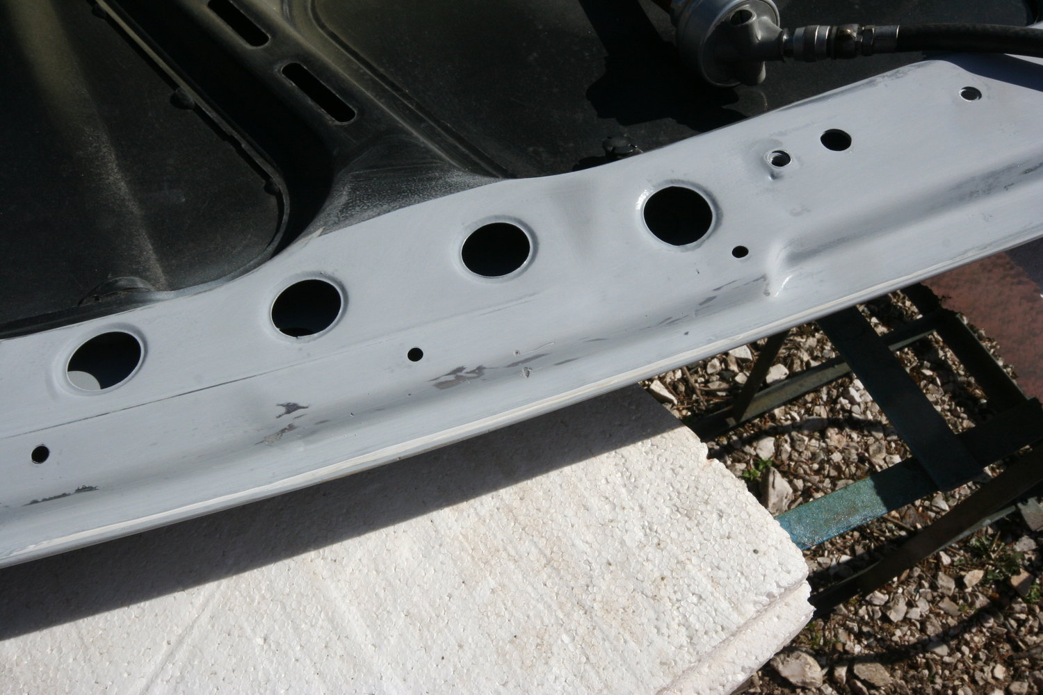

There has been a long term debate going on over many threads as to which is best, epoxy or epoxy mastic.
I don’t think there is a one size fits all solution but I do think the biggest difference is DFT (dry film thickness) and the more paint you put on the better the protection you will get, but too much paint can cause craching and is just a waste.
If you are brushing, it's very easy to get a low spot at the bottom of the brush marks, with spraying it easy to miss a bit, or not get full coverage in a blind corner.
In industry the spec usually calls for a check on DFTs (hundreds of readings) and a spark test where the painted item is earthed and a soft wire brush at a high voltage is brushed over the coating.
If there is a pin hole or other defect the equipment will register a short to earth and identify a defect which can be dealt with.
This isn’t really practical in the DIY world so a better option is to check the paint every now and again and fix any issues as they appear.
It's normally just a spot here and there, unless there is a bigger issue which need sorting anyway.
