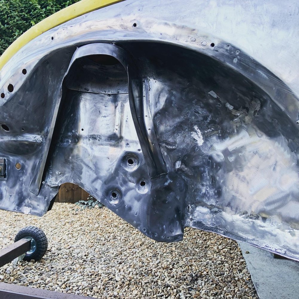

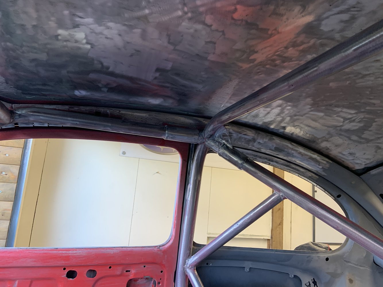

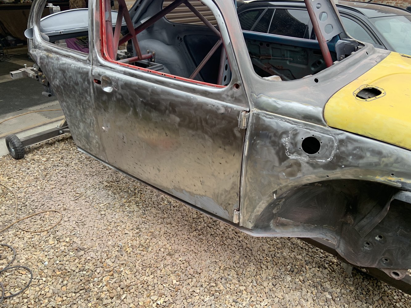

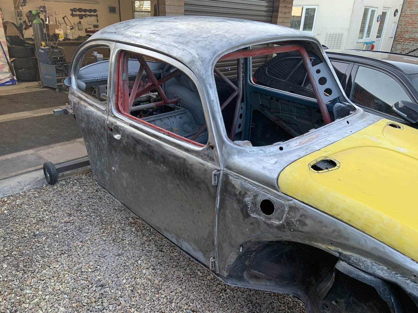

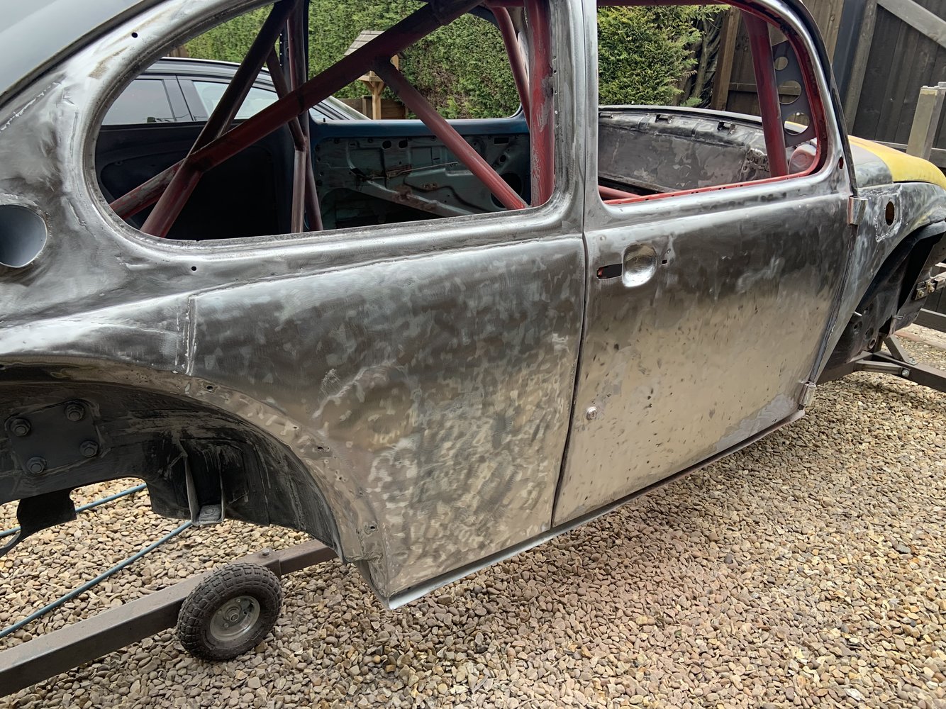

They do and I have.
Jotun Barrier 90.
It's great stuff but needs better prep than the 87 / 90 type so ideally grit blasted before application, if that's done it will last 20 years in highly corrosive environments like marine, so should be fine for your job.
If you can't blast or bristle blast which is the recommended mechanical prep, I'd use 87 or 90A which has added aluminium that gets you most of the performance of the epoxy zinc, but is nicer to use doesn't need as much prep (but the better the prep the better the performance) and it's cheaper.
If done right you shouldn't need to worry about doing it again.
It's what I did on my alfa project and the thread gives a reasonable amount of detail on the process.
