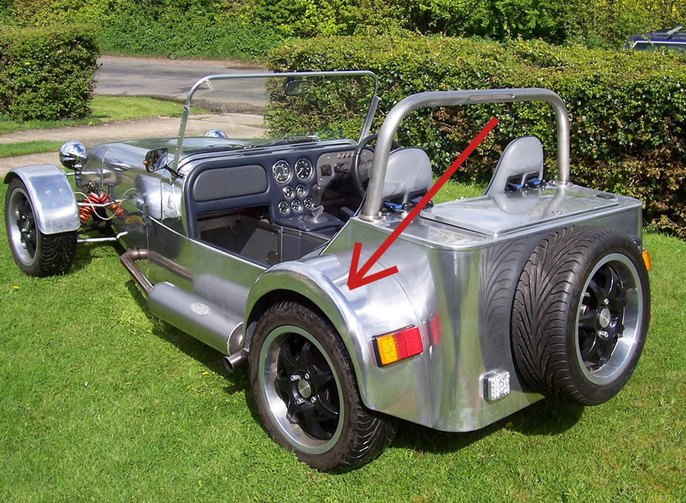

My upper wheel was made from SCH80 8" steam pipe so 8-5/8" od, and my smallest bottom anvil was made from a 50mm tow ball.
This was a special to enable me to form the rads on my cars wheel arches (arrowed) & front mudguards.
It worked quite well. (see pic)
All my other anvils were made from 2" round bar and seem to be in proportion to the top wheel.
