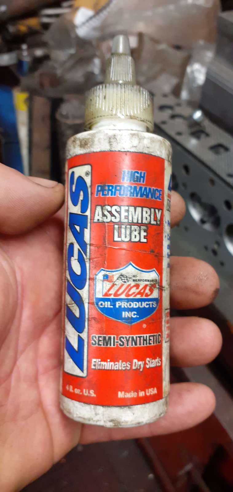

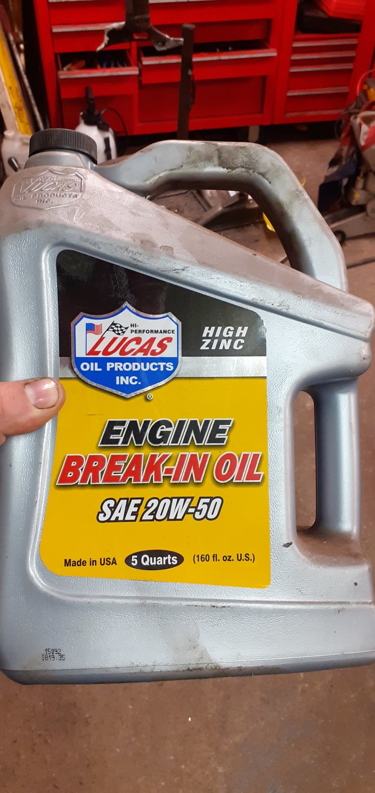

I always used a 50/50 mix STP oil treatment and l preferred 20/50 Duckhams green oil. (That might age me abit).
I have used graphogen mainly on ohc cylinder heads that will sit on the shelf for a while, just so the lub doesn't drain out over time.
If you can prime the oil system without turning the engine over do so.
