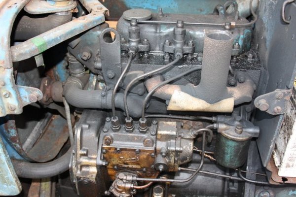

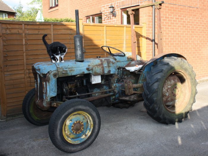

remember if you undo the top filter you will need to bleed the diesel to the injectors to restart it ,maybe a fuel primer(a lever)to help....any pics of the whole tractor?

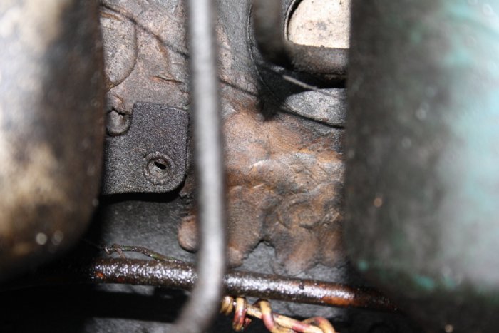

Wassat then, someone plopped a load of braze over it?
There's fingerprints in it, so its some sort of epoxy repair compound.
It's a Perkins!
I noticed that it has the latest modification of the four turn twisted stop cable
There are a few of these about as boat tuggers down where I spend all summer and needless to say I get a few " can you just's "
Ref. it jumping out of gear, try to get it sorted before attempting any hills, the brakes aren't that brilliant, if it pops out on a decent it mainly results in the washing machine being needed when back home
I don't know if you have this but here goes http://www.fordson-dexta.de/downloads/section4.pdf.
It covers all you will need to know to do running repairs on the pump, covering replacing the govenor diaphragm and timing the pump, which looks like it will need to be removed to do a permanent repair to the block.
