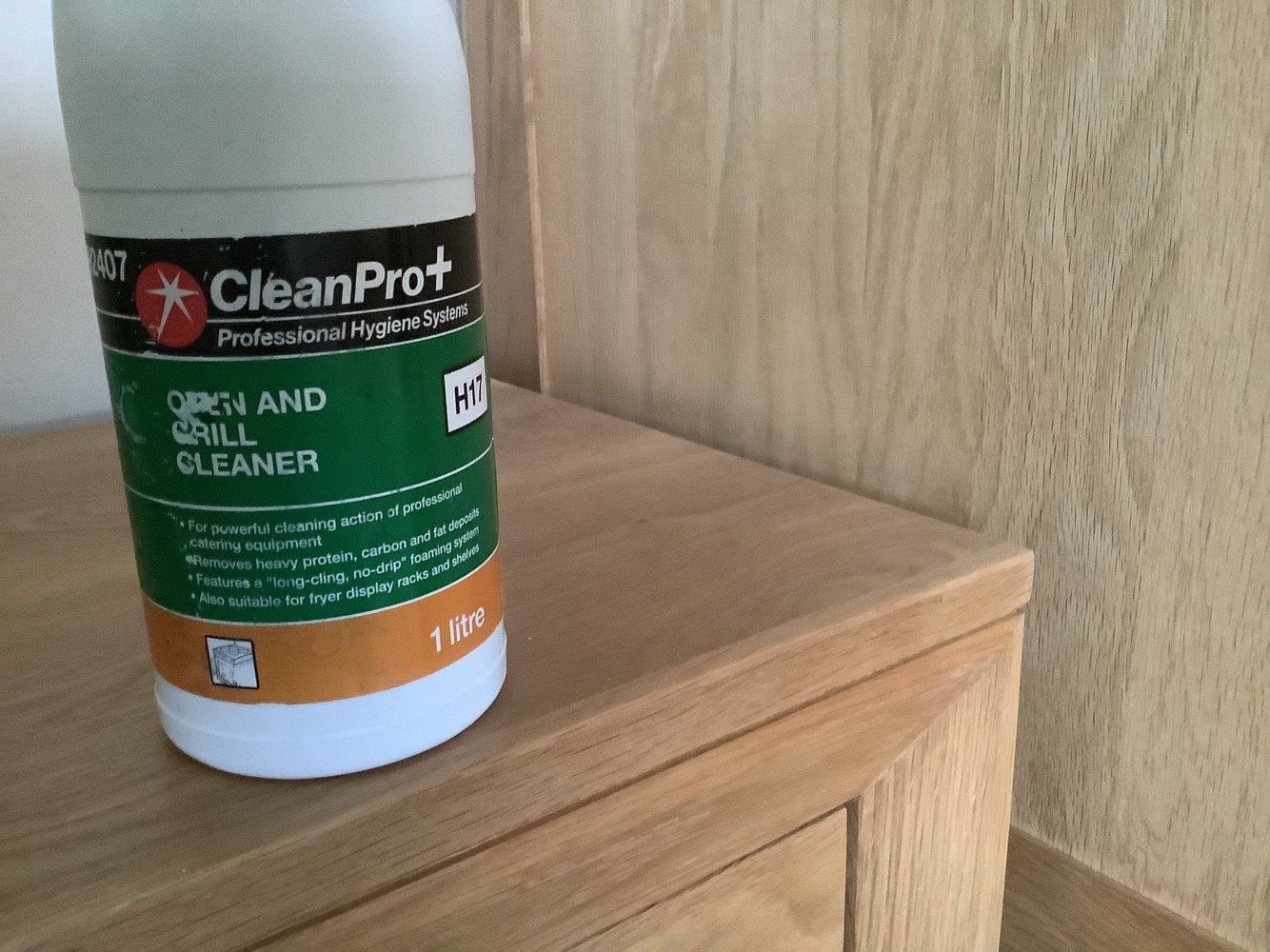

I bought a bottle of CIF oven degreaser, best available, removes burned in fat etc etc, and it was covered in warnings and safety instructions, respirator, mask, gloves, eye cover blah blah.….Yes, I know Sodium Hydroxide is Caustic Soda but in the oven cleaner products it's for use in the domestic arena so will be weaker but if left to work it's still effective. For general workshop cleaning I use petrol and or thinners as they are effective, readily available and cheap. For heavier soiling, I use petrol first then progress to thinners after that, especially for burnt on oil I go to oven cleaner.
