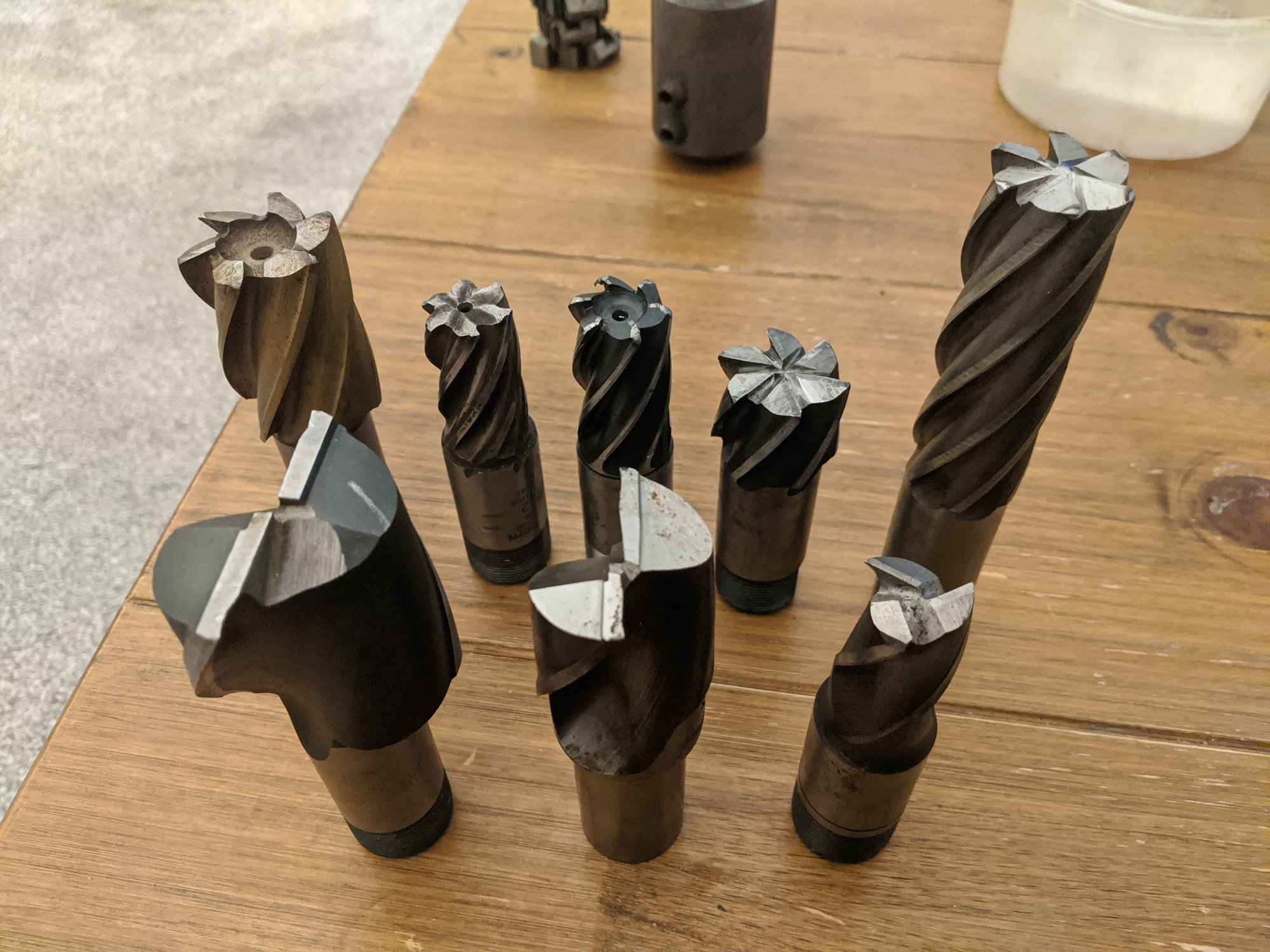

grim_d Unlikeable idiot. Messages 4,160 Location Scotland - Ayrshire Mar 5, 2020 #1 I've a small collection of "bigger" endmills that all have very sad cutting faces, anyone on here able to sharpen them up for me for some beer tokens? Biggest is a 1 7/8 two flute. There are some with chipped teeth that may not be salvageable.

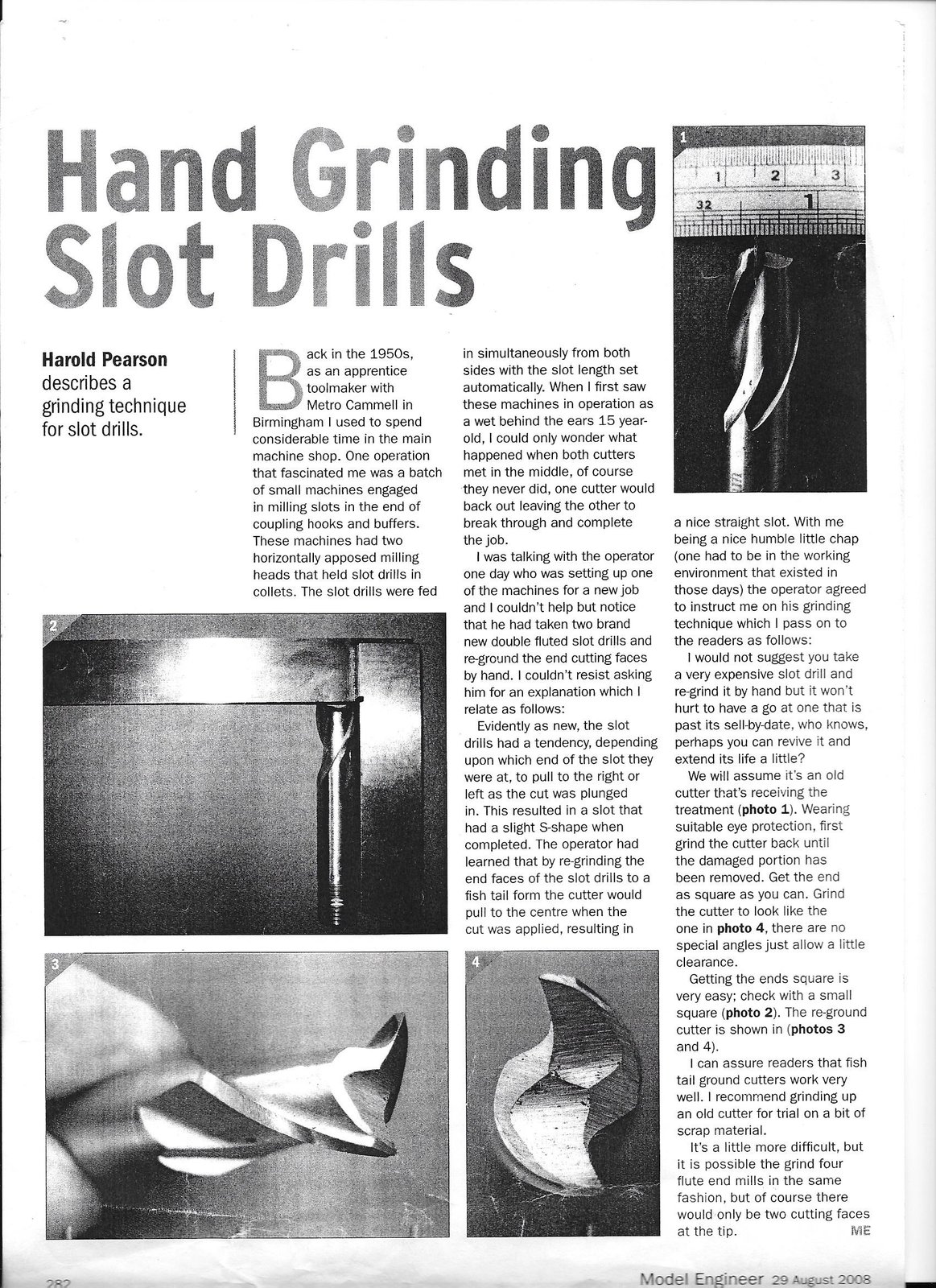

brightspark Member Messages 41,546 Location yarm stockton on tees Mar 5, 2020 #2 here do it yourself Scan0001.jpg 489.3 KB · Views: 145
gaz1 Member Messages 20,632 Location westyorkshire Mar 5, 2020 #3 he cant he needs what some of us have to sharpen them
grim_d Unlikeable idiot. Messages 4,160 Location Scotland - Ayrshire Mar 5, 2020 #4 gaz1 said: he cant he needs what some of us have to sharpen them Click to expand... Skill, talent and patience?
