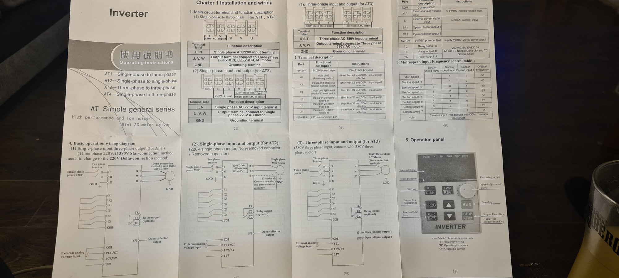

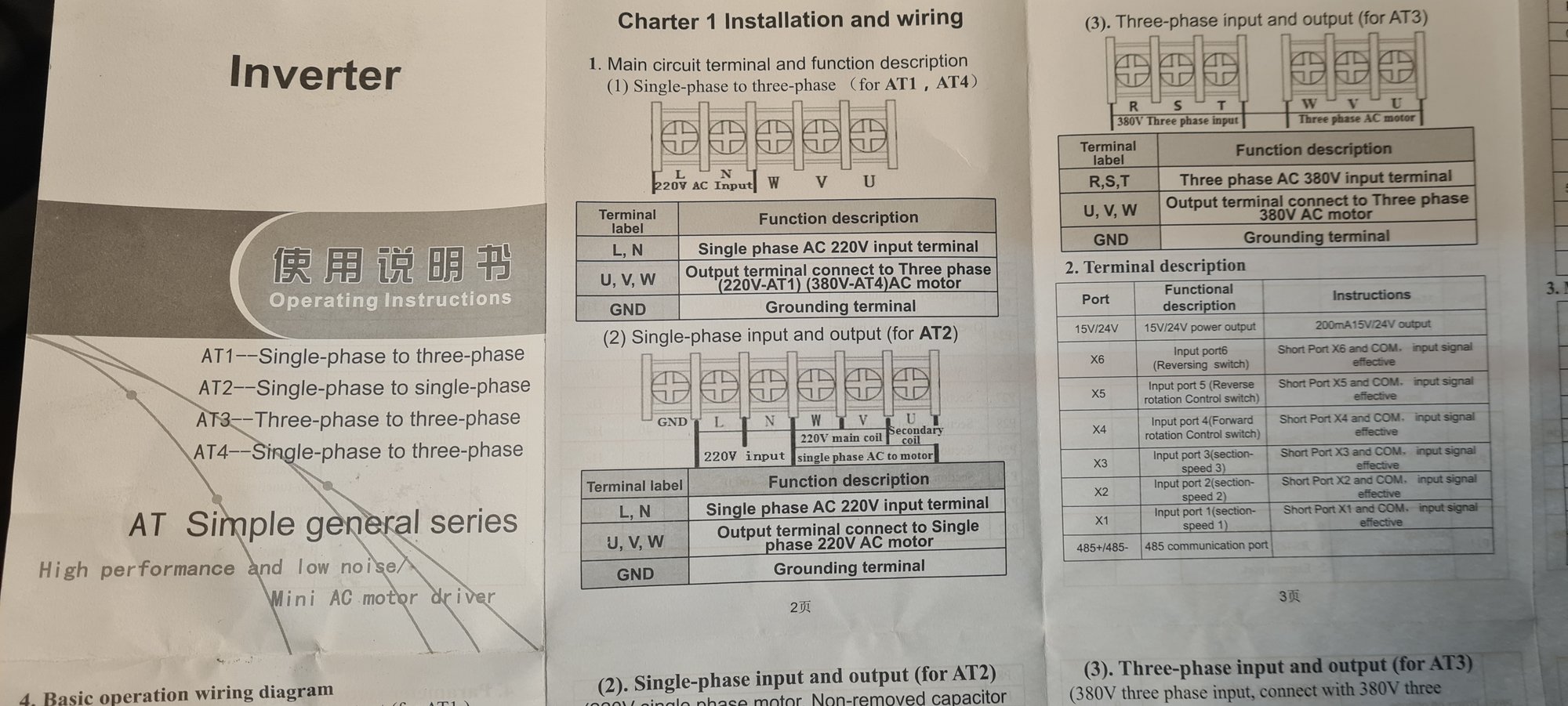

I have been at it again trying to find the way to go with wiring an emergency stop button with the VFD for my lathe. Looked on the internet as usual but there isnt an easy answer to go by for me. I see folk mention relays and stuff.
What i am wanting is for once the E stop is pressed and when i turn the knob to reset it is for the lathe not to come on untill i turn it on again on the VFD.
Will the VFD just shut down when the E stop is pressed ?
