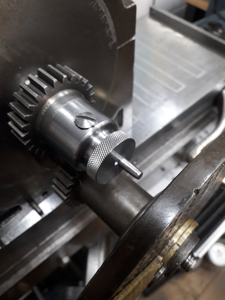

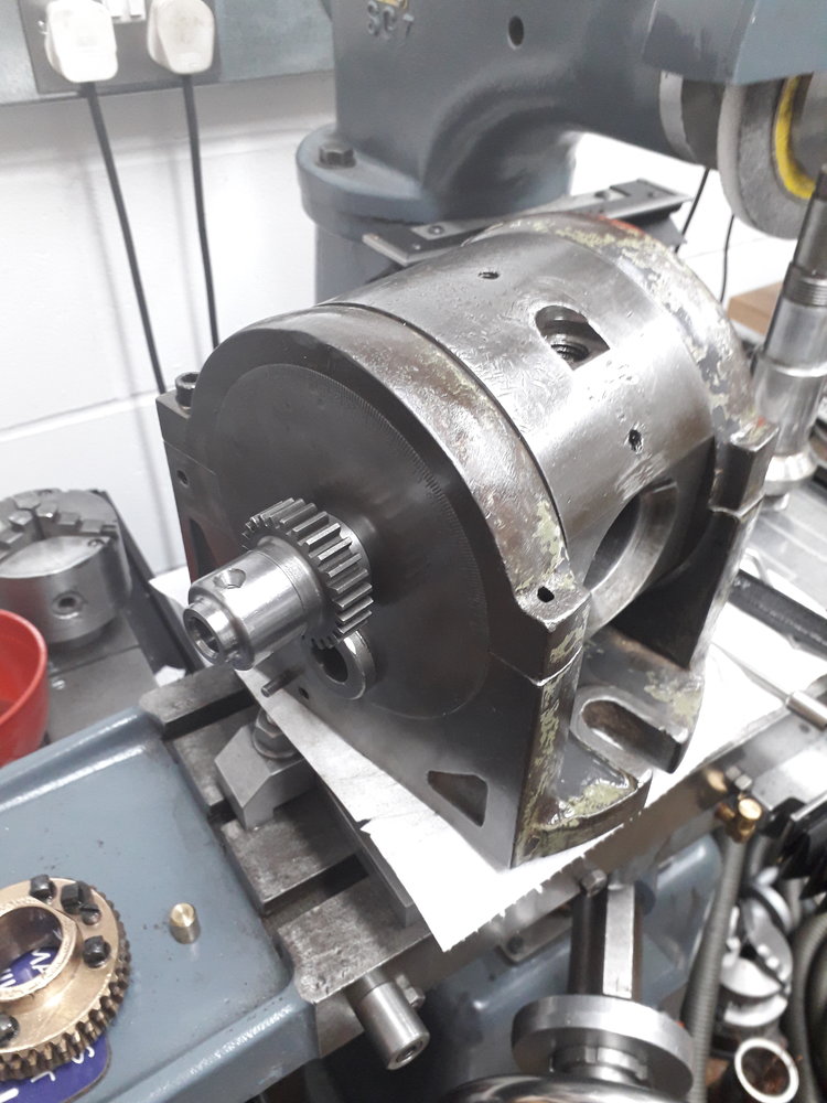

This arrived courtesy of DPD the other day:

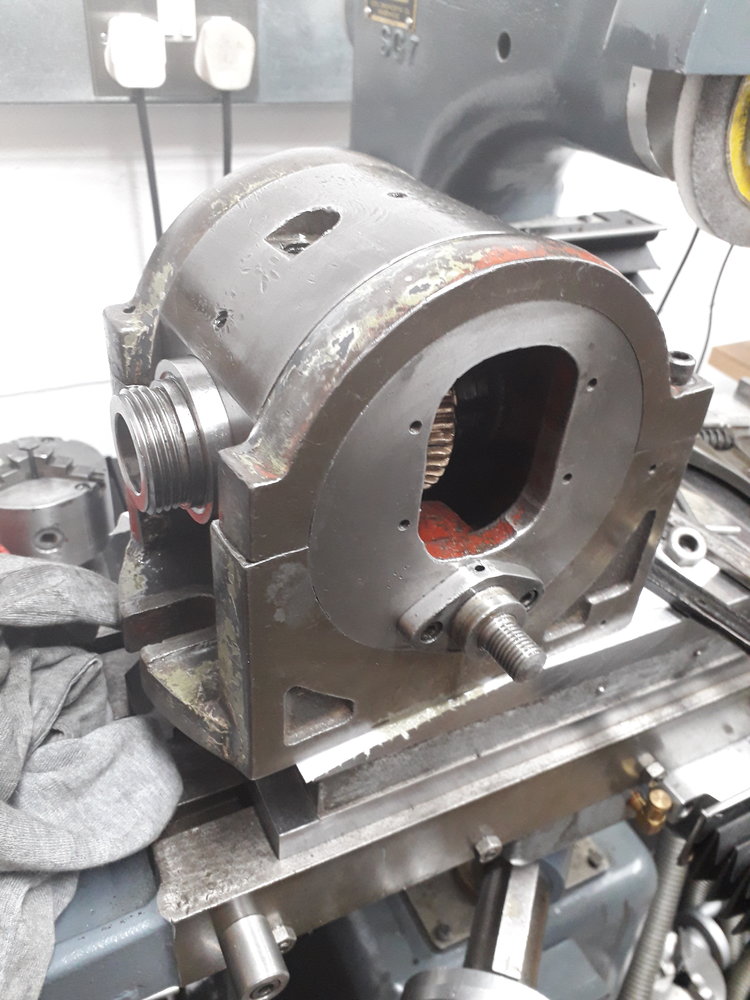

I bought it off @skotl. My hope was that as it is a 3" dividing head, rather than the 7" I already have, it would be a bit smaller and fit on the shaper a bit easier.

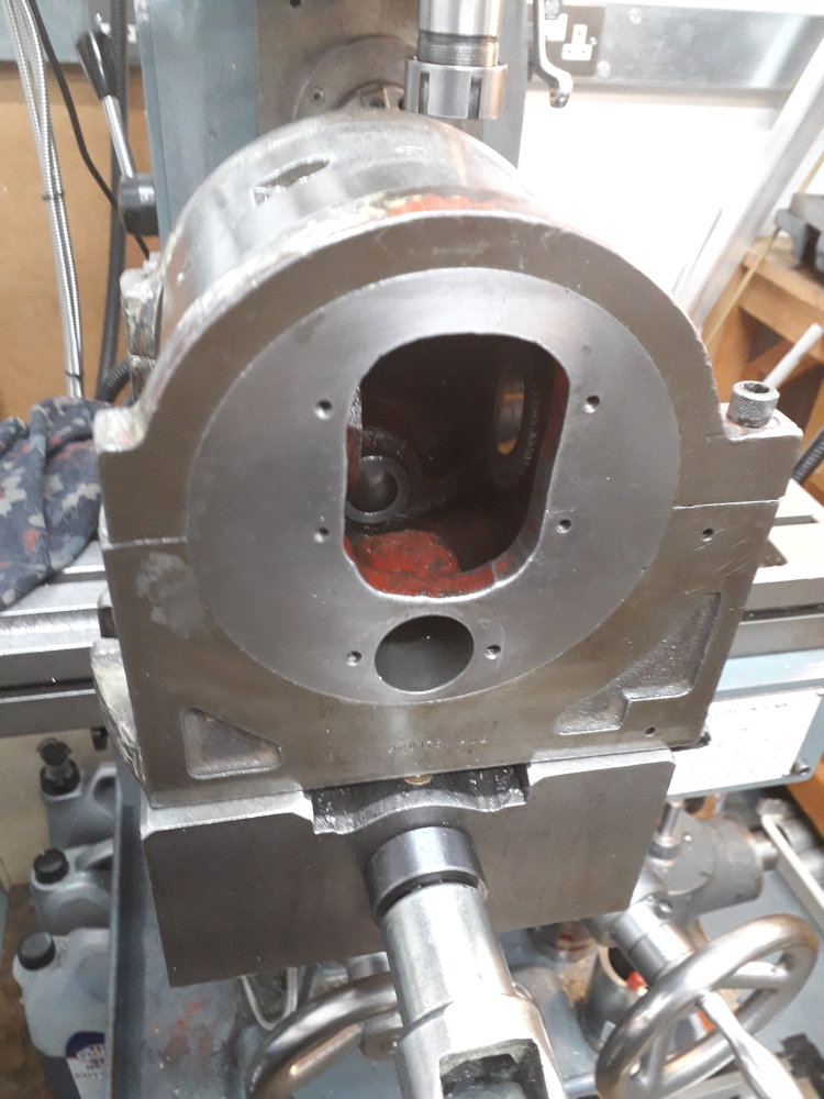

Wrong! Having taken it to bits to start a full refurb, I offered up the base casting to the 7" mounted on the shaper. Turns out that the head that this belongs to
is exactly the same as this
Swing being the difference, oh and ignoring the extra 1/2" . Never mind, it's going to get the full treatment before I sell it I guess. Don't need two.

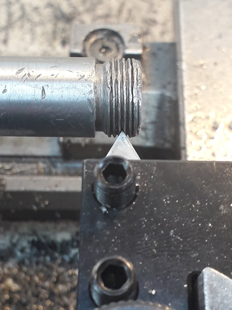

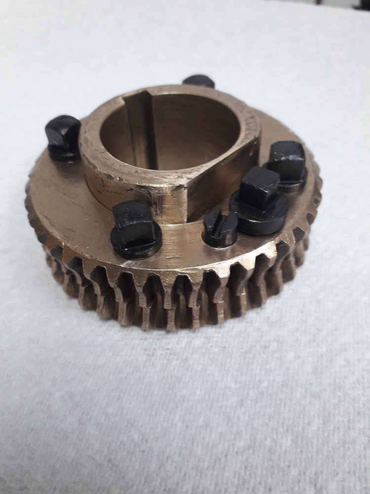

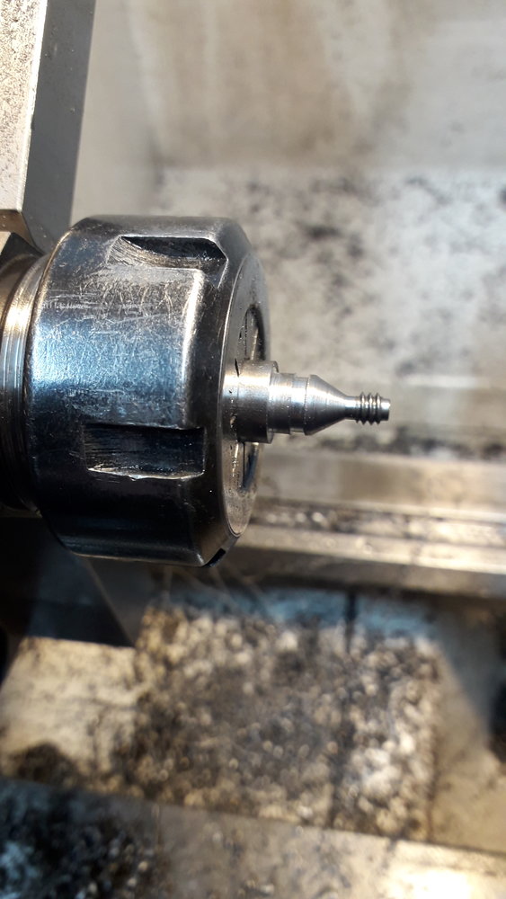

So work on it has begun. I stripped it to bits, except that the chuck was stuck fast to the spindle, really tight, even after cooking it with a propane torch, gripping the spindle in my bench vice and giving the backplate a few whacks on some screws placed in the chuck mounting holes (until one screw sheared off and I gave up). I resorted to the lathe, parting off the backplate close to the spindle:
I managed to avoid the spindle itself and once I'd broken through the backplate came off easily.

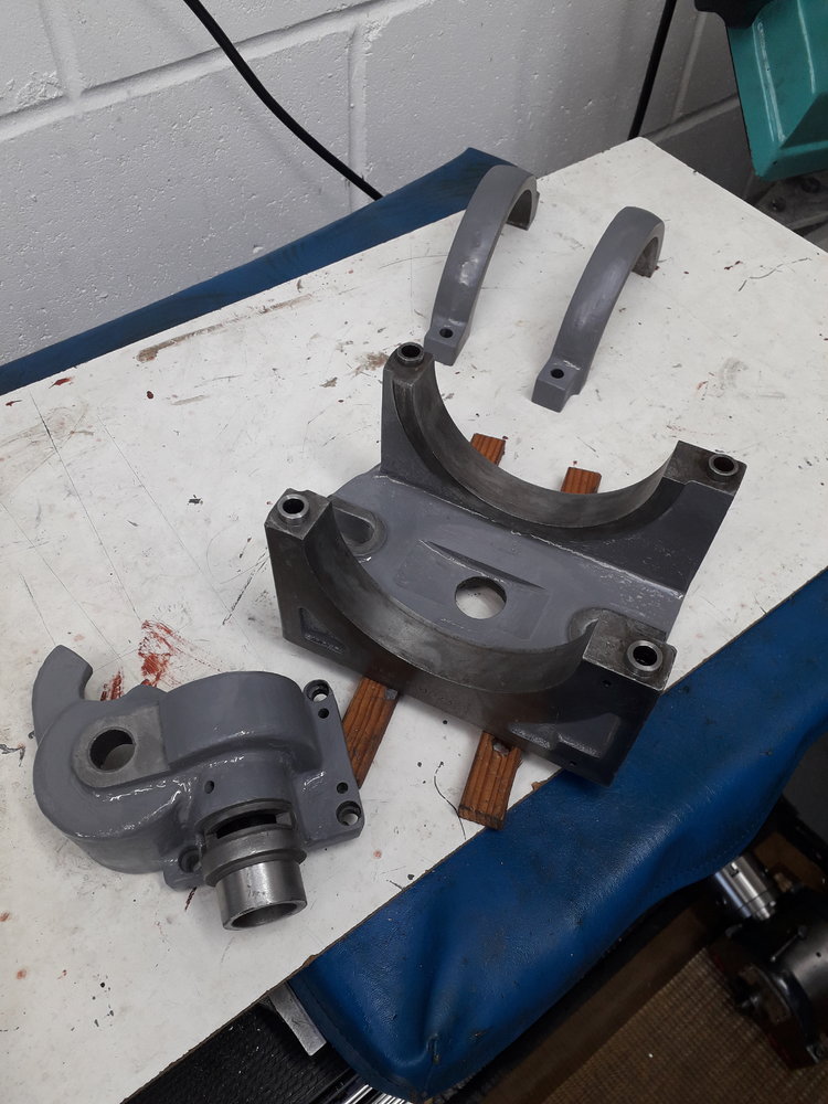

This is the collection of bits after disassembly, after a wire brushing and a bath in white spirit. It was filthy:

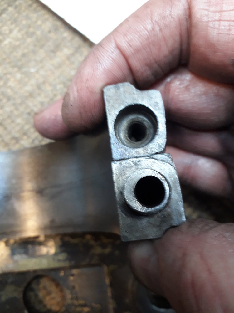

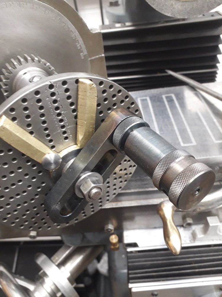

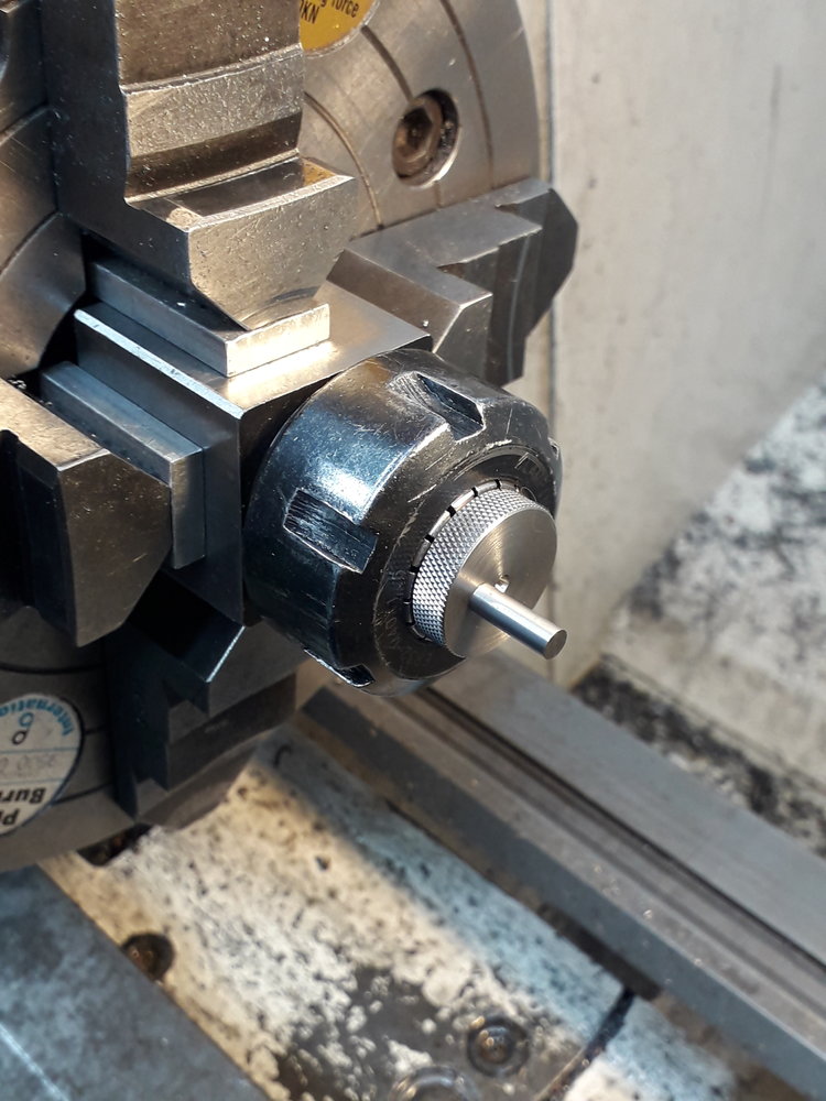

I started on the chuck first, which I'll probably keep as its in reasonable nick apart from the "clumsy b*****d" marks. More wire brushing, filing the dings flat (it's not the same shape as an anvil, so why has it been treated like one?), removing burrs and oiled (nearly said "re-oiled", but it hadn't seen any in a long time) it looks like this (with the old screws for comparison):
