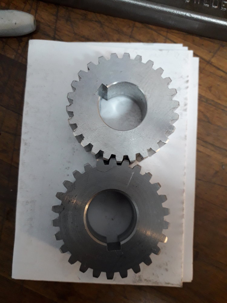

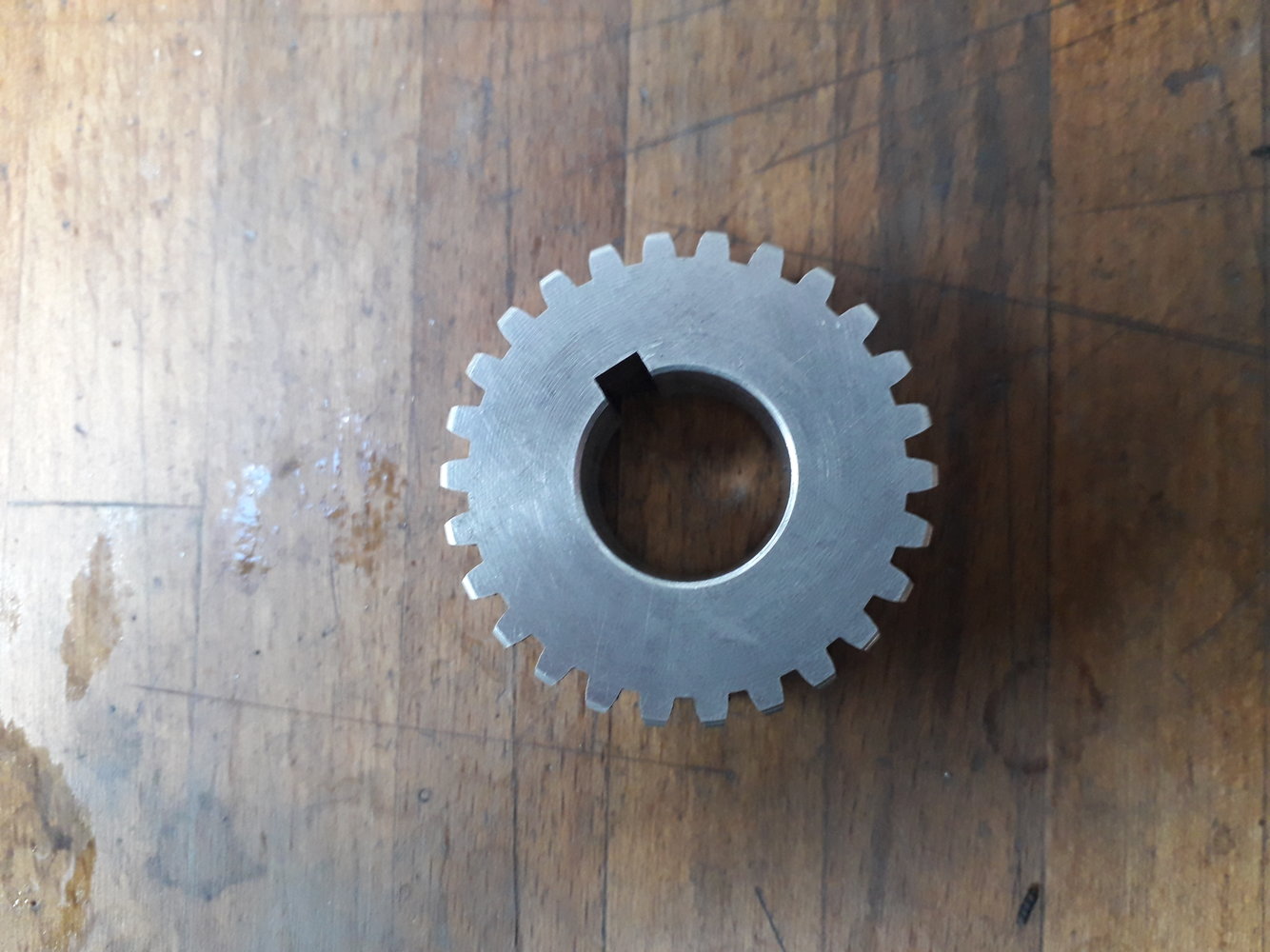

And the finished article:
To me, the teeth don't look deep enough, Not sure what I did wrong there.

And the final result, steel beneath, ally above:

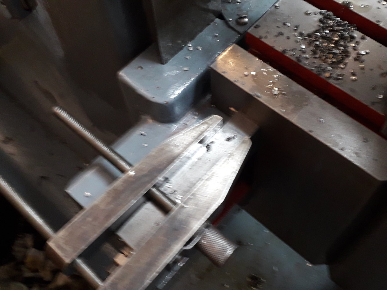

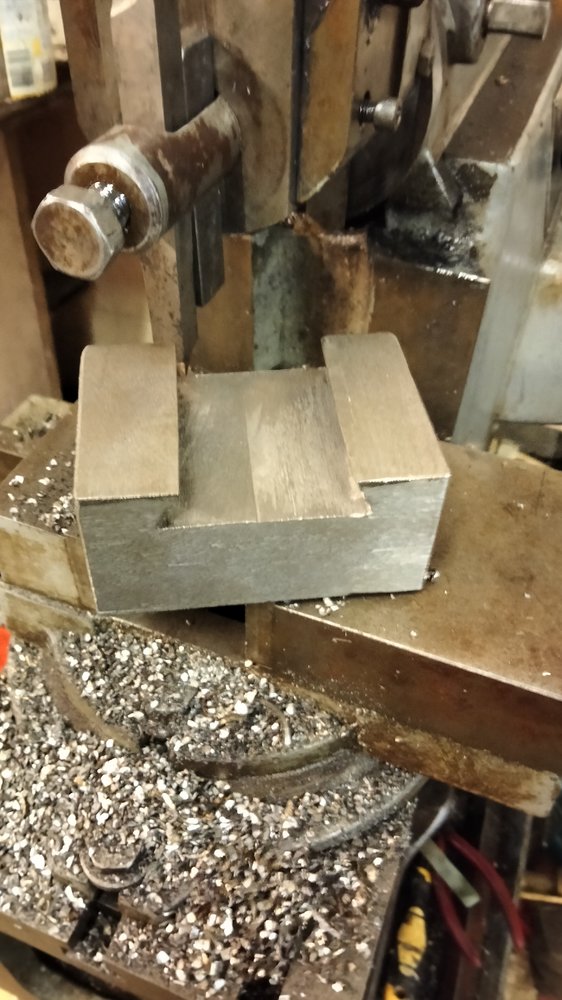

A few other bits of info. Setting up the toolbit vertically:

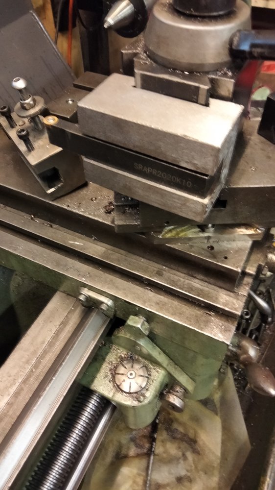

Highly sophisticated marker on top of the ways to indicate where to rewind to (yup, gaffer tape):

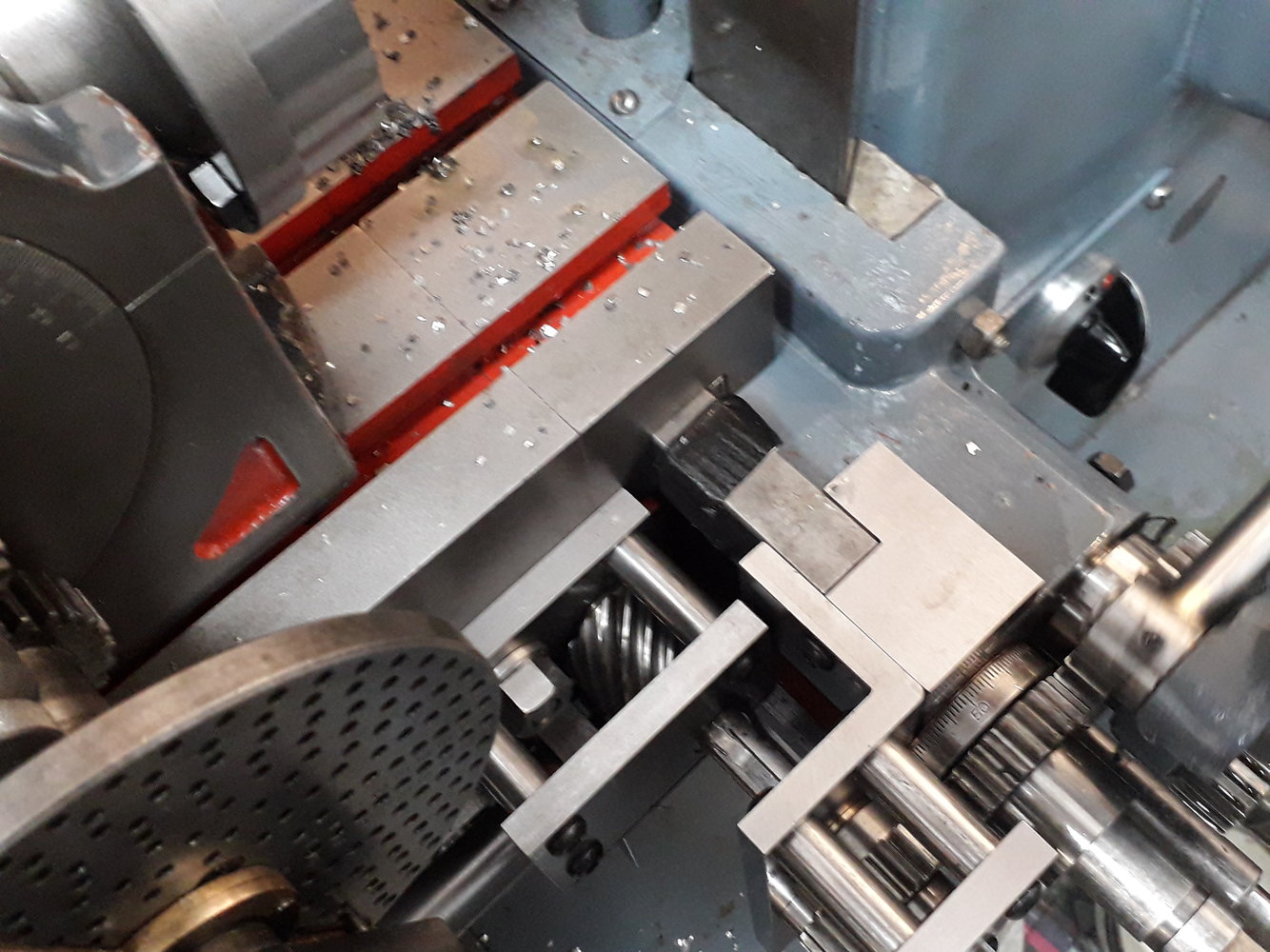

I used a clamp to indicate where to stop the cut, set after the first tooth was cut full depth and the tool was no longer touching the workpiece. Sorry for the blurriness:
