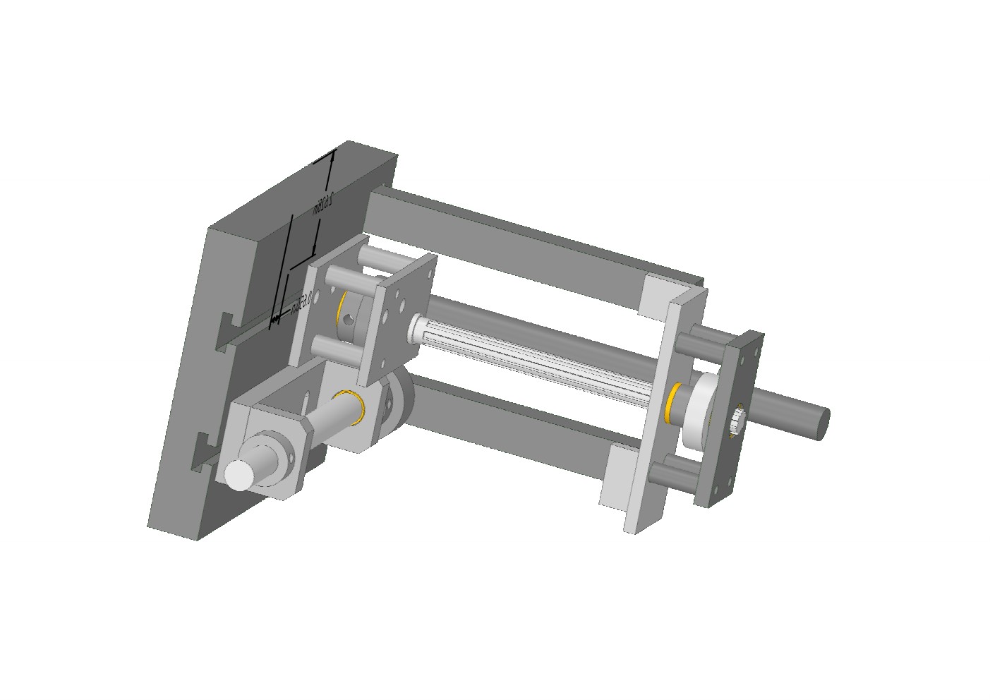

As the aim is to rotate the workpiece exactly proportional to the linear travel, I figured I could tap off the cross slide gear with another shaft as that achieves this. The next problem is to hold the work, index it but also rotate it as the table traverses. Well, I have an Elliott universal dividing head which achieves just that! So all that was needed was an attachment to join the cross slide gear to the dividing head with a gear train with the right gear ratio. I designed it initially on a 3D package (Designspark) because its quicker and cheaper than making mistakes in metal. One over-riding aim was that there should be no permanent mods to the shaper, no drill holes for example, just clamp on:
Gears here are just drawn as discs. The gear on the right picks up the drive from the cross slide gear. It has an internal spline to drive a shaft that runs side to side. The left hand end of this shaft is bolted to the table and moves left and right with it, hence the spline. A pair of 45 degree helical gears turn the drive through 90 degrees onto another shaft bolted to the T slot in the side of the table. The end of this second shaft will carry the first gear in a train that drives the dividing head universal drive spindle.

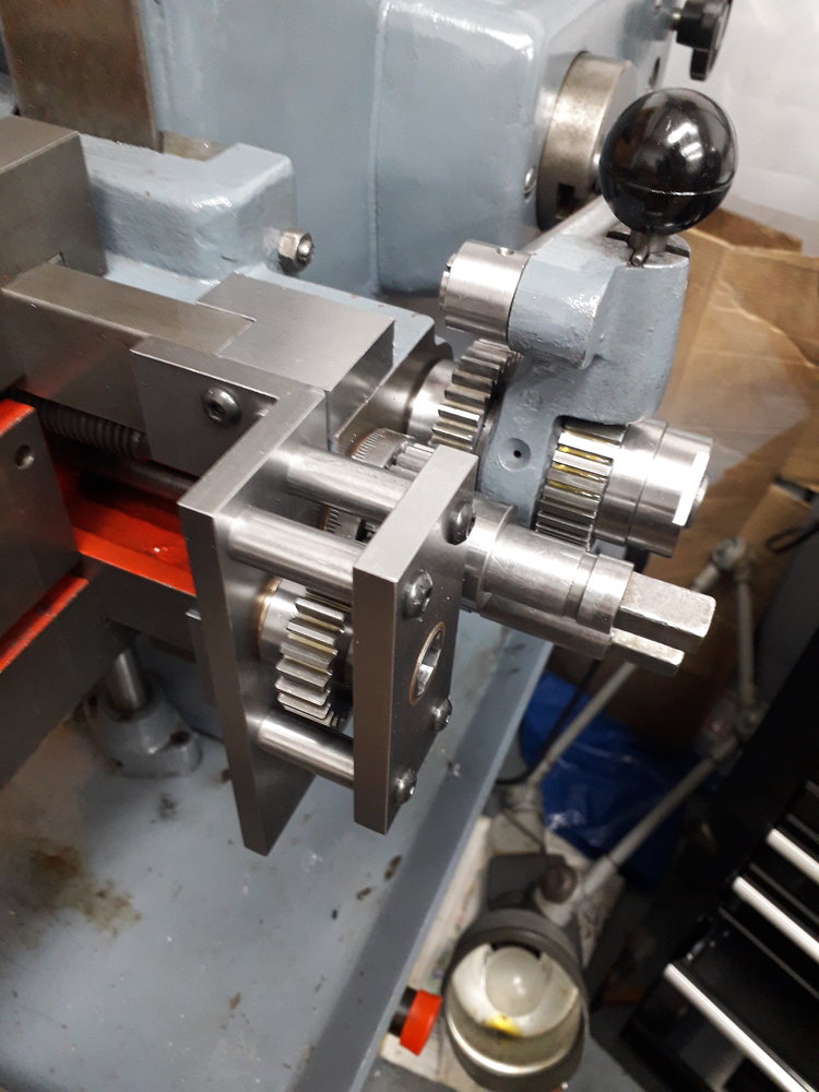

Pick-up gear assembly, clamped to the ways:

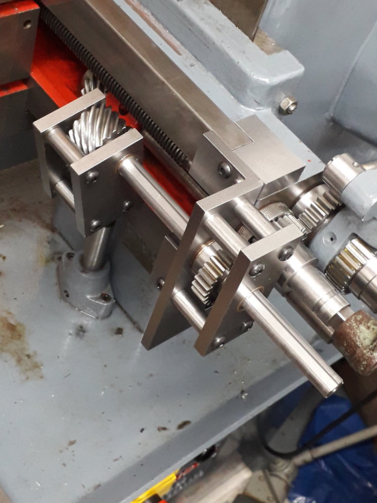

Splined feed shaft before its bracket is bolted to the table:

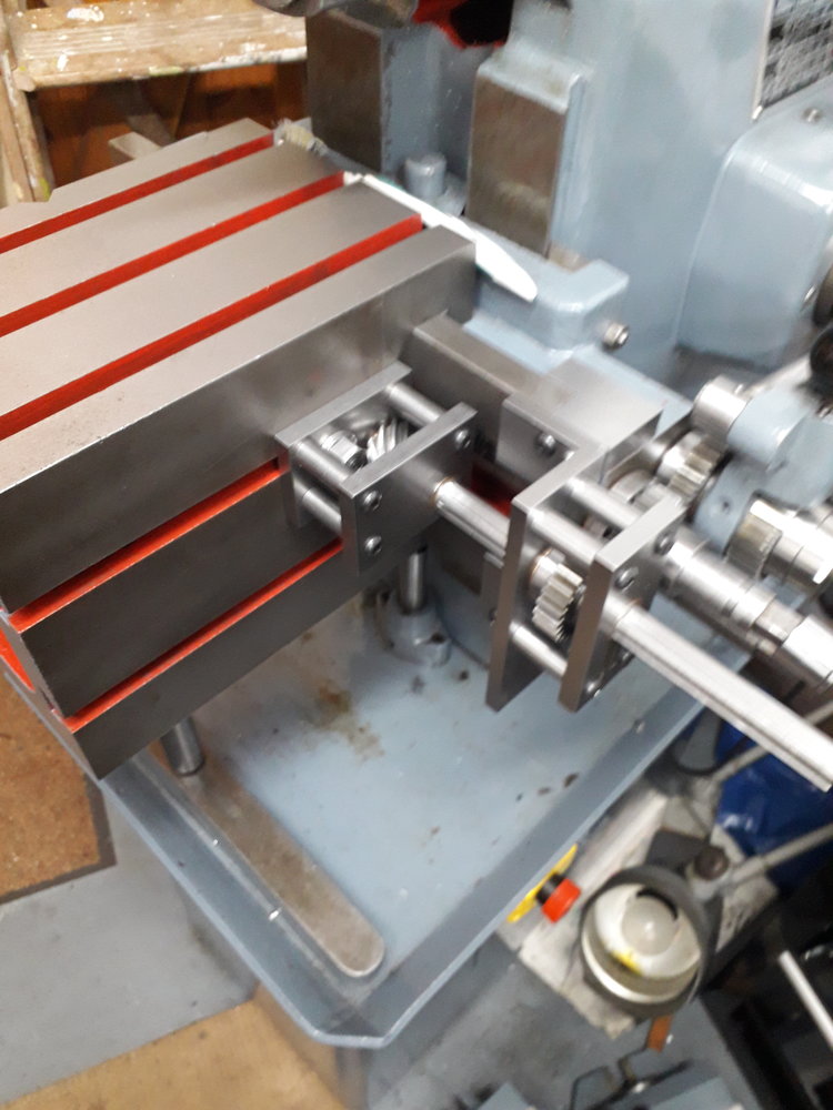

This is then bolted on so everything runs smoothly:

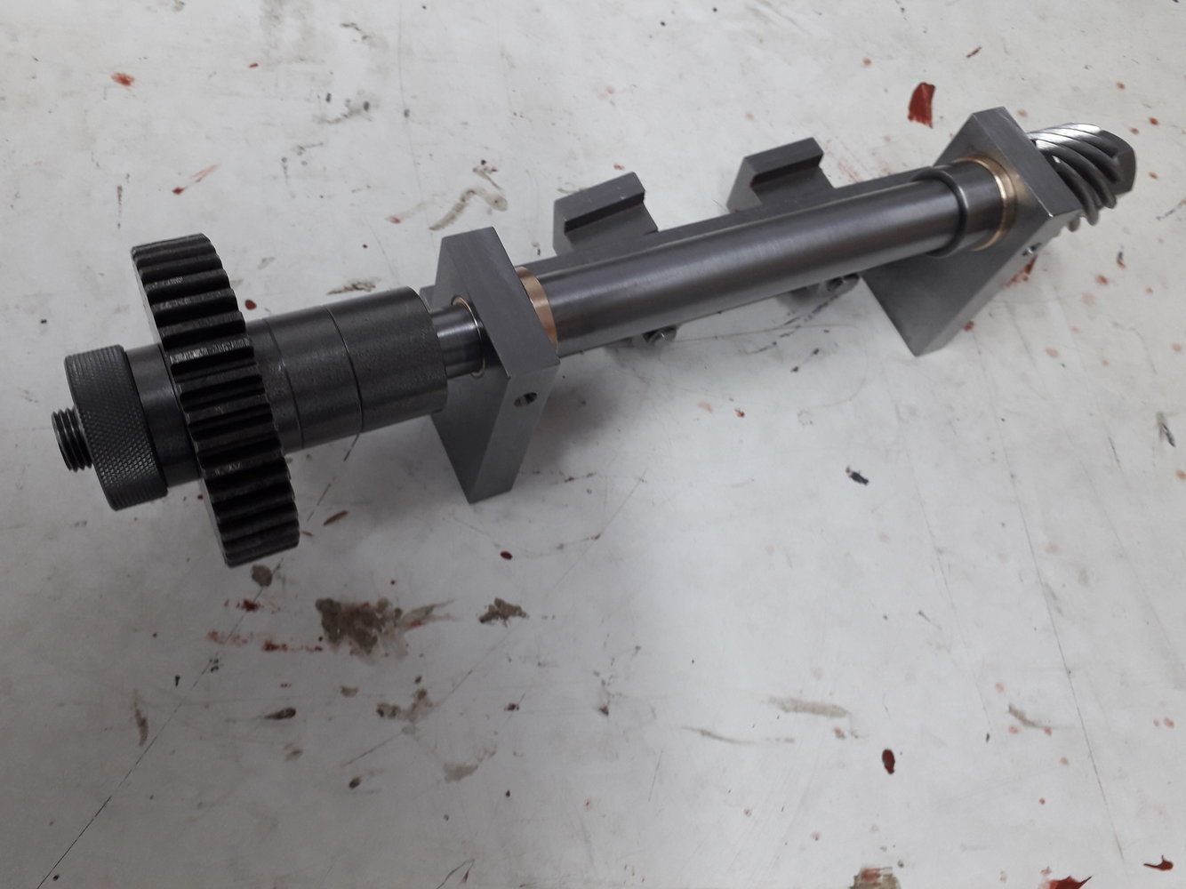

The next shaft has a bracket with slots for T nuts and studs so the mesh of the helical gears can be adjusted:
And here it is bolted to the table:

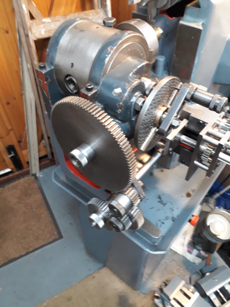

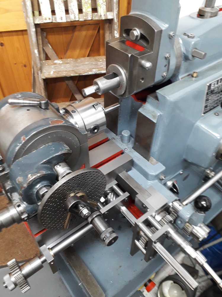

Finally the gear train is fitted to the dividing head banjo to join everything up:
Sorry about the blurred images. Note the spindle locking lever has been removed from the dividing head and replaced with a bolt to keep the chips out. Clearance is tight and there is a possibility of it rotating into the toolholder - the shaper wont care but it would do a lot of damage somewhere!
