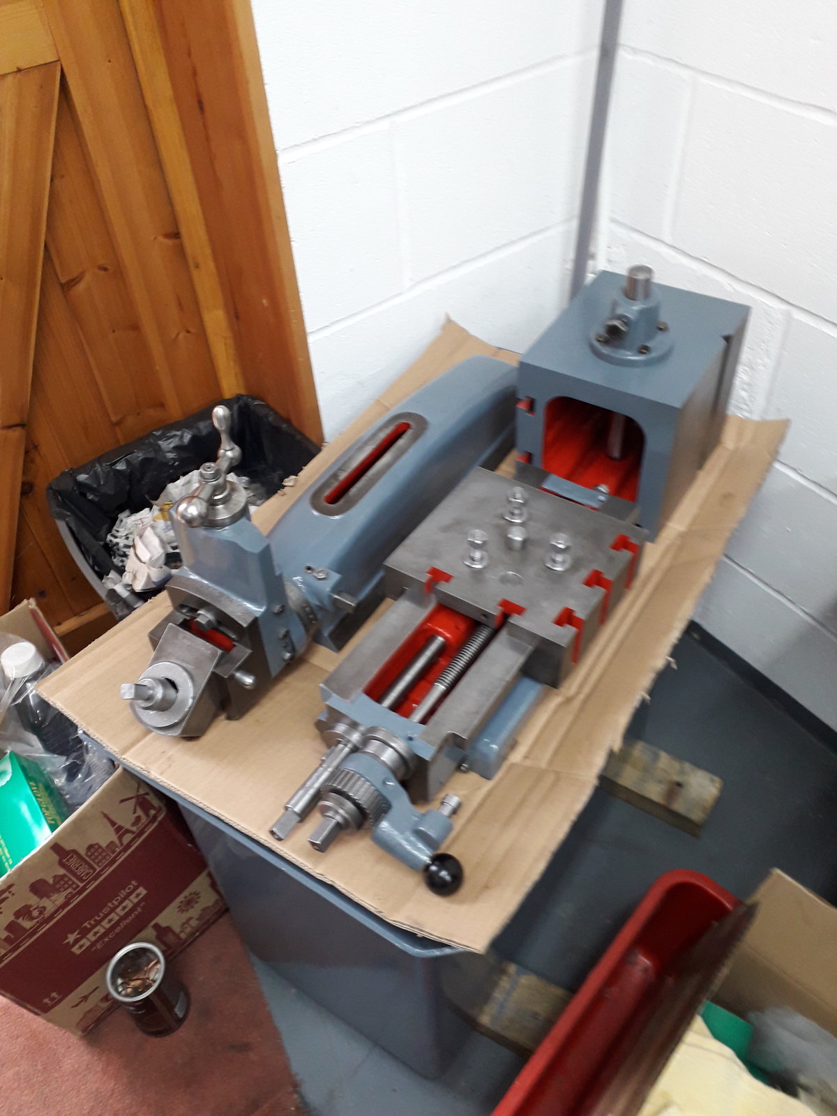

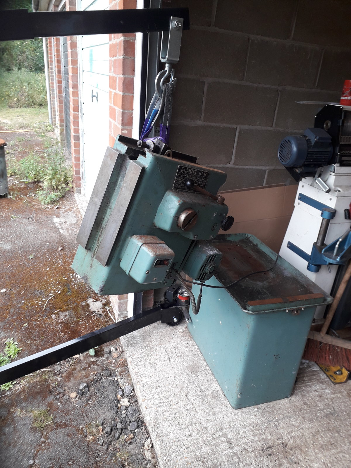

Nice one, I thought I saw you down my waydid you get the vice that was on it on it

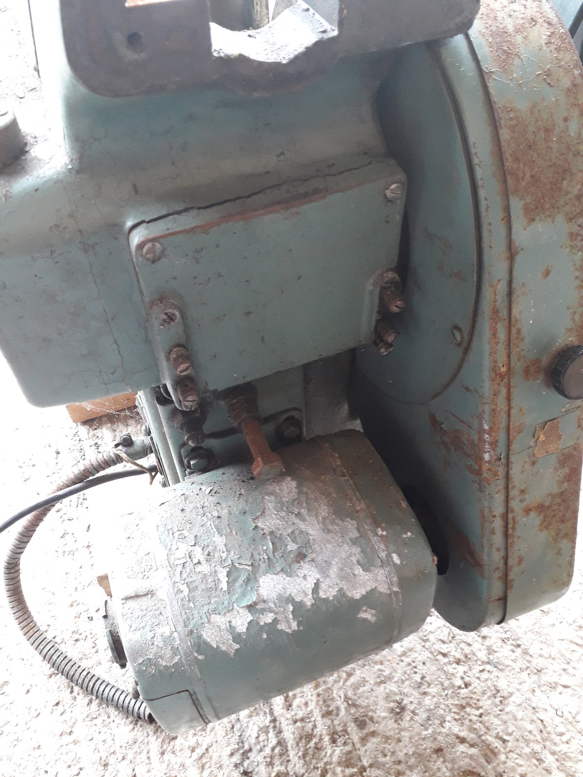

I have the same machine

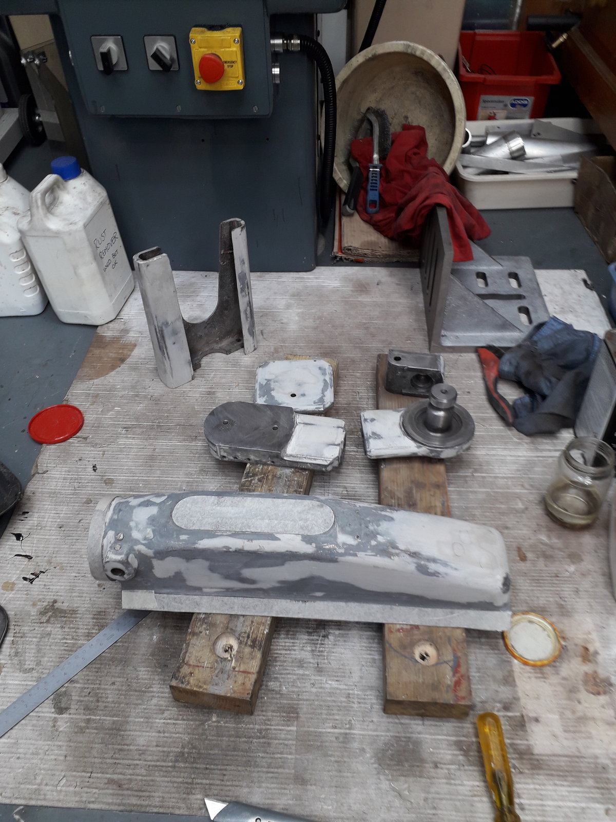

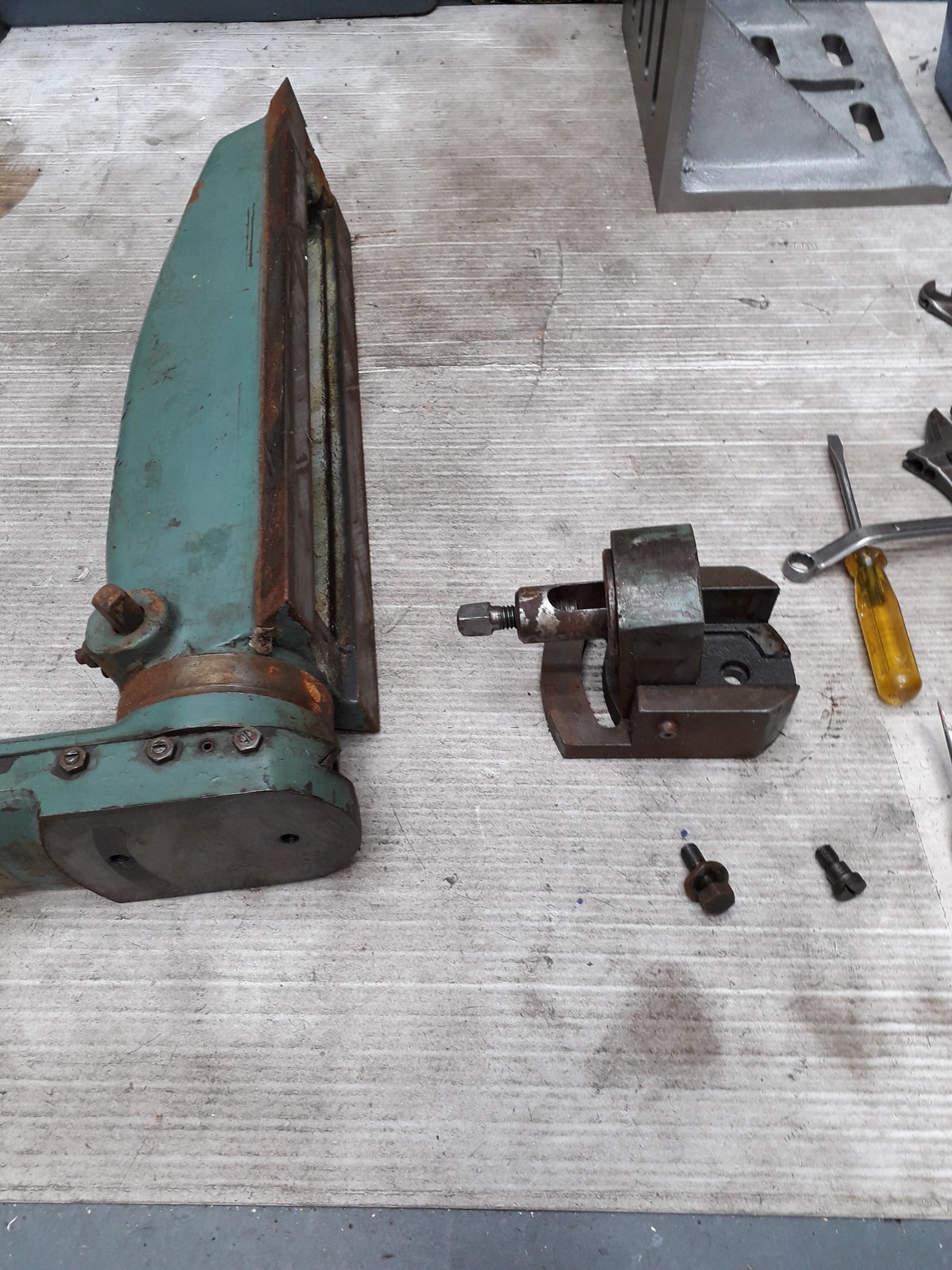

Yup, it came with the vice. I dismantled everything that would make it a bit lighter before moving that would come off easily, such as the base and the vice. I'd love to get started on the resto, but I've got the Eagle SG to finish first. I'm saving the shaper up for retirement, which isn't far away, hopefully.

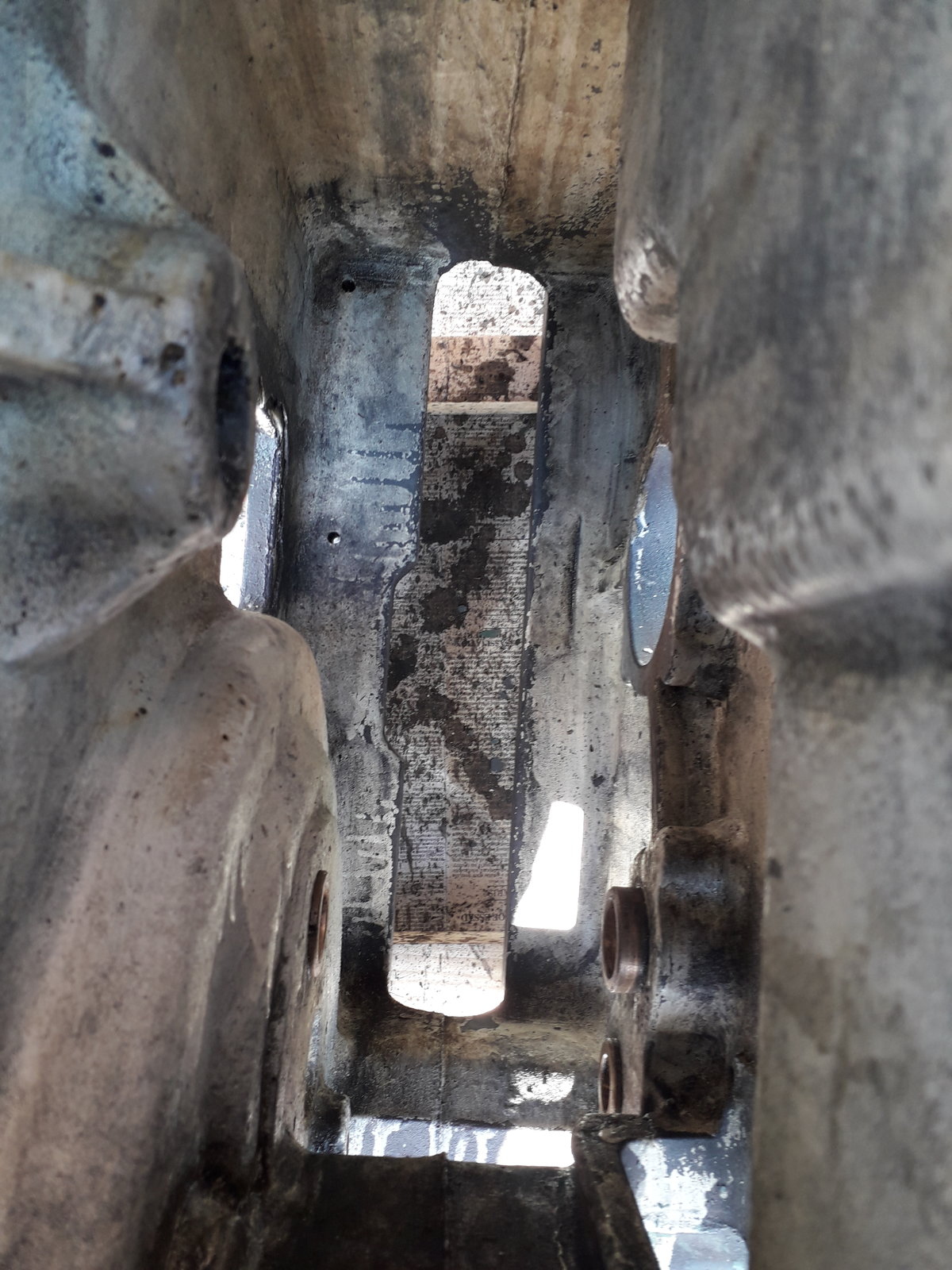

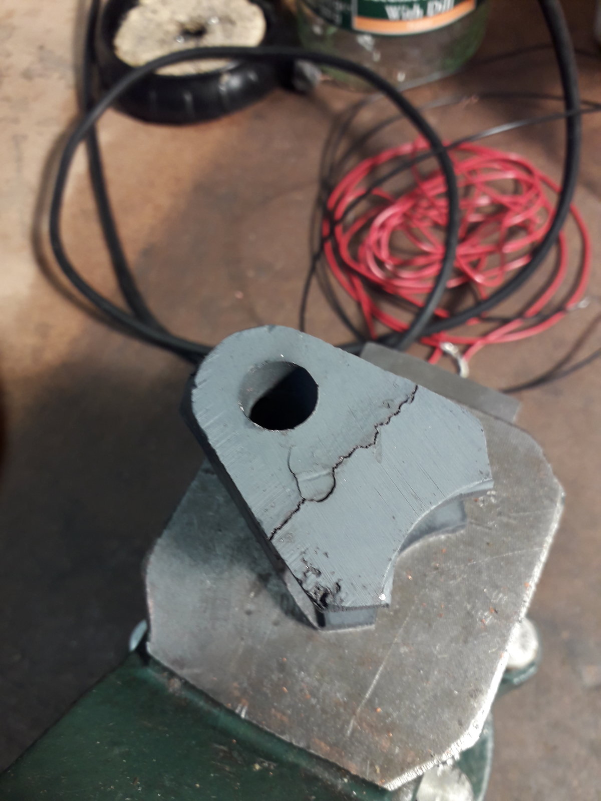

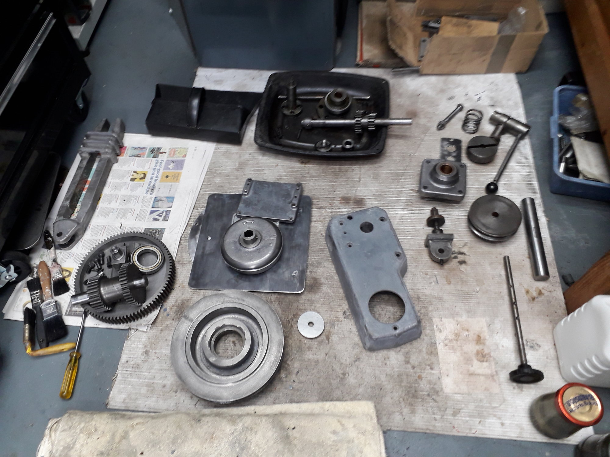

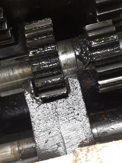

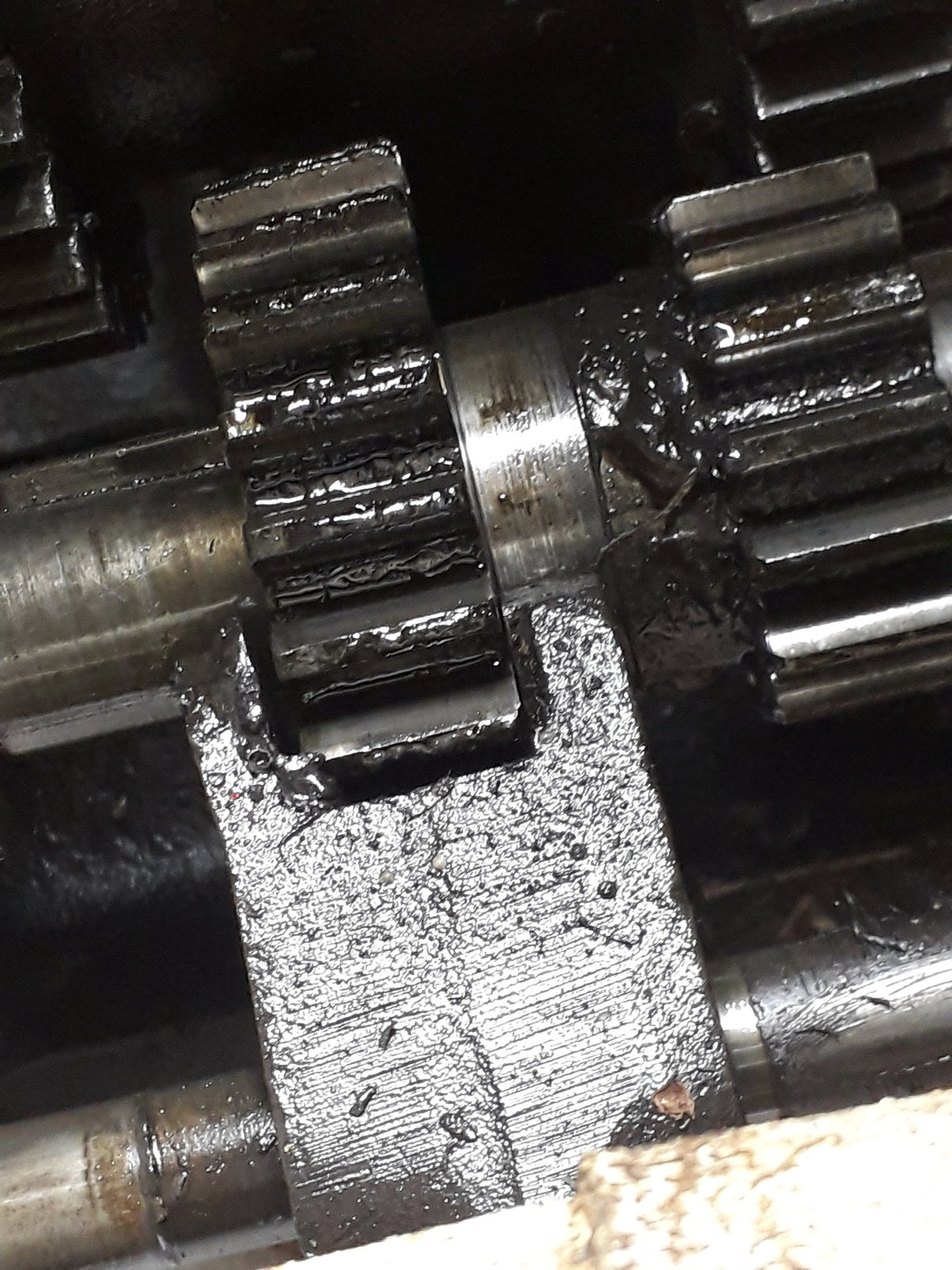

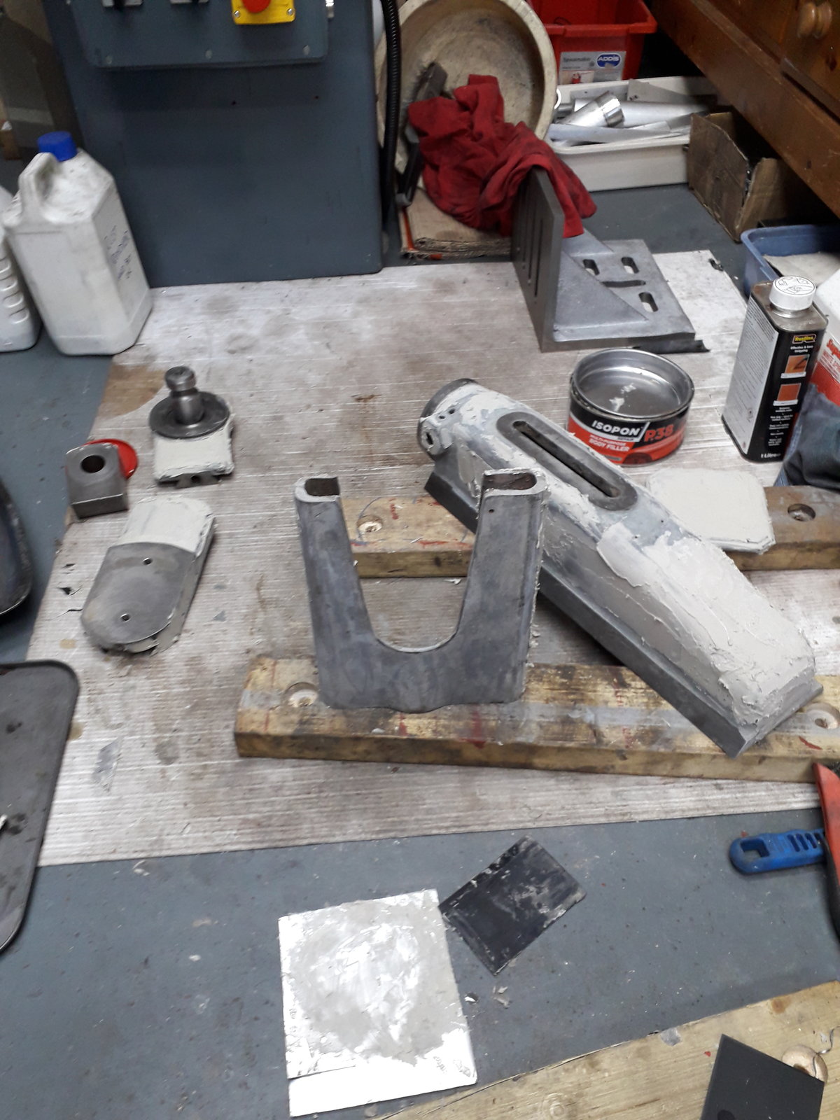

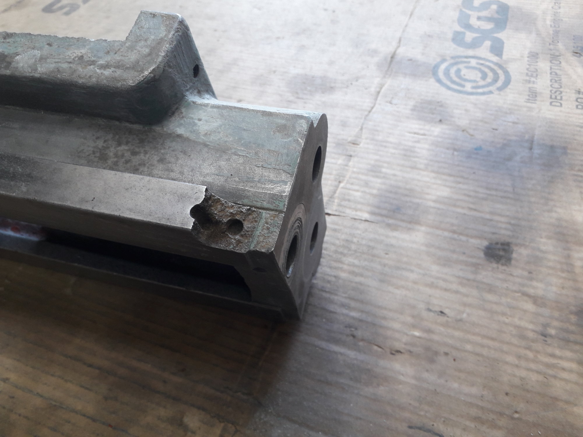

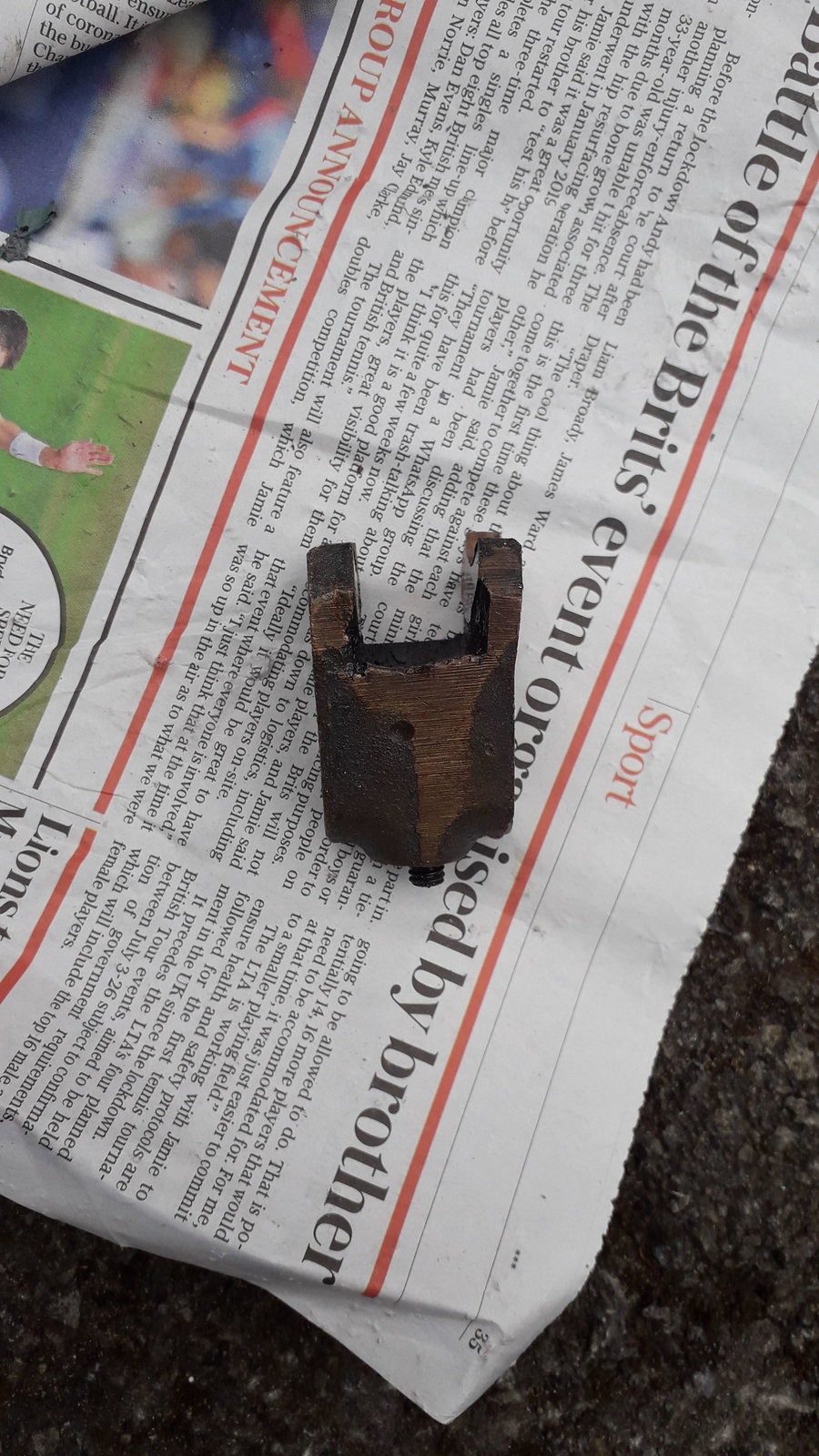

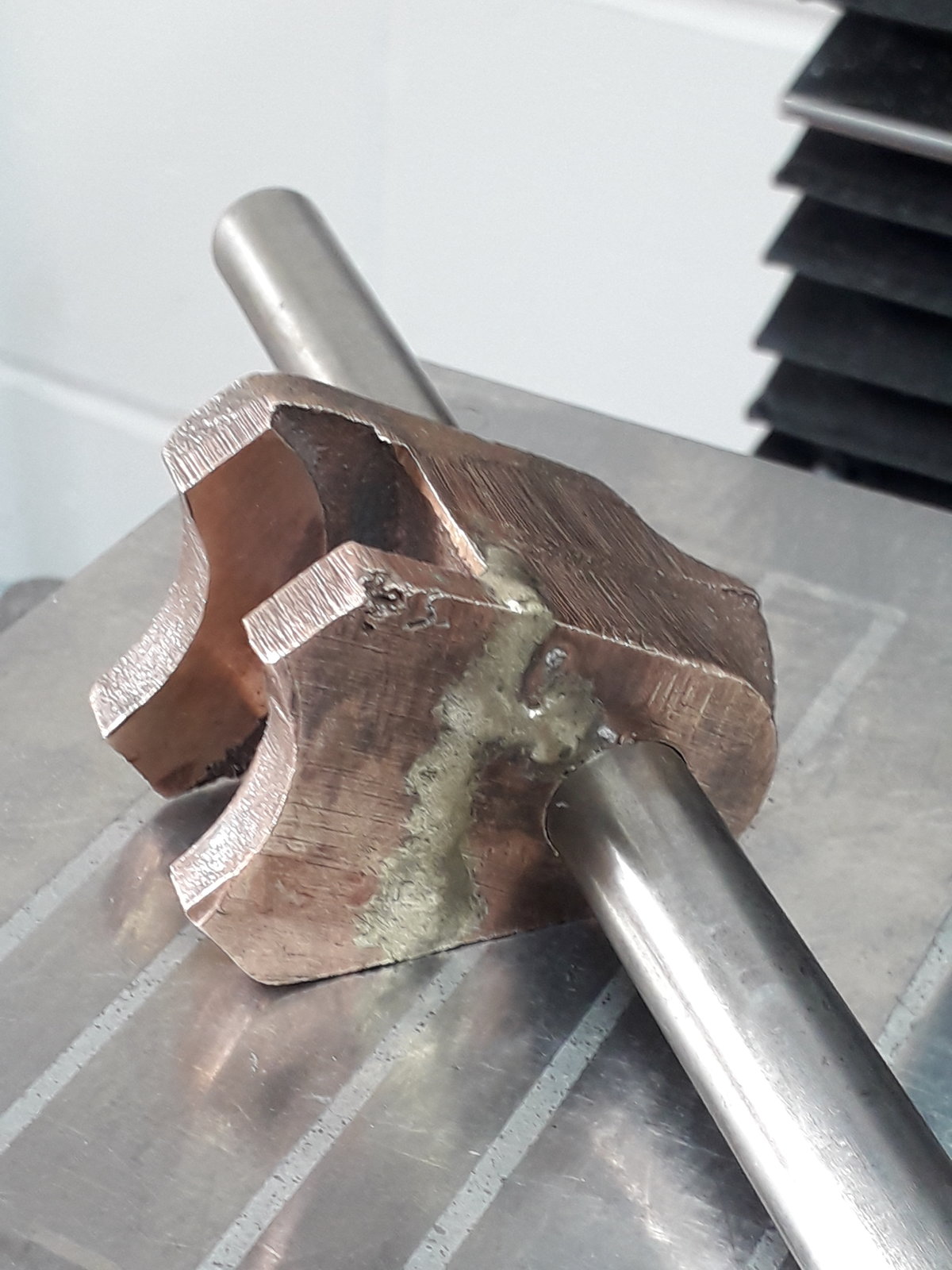

. Well, at least I didn't break it trying to get it apart. Trying to get this apart led me to discover a couple of things that'll need attention. 1) the gear pair that slides side to side is too tight over the keyway so excessive force is needed to change gear, and 2) the excessive force in the past has bent one of the "wings" of the fork:
