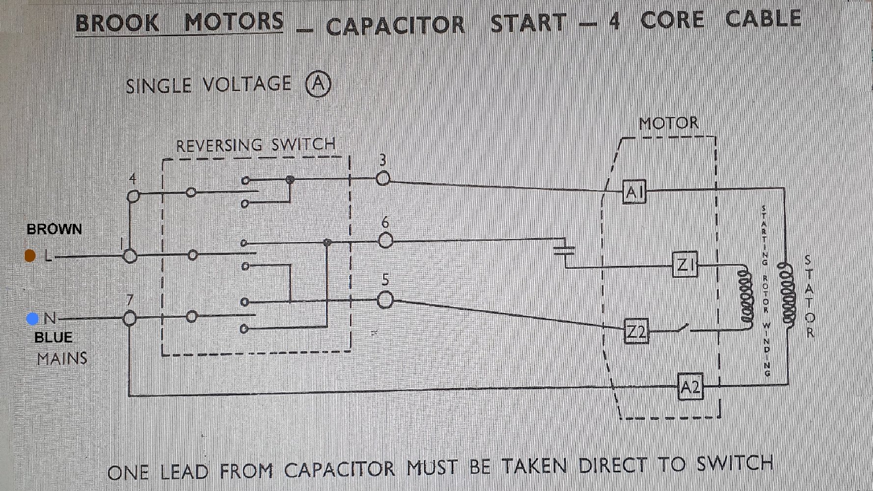

are you taking the p** or not reading the question correctly ? we have followed all the numbers on drawing... But at the bottom of the drawing it says .. one lead from capacitor must be taken direct to switch.. .............. it dont say what number on switch to attach the wire and dont say what wire from capacitor...Just follow tge numbers on the drawing, assumin thatcyou are using tge original Krater switch.
.. and this was already answered in the other thread.are you taking the p** or not reading the question correctly ? we have followed all the numbers on drawing... But at the bottom of the drawing it says .. one lead from capacitor must be taken direct to switch.. .............. it dont say what number on switch to attach the wire and dont say what wire from capacitor...
If you look at the drawing it shows you. I'll leave it at thatare you taking the p** or not reading the question correctly ? we have followed all the numbers on drawing... But at the bottom of the drawing it says .. one lead from capacitor must be taken direct to switch.. .............. it dont say what number on switch to attach the wire and dont say what wire from capacitor...
A1 to No. 3 : correcton this diagram all wires connect as per the diagram.. but at the bottom is says... one lead from capcitor must taken direct to switch ? what lead does it mean > where on capacitor and where to on the switch.... when wired like it shows on diagram it just buzzes..... i put A1 TO NUMBER 3 ........... Z1 to number 6,.......... Z2 to number 5 .....A1 to number 7... all i get is the motor buzzing. i have no clue as t owhat it means by a wire direct to switch from capacitor. its this last wire i cannot understand where from and to ?
...it is the symbol to the right of the centre, with two short horizontal lines separated by a gap..
