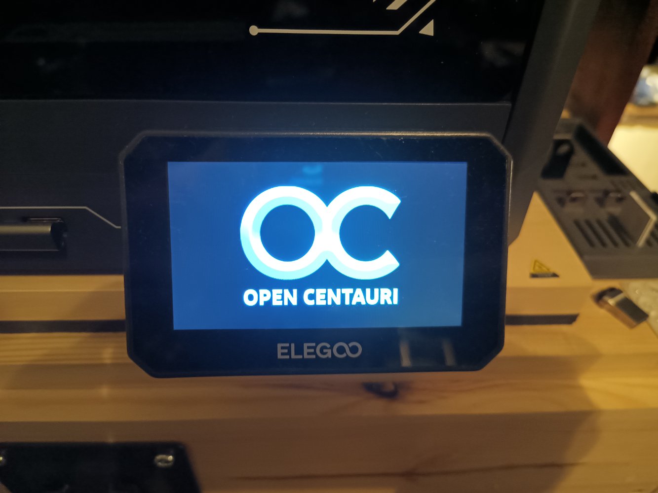

It was. Run a little executable on the pc in order to enable developer mode on the printer, pop an update folder with the update.swu file in it on a usb stick, pop that in the printer & update the firmware from the touchscreen.
The boot logo, you can ssh into the printer, after update, & select from one of several. There's also some updated start/end gcode to go in the slicer, if one chooses. Minor changes, but I've used their code.
