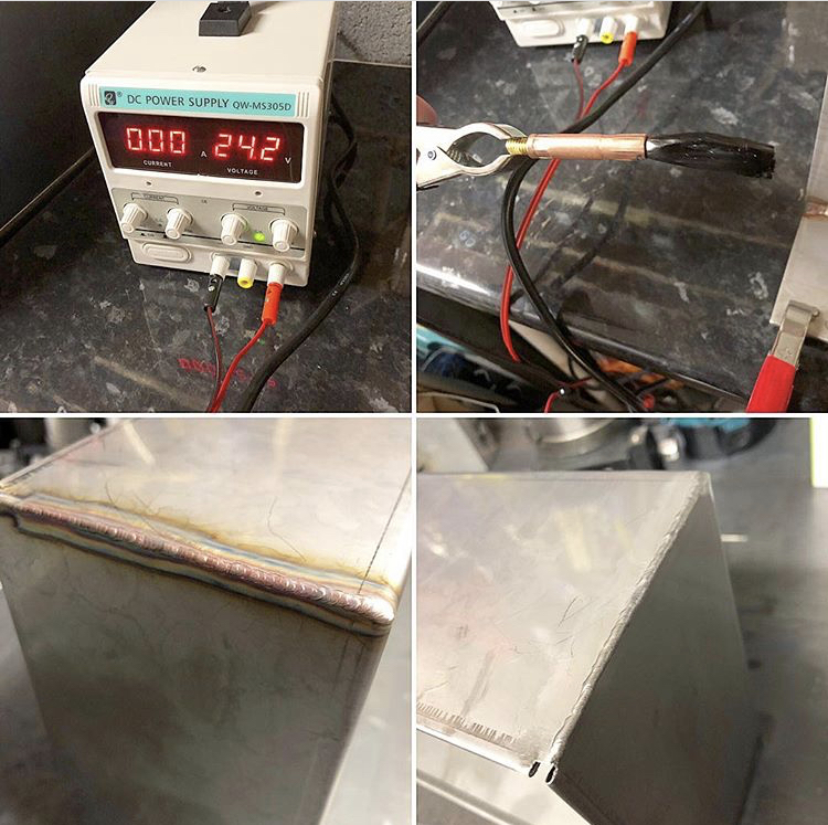

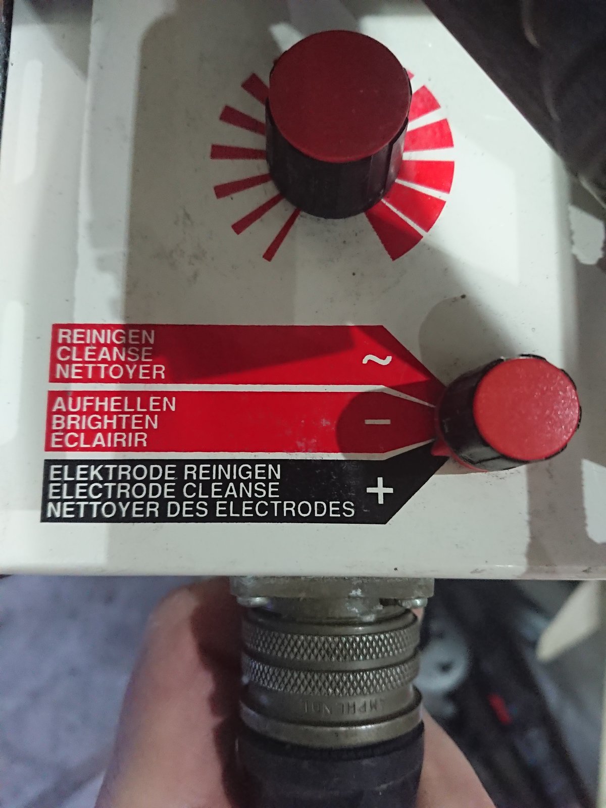

For £36 you can’t go wrong!
I will definitely tidy it all up, I’ll put a nut on the thread of the rig brush and shape the clip to get the most secure connection and then put some fine on it.
The lead is a good 2 meters long so I like having the positive and negative just slit at the end as keeps it tidy. I’m also not sure how well it would work if the earth was really far away from where it was being cleaned.
