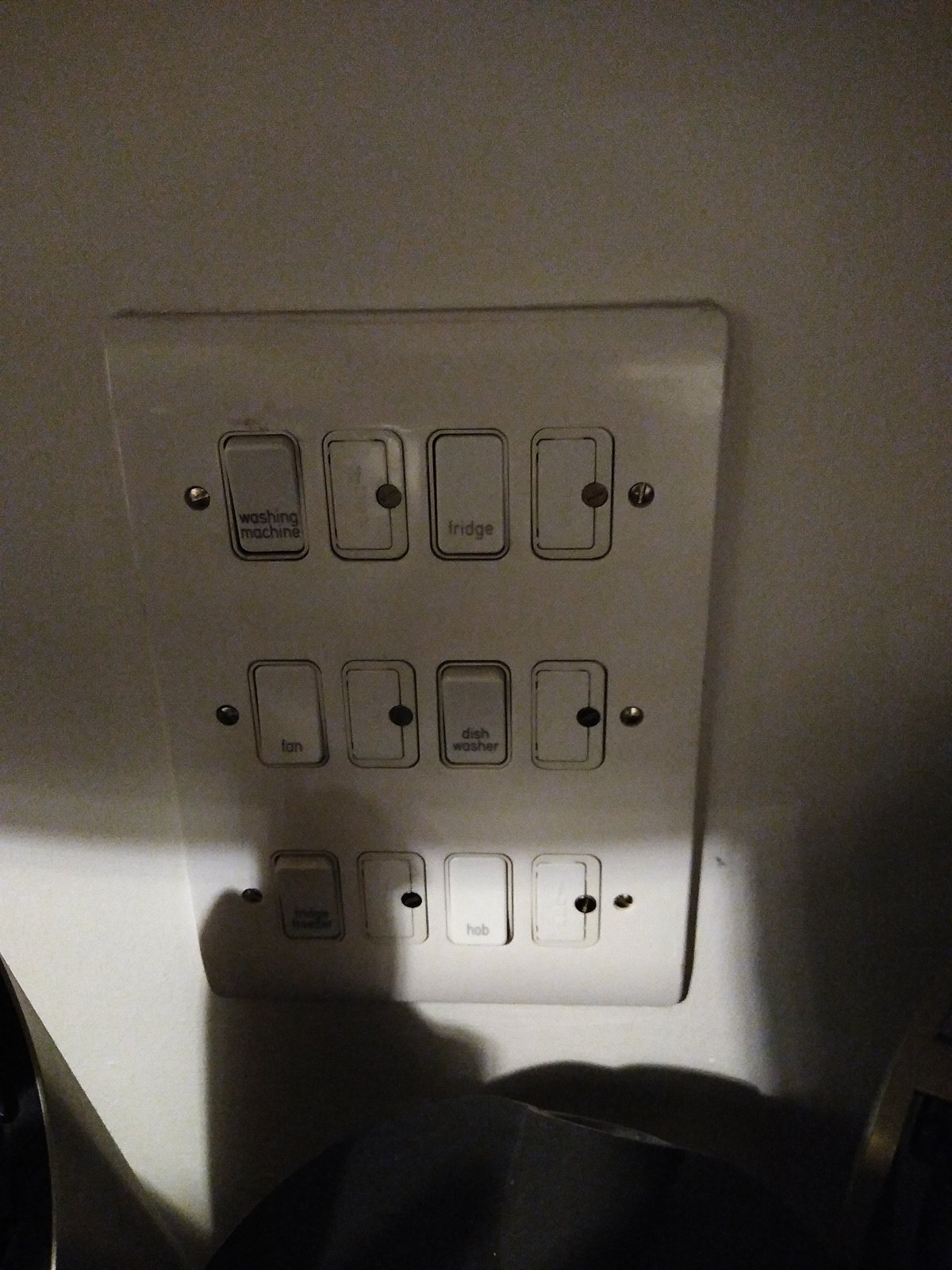

    Did most of mine myself (except kitchen) ...then got mate of mate in to install CU and do signoff. He did the kitchen but only because I wanted to push the job forwards....I have to say he did a great job in the kitchen with individual panel for the appliances (I would never have thought of that)
    It's not rocket science but you have to know the basics. It's funny because what I pulled out was really shocking!

    god those grid switches are a dead loss to wire and replace. I never use them. I just fit sockets for appliances in adjacent cupboards for isolation

    Planning is funny...change the wiring in a kitchen and you have to notify the council?
    Build a new house in your back garden without telling the council...then 4 years later apply for retrospective planning and bingo it's all legal!
    Kitchen switchboard came in very handy when the washing machine motor developed a fault....just switched it off at the board. Same happened with the built in fridge too...at 11pm...isolated till morning.

    no different or harder than unplugging them in adjacent cupboards then :)

    Well you say that...except you have to know which cupboard...and then you have to empty the cupboard of stuff.
    My cooker isolation is at the back of a cupboard...after it was installed the kitchen "lemans" unit went in...that's fun to get to...with a bad back!

    sorry but i prefer isolation switched fuse above the worktop much better and with things nowadays you can have name plates for each plugged in unit
    dont need a cupboard or a switched box unit for it either
    faster to turn off in an emergency and you can isolate it while working on it
