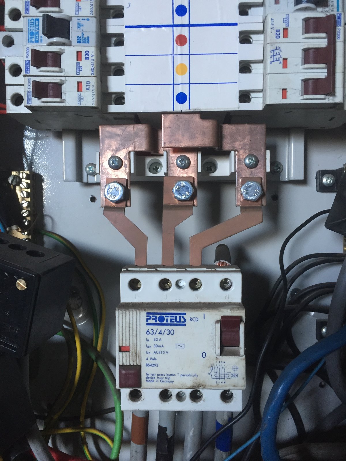

just to verify all 3 phases are correct turn everything on and just pick the bottom right hand 3 phase breaker and test the terminals across all 3 . you should get 415 volt across any combination of test if all is as should be work your way out from the minature breaker feeding the down circuit
