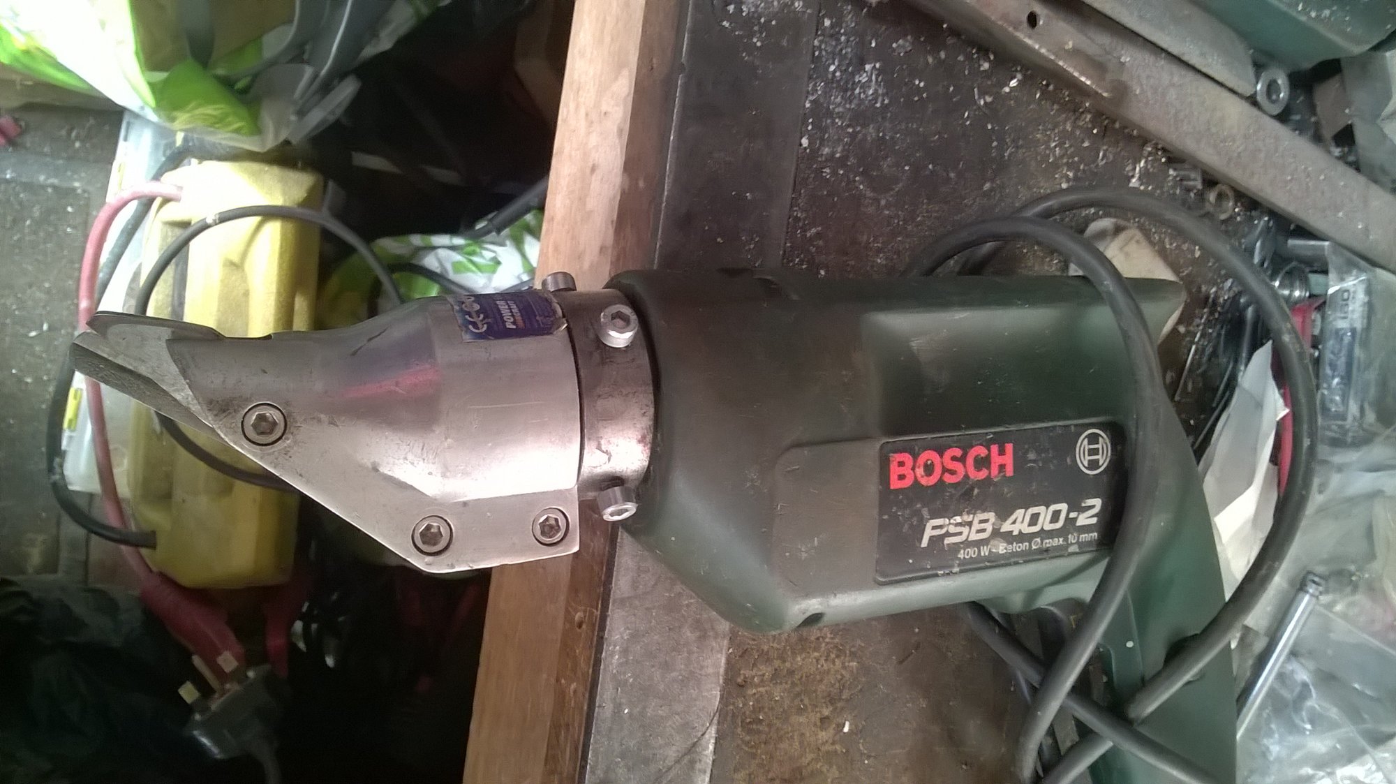

I am after a cheap electric sheet metal cutter and came across these https://www.amazon.com/slp/electric-metal-shear/rsnbdfc7d58o9x7 They are just what I'm after. I have air cutters like these and find them easy to use and quite accurate.
I cant find any like them in the UK. Are they a new kind of tool, so only available in the US so far or am I looking in the wrong place (or more likely using the wrong UK name).

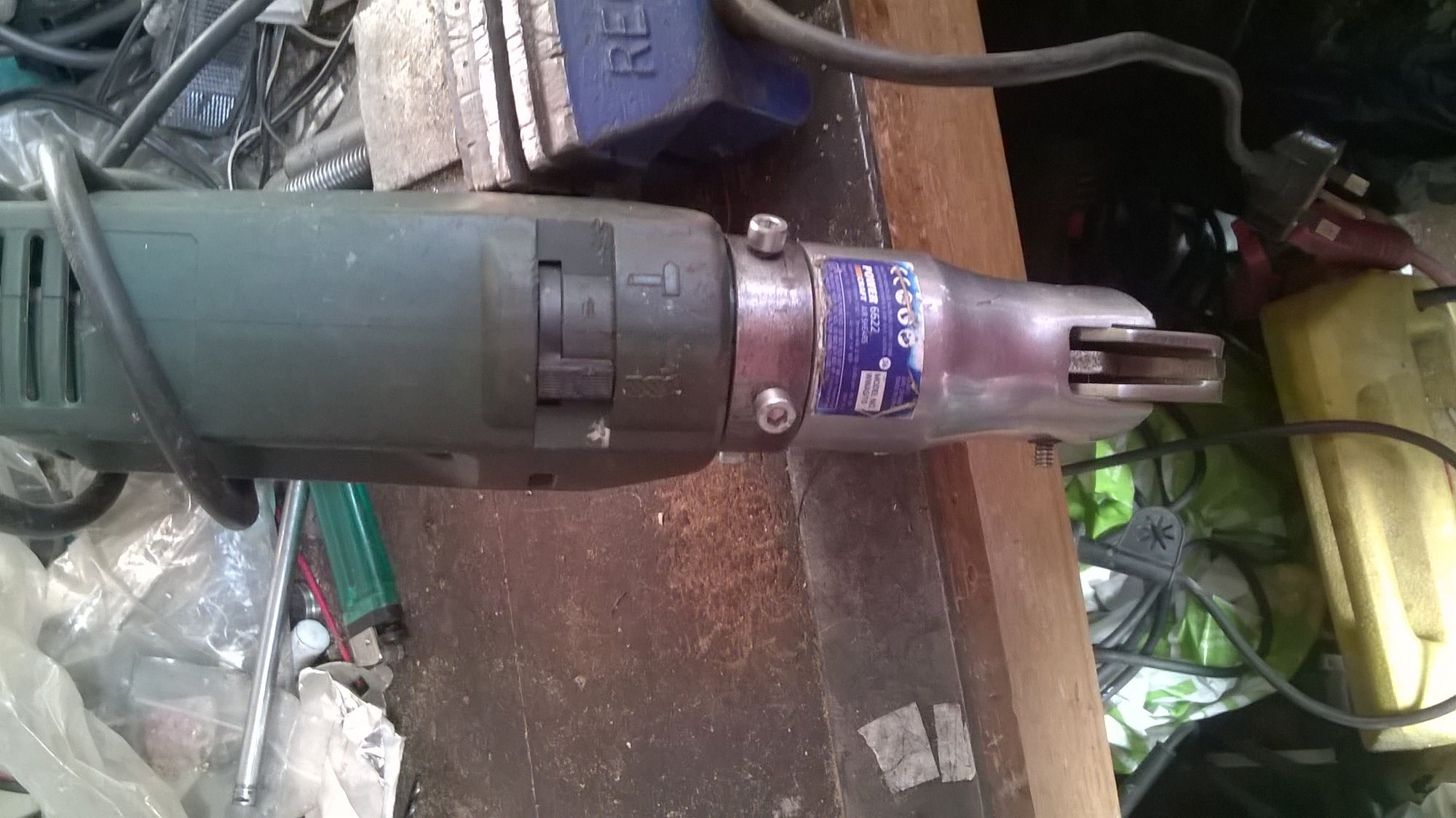

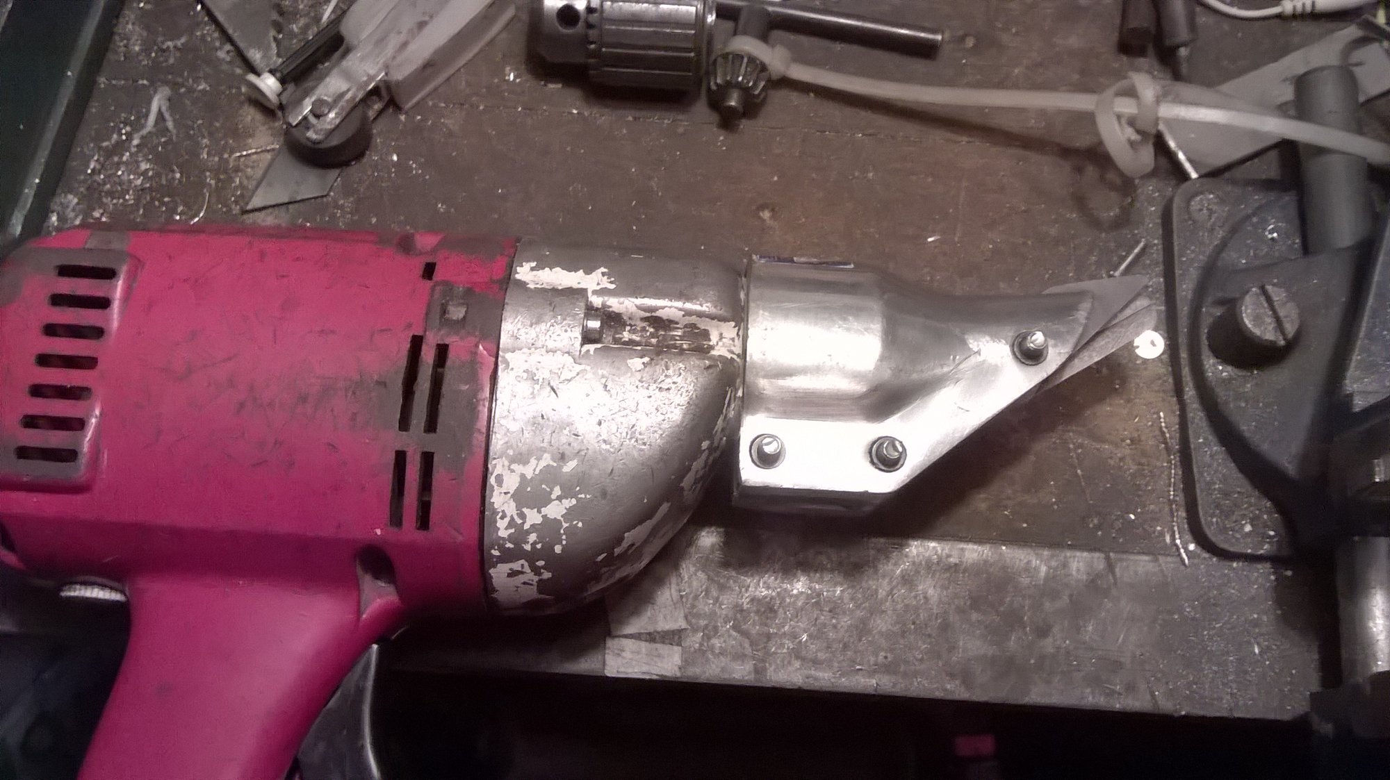

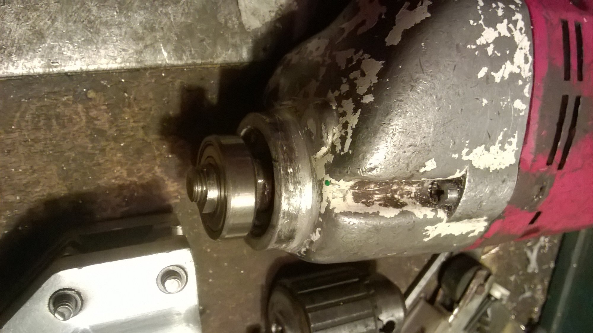

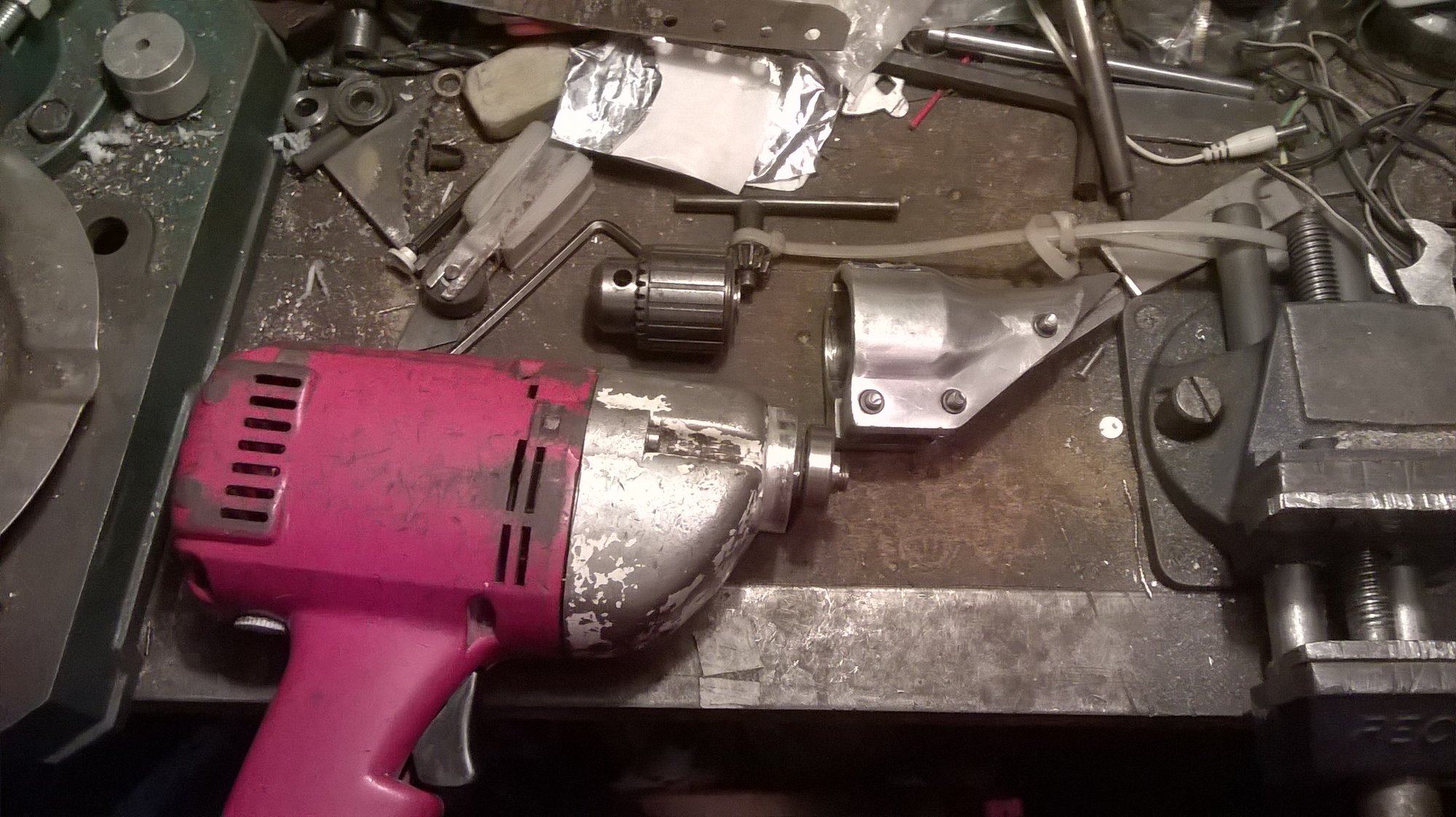

) first pic
) 2) the slower speed that these drill run at is much more suited to this 3) Using the air version takes a lot of air/big compressor ! 4) It's a lot cheaper than the bought version to the point that if you have need of one and an old drill then buy an air version, remove the head, do the mod and throw the air part away ! I know you can buy the head assembly on ebay but it's not far off the price of a complete air one when lidle or aldi have them in.
