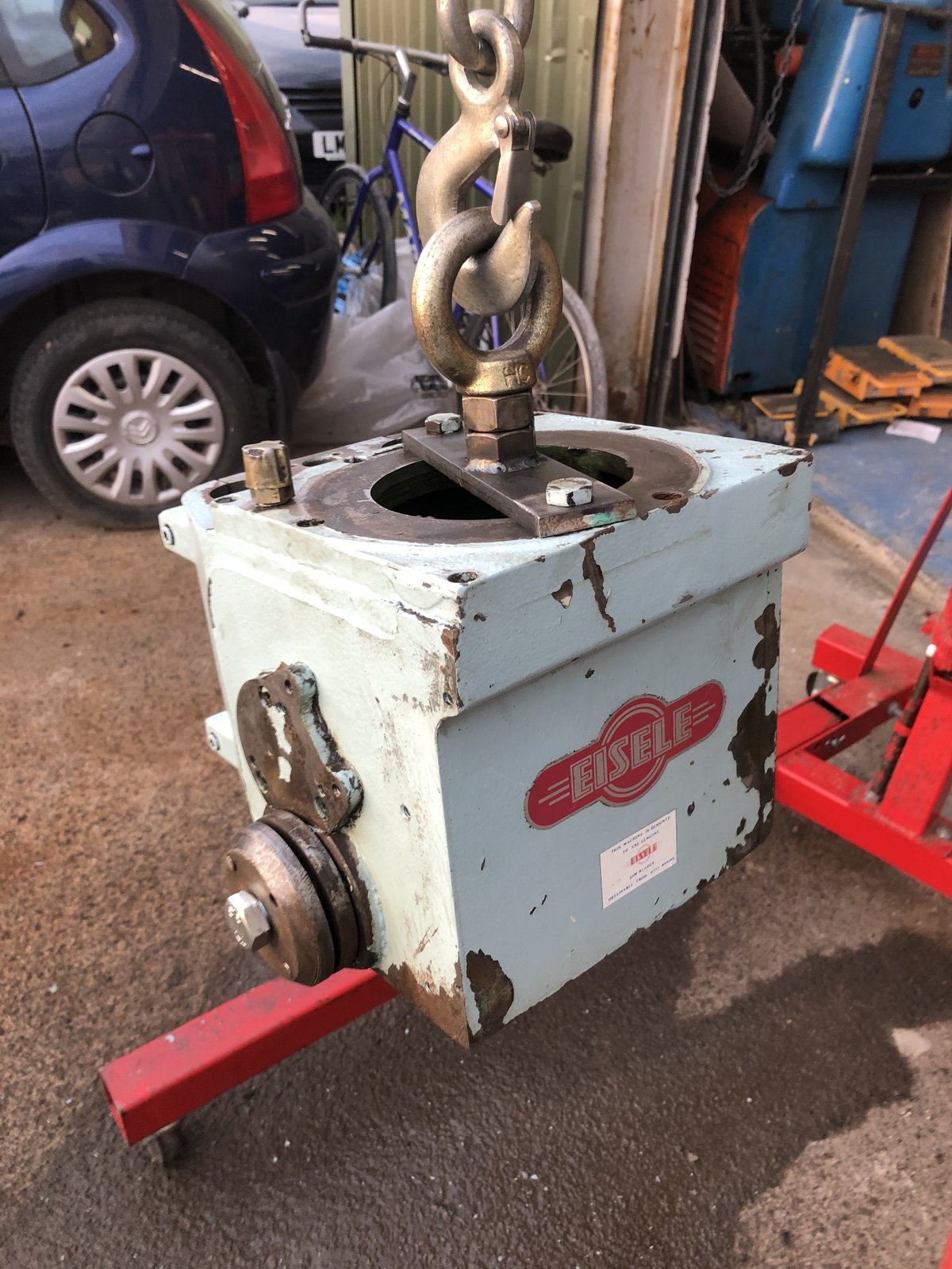

serious case of tool envy going on hear, i have a warco bandsaw but for what i do... almost all 25xx25 box -50x50 box that would be ideal! the iron worker takes care of all the soild bars stock but hmm i need to get facebooking!
my plan was to cut inch wide strips out of it and make parting blades for the lathe, never got round to it though.

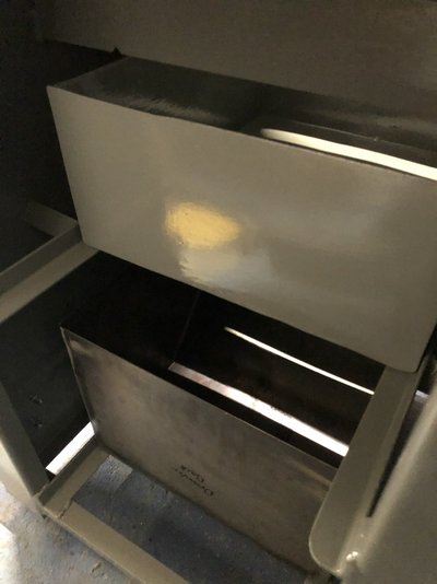

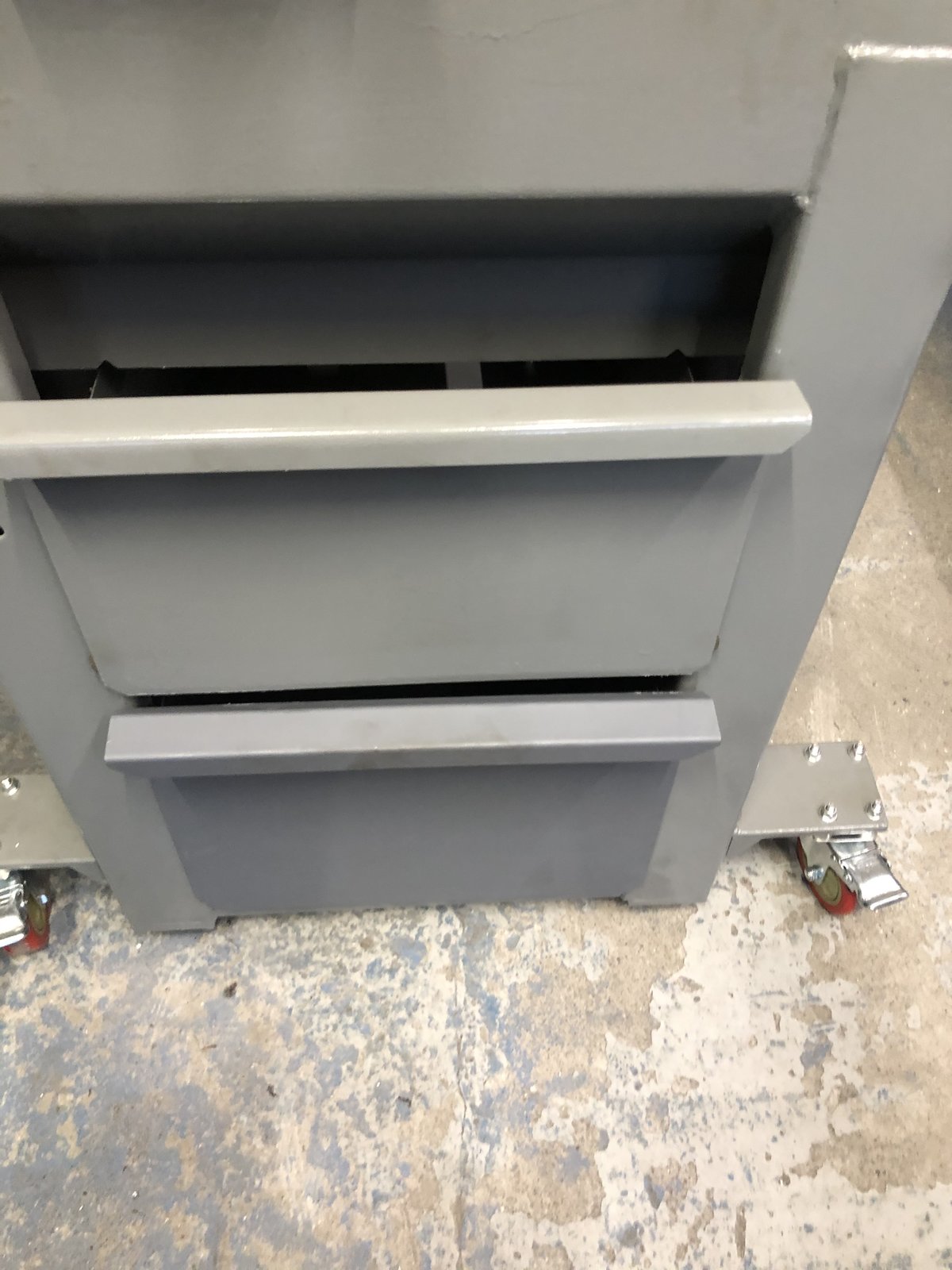

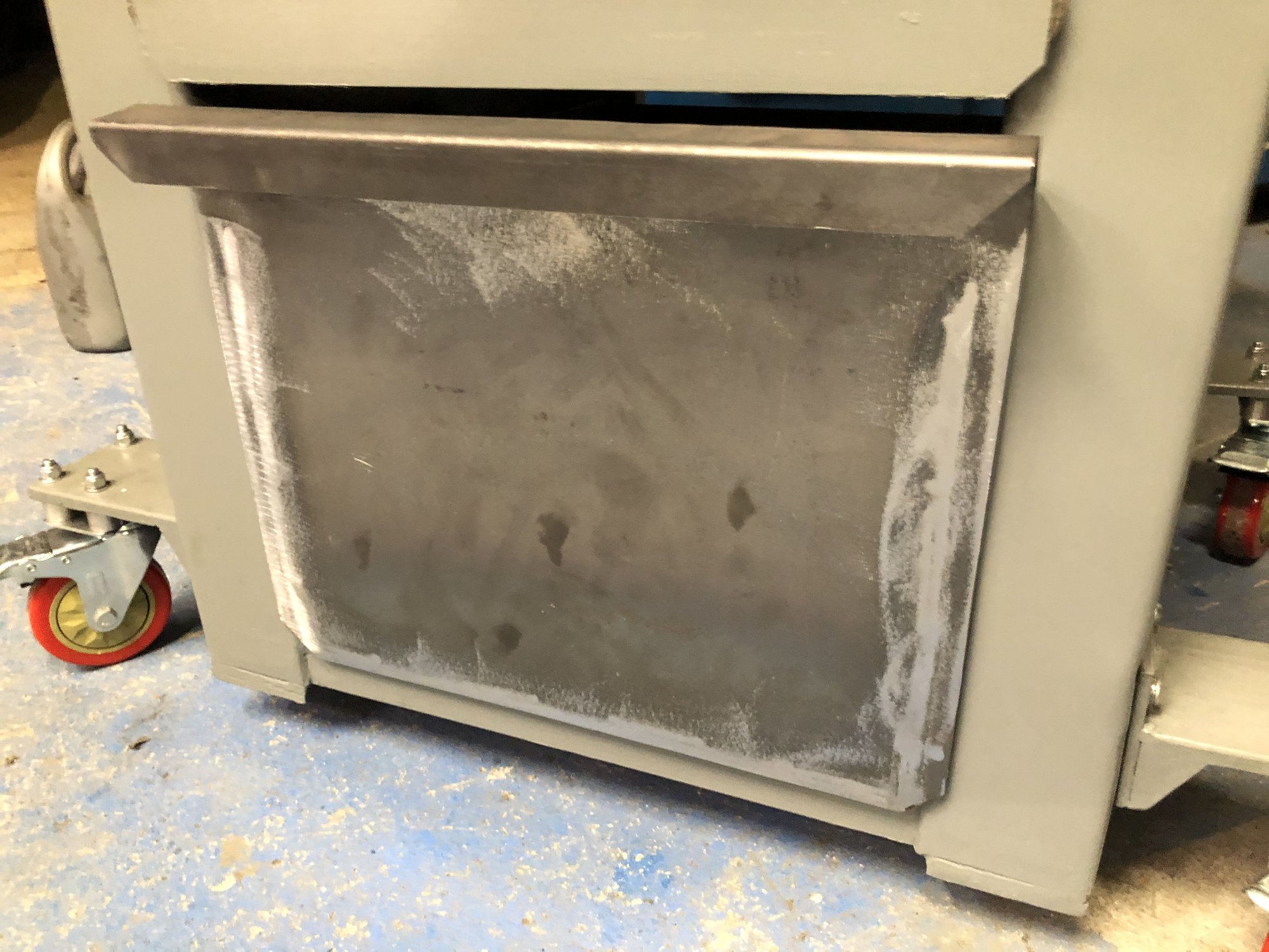

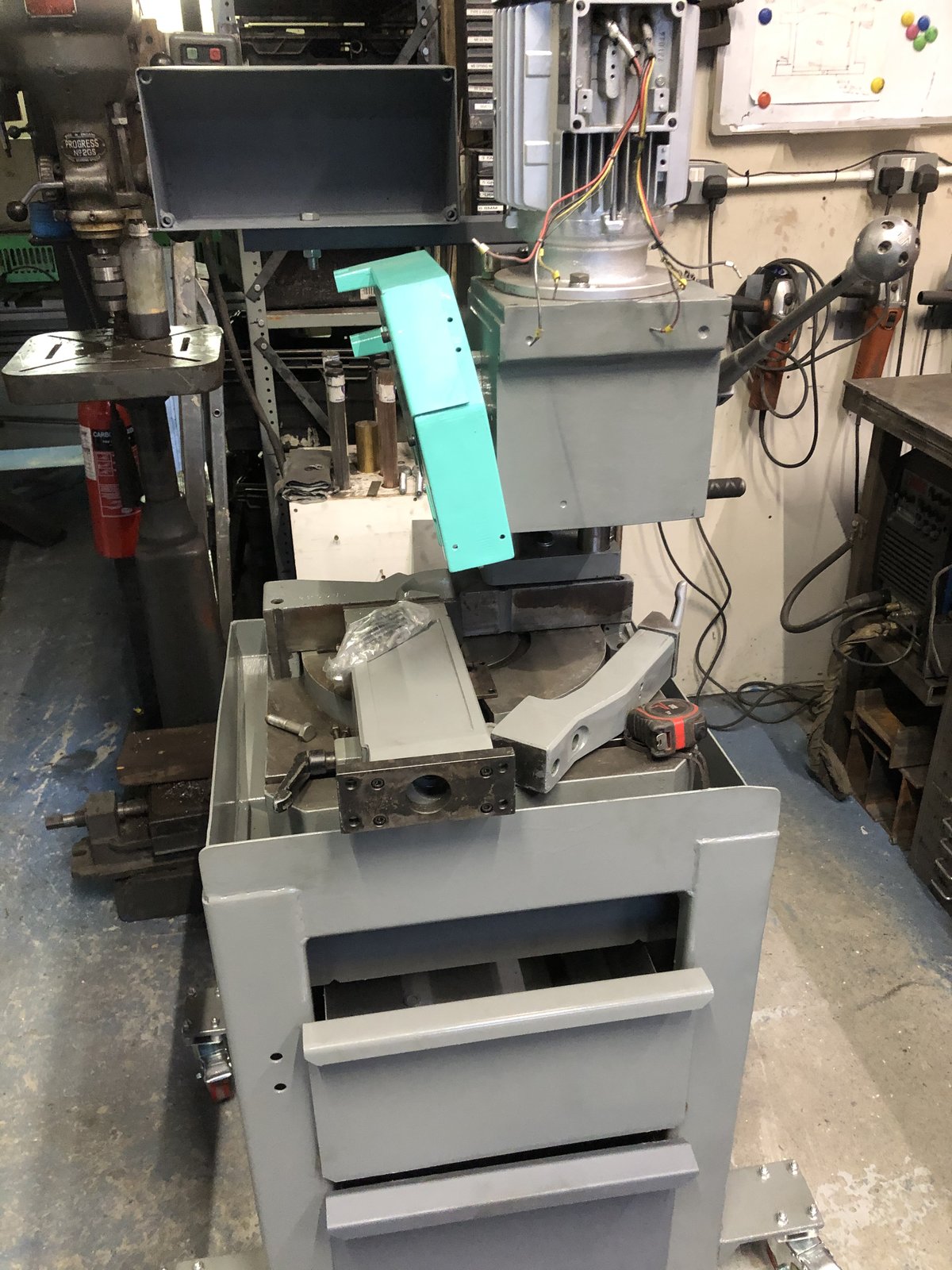

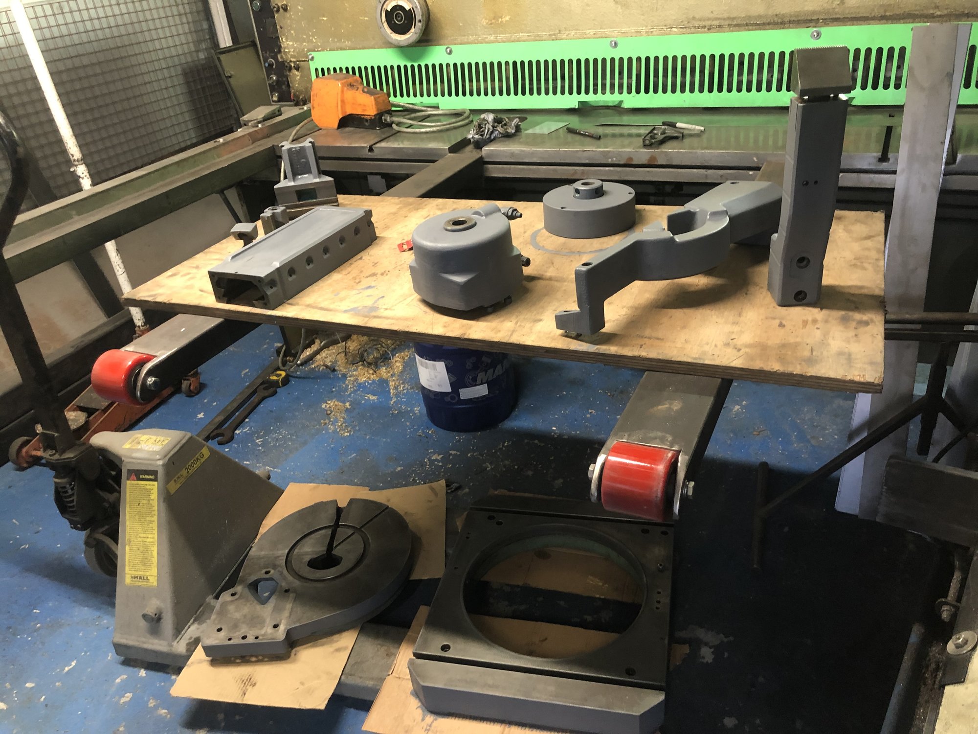

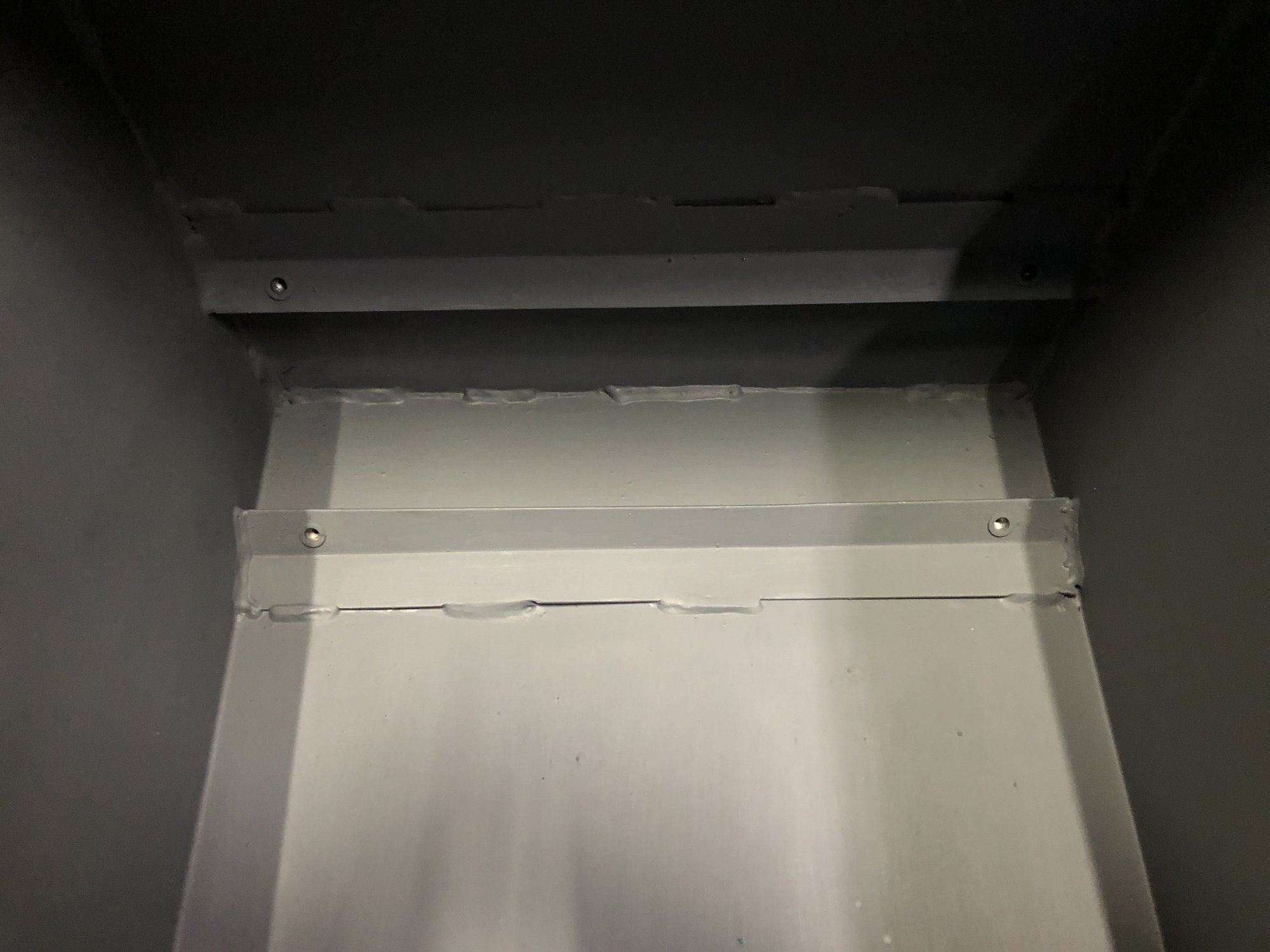

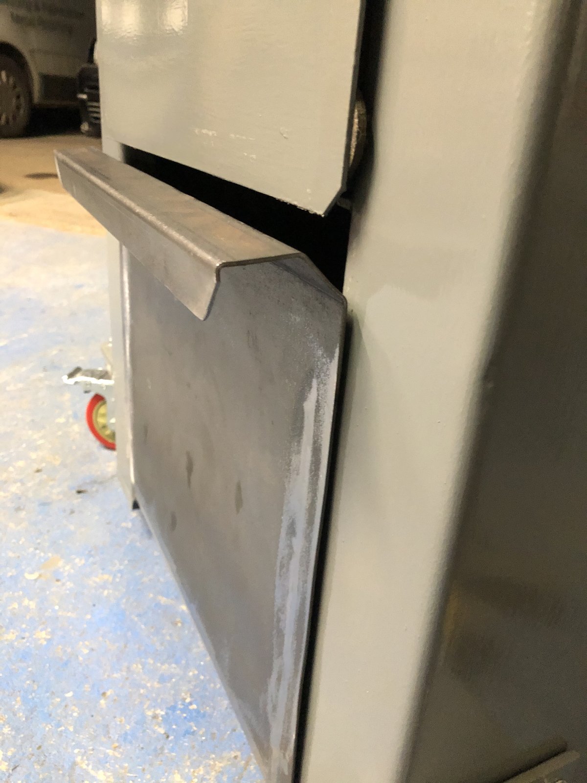

Really nice saw, got lots of skill making all of those bits and piecesHad the pressbrake and guillotine on for a job so made up the new coolant drawer, pump housing (I’ll use an external pump).
Couldn’t quite get the handle part of the drawer to match the top as I didn’t want to change the top tooling on the pressbrake so just added an extra bend

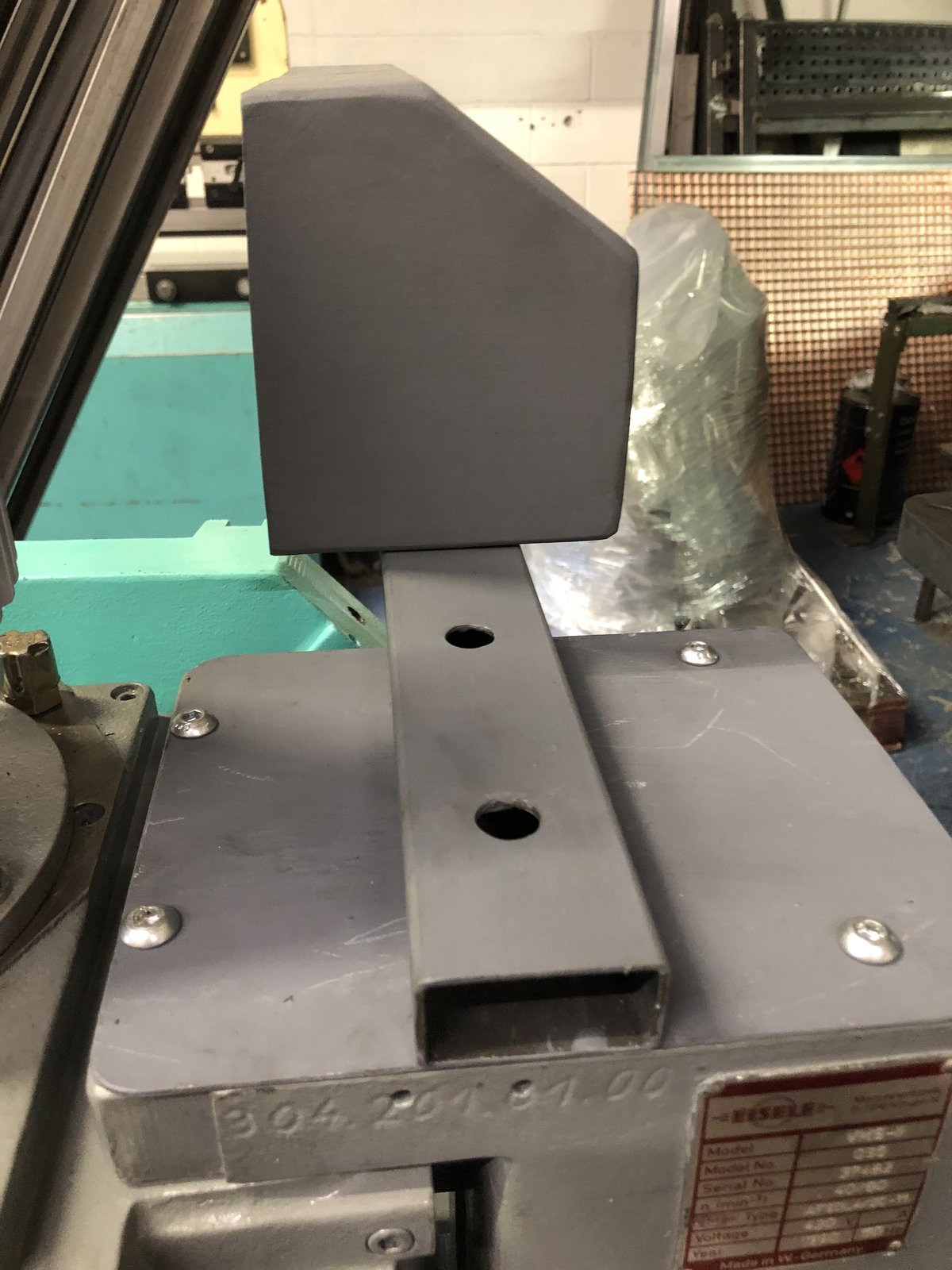

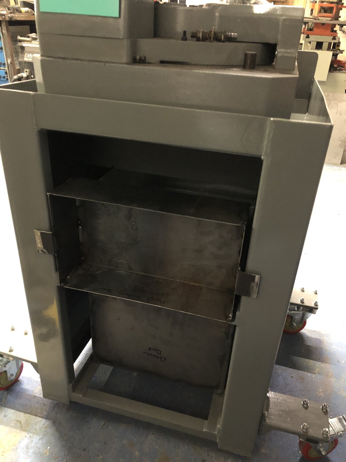

also the housing for the electrics which will pivot on a piece of box section bolted to the saw top.

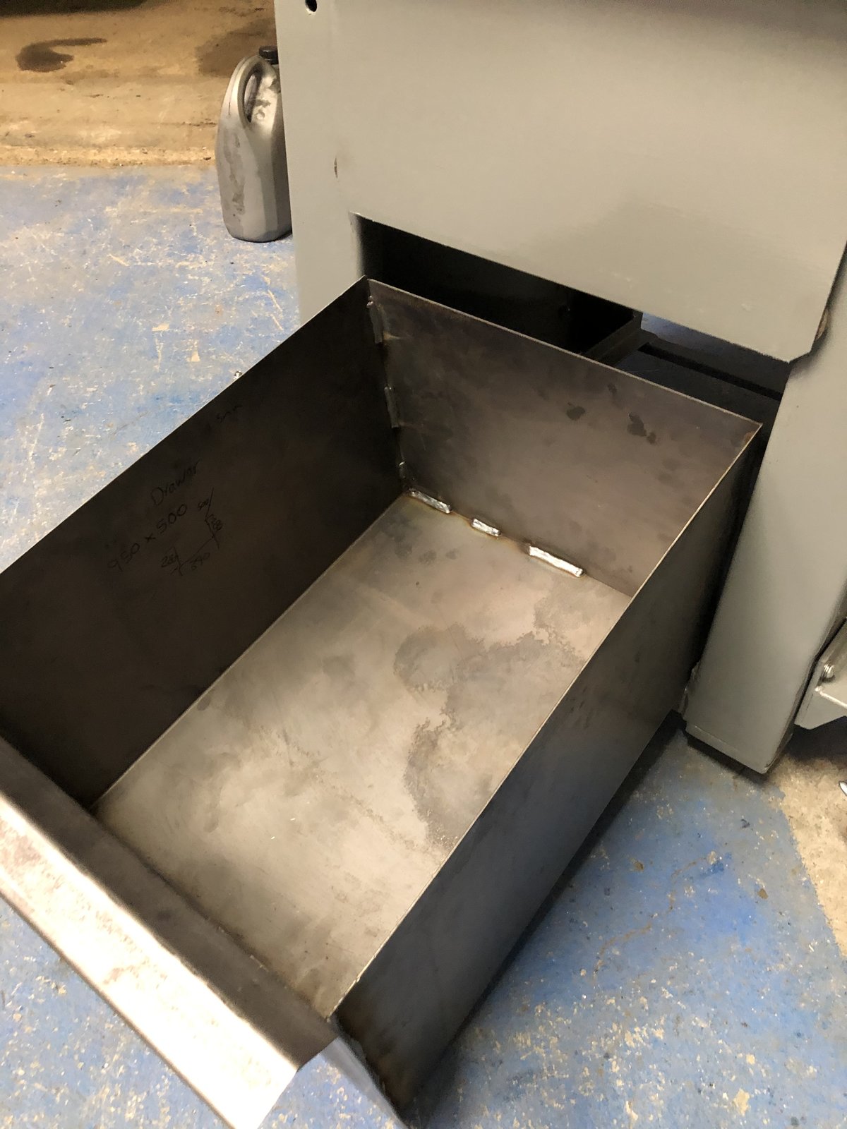

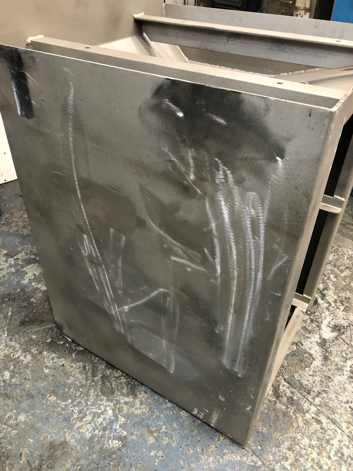

Think I’ve made the drawer a bit big! Calculated it and it could hold around 50ltrs! Don’t have to fully fill it anyway. Still got to finish fully welding all the seams and do some faceplates etc.

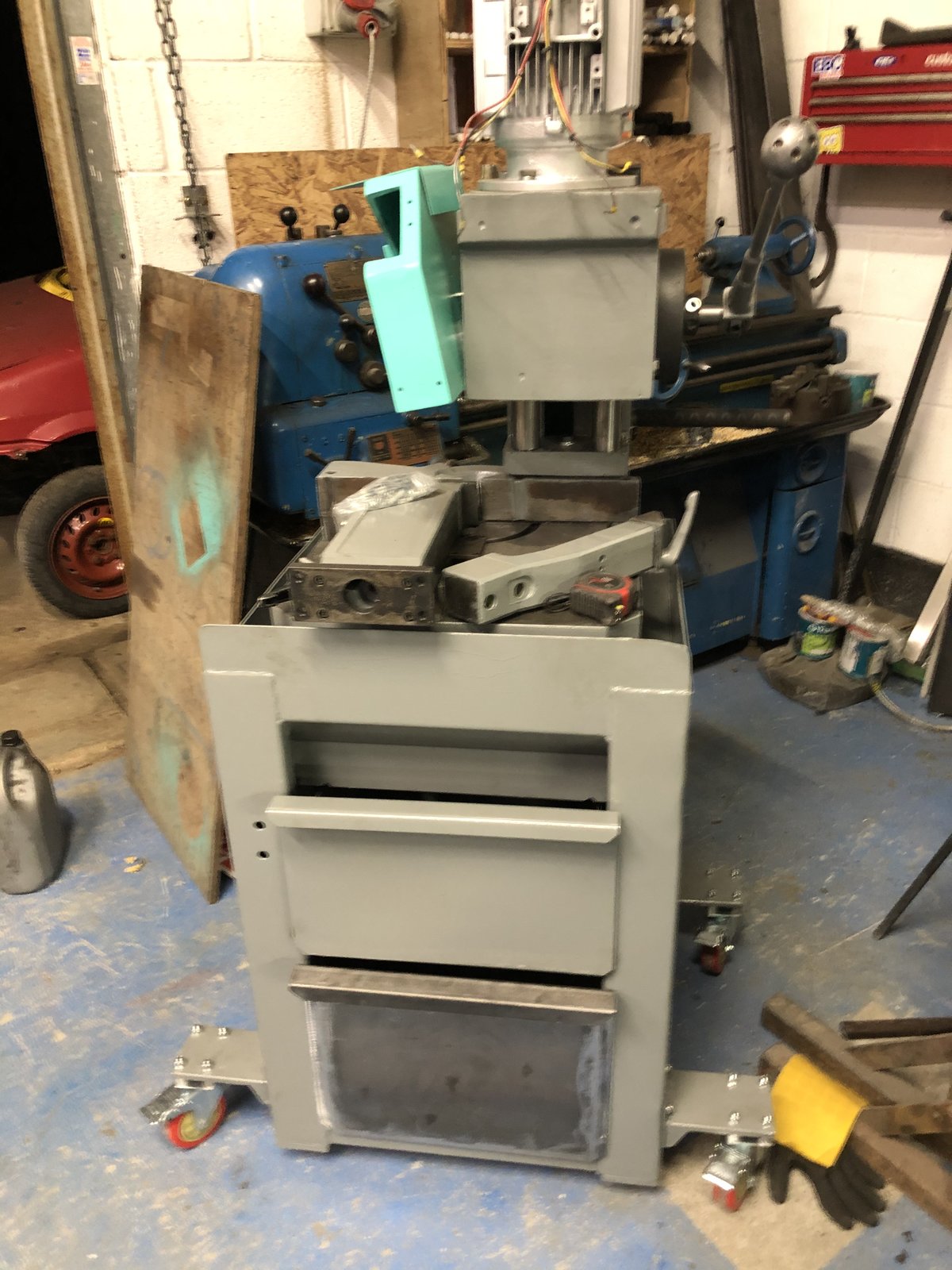

got to move this build forward quite rapidly as my bandsaw has broken so without a proper saw at present
this is how it currently sits some parts are just lightly bolts on
Looks really good again, are you making all new electrics for it or do you still have tge origonal? For the filter are you just having a 3mm screen ? As I would recommend having something finer aswell somewhere before your coolant gets back to the tank and pump, im only saying this as mine has a fine steel gause on top of the drainage hole on the saw. And because the chips seem to be a lot smaller than 3mm.Thanks. I’m pretty lucky to do this daily so I’ve got some various bits of kit that makes it nice and easy.

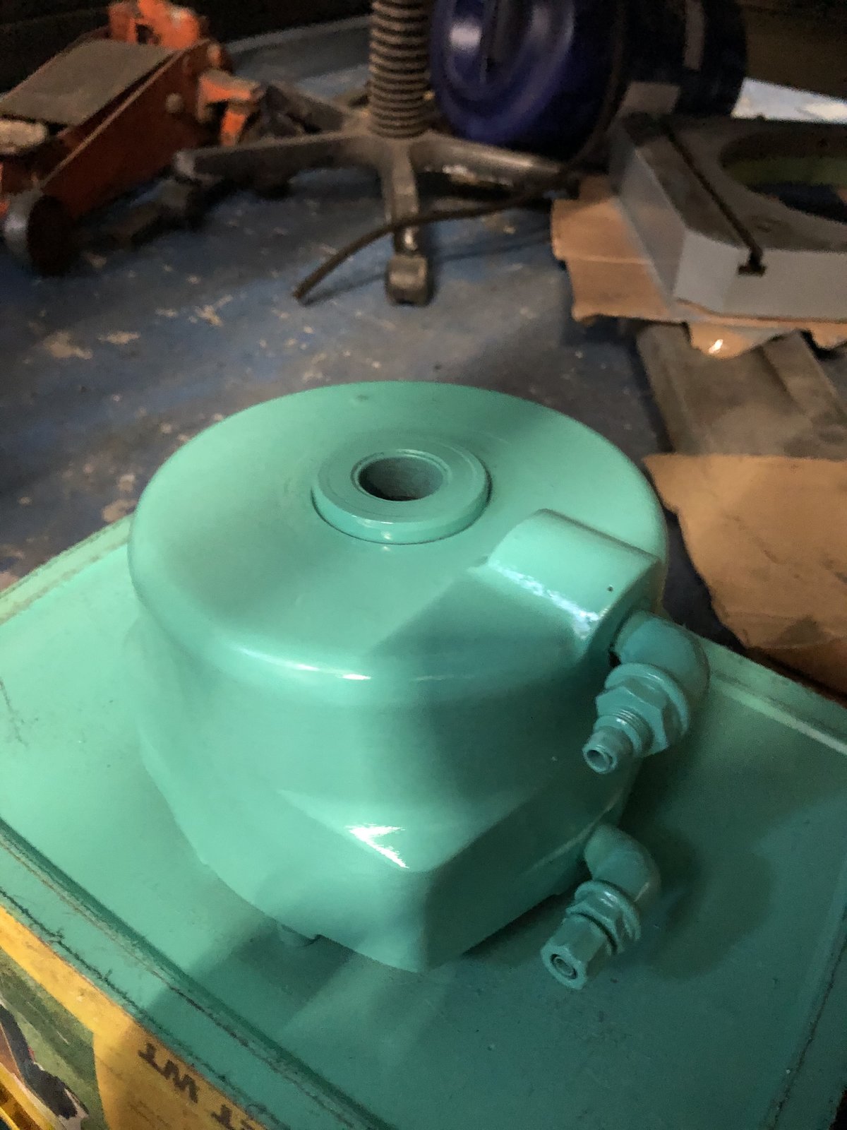

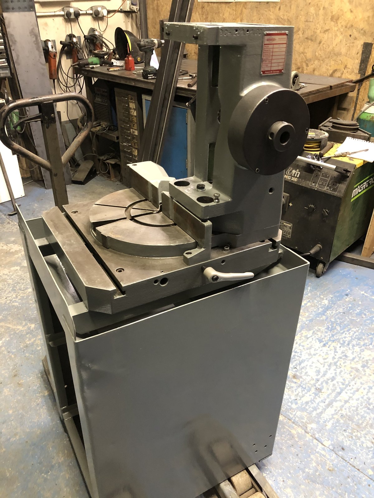

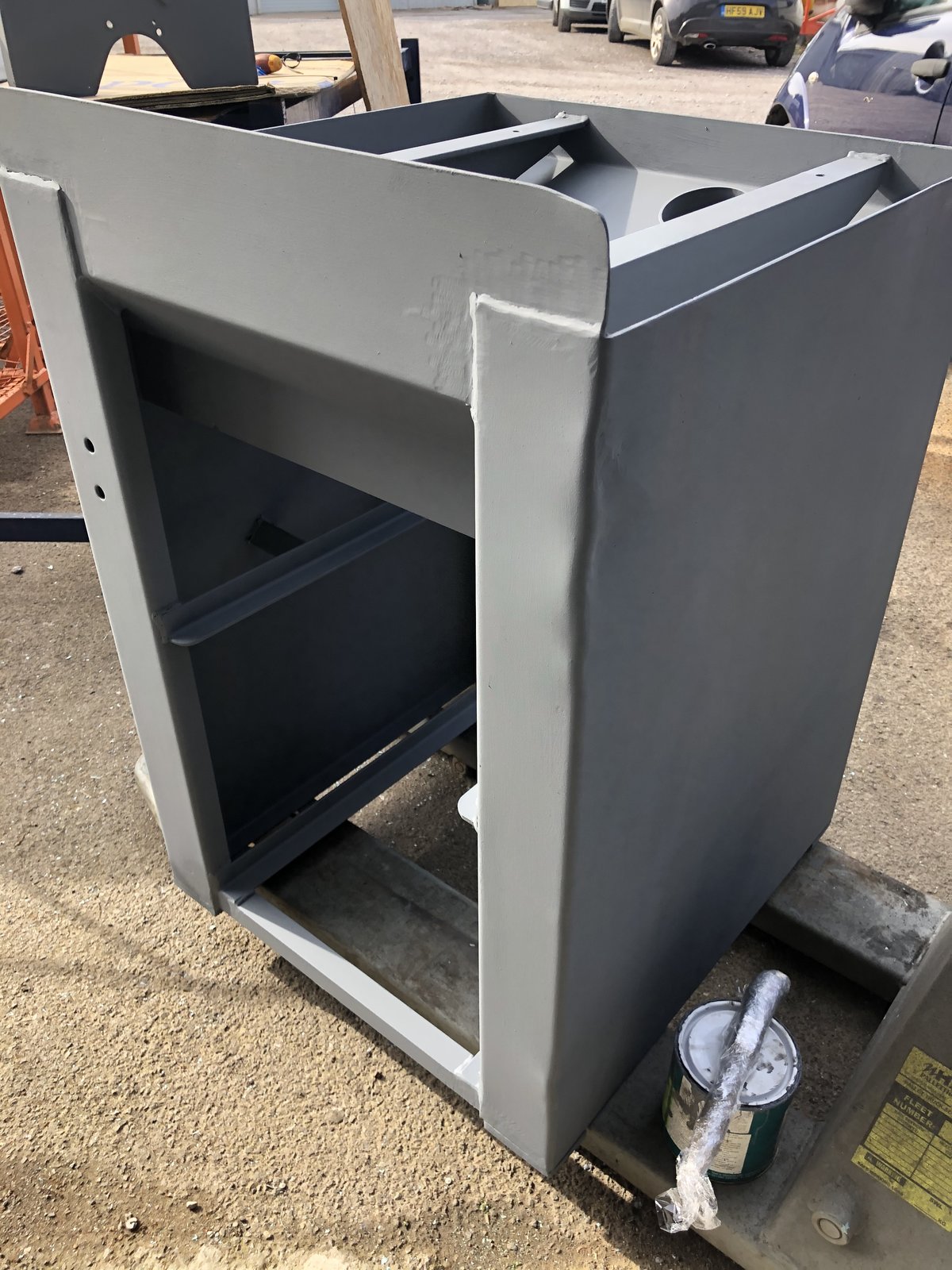

Got the various bits painted in primer they’ll stay like this for a bit whilst I cut holes for hoses and electrics etc. Mounted it up temporarily just so it’s out the way waiting for a couple of components to arrive from wds

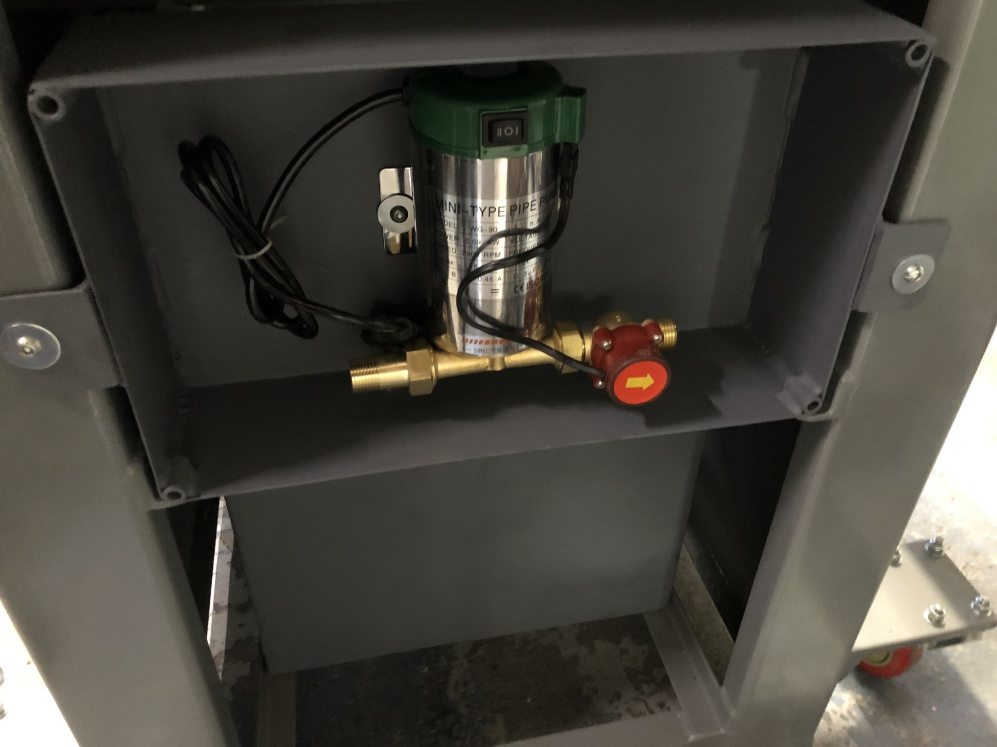

added this to the inside of the bottom drawer on top will bolt a stainless plate that has 3mm holes to act as a filter panel the feed to the pump will be below it.
Pump has arrived only a cheap Chinese one so will see what it does! Just got to cut a faceplate out which will bolt onto the front.
This is how the electric box will sit also done a plate to cover the saw top
ive also redone the mounting for the castors I’ve now made a very heavy duty dolly that the saw will sit in with some better and bigger castors just got to finish painting it. It has brought the saw higher shouldn’t be an issue.
..As I would recommend having something finer as well somewhere before your coolant gets back to the tank and pump...
