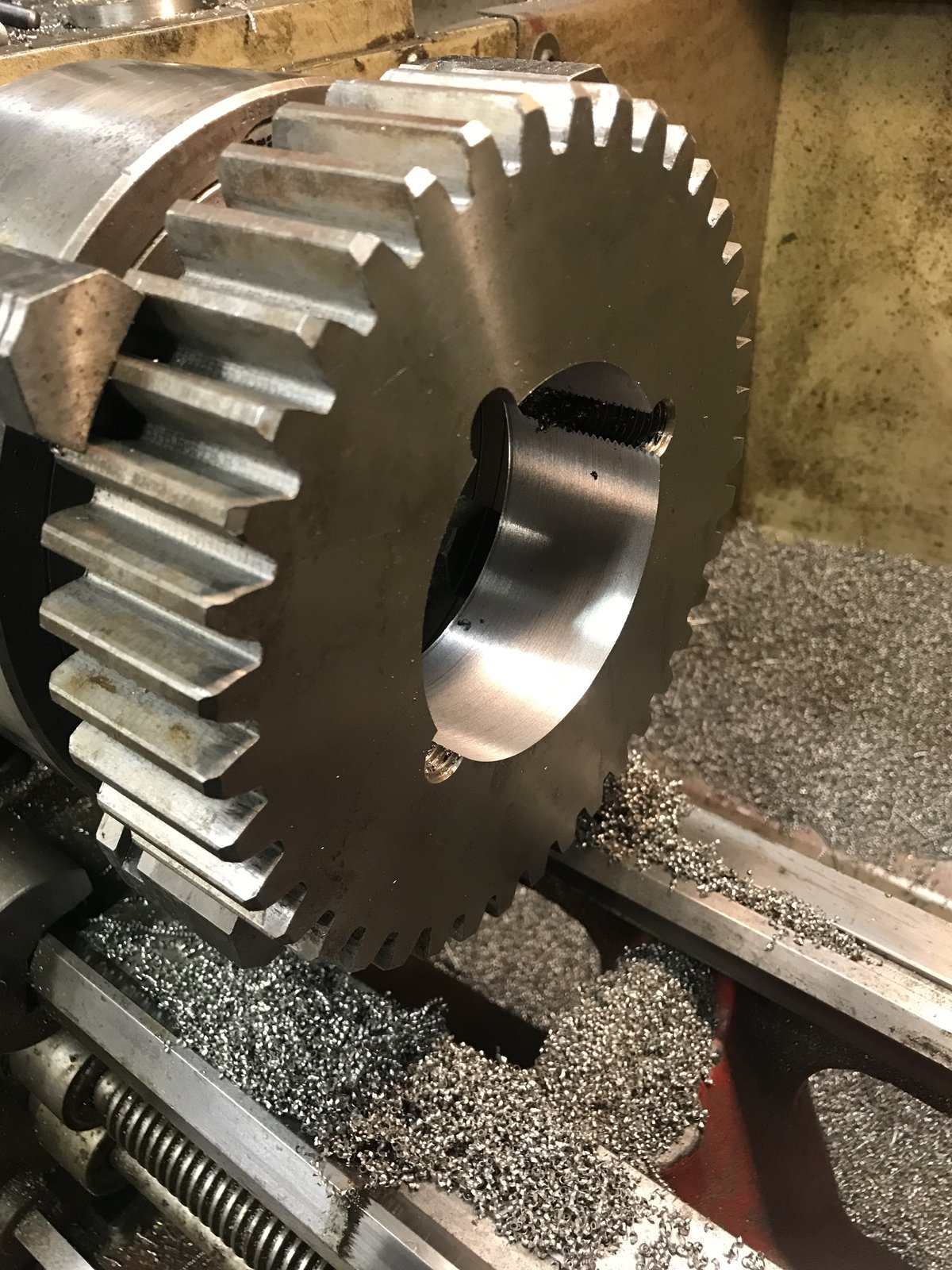

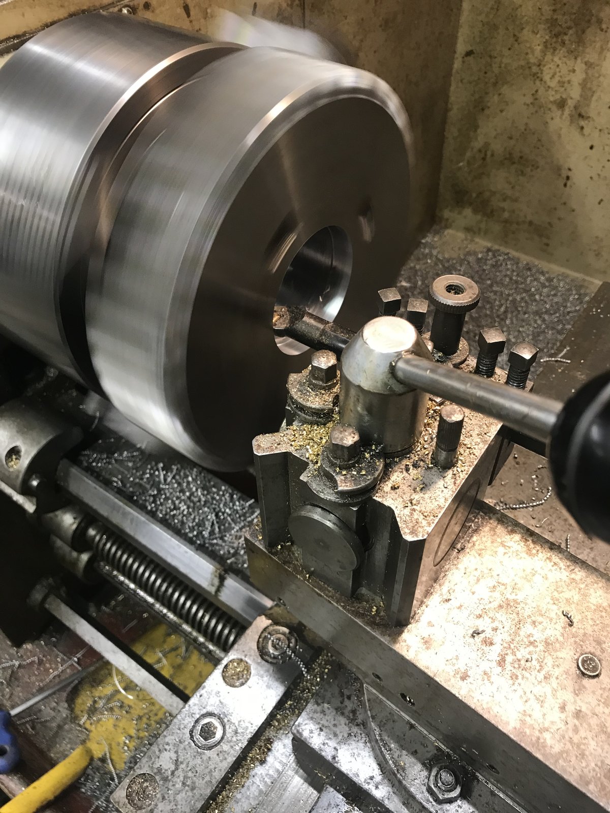

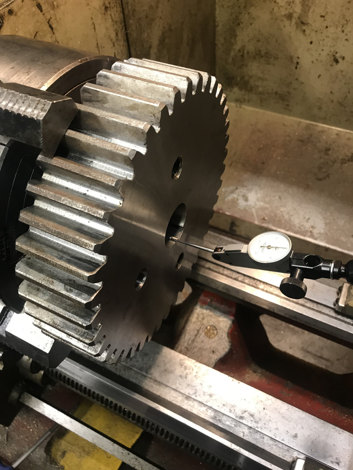

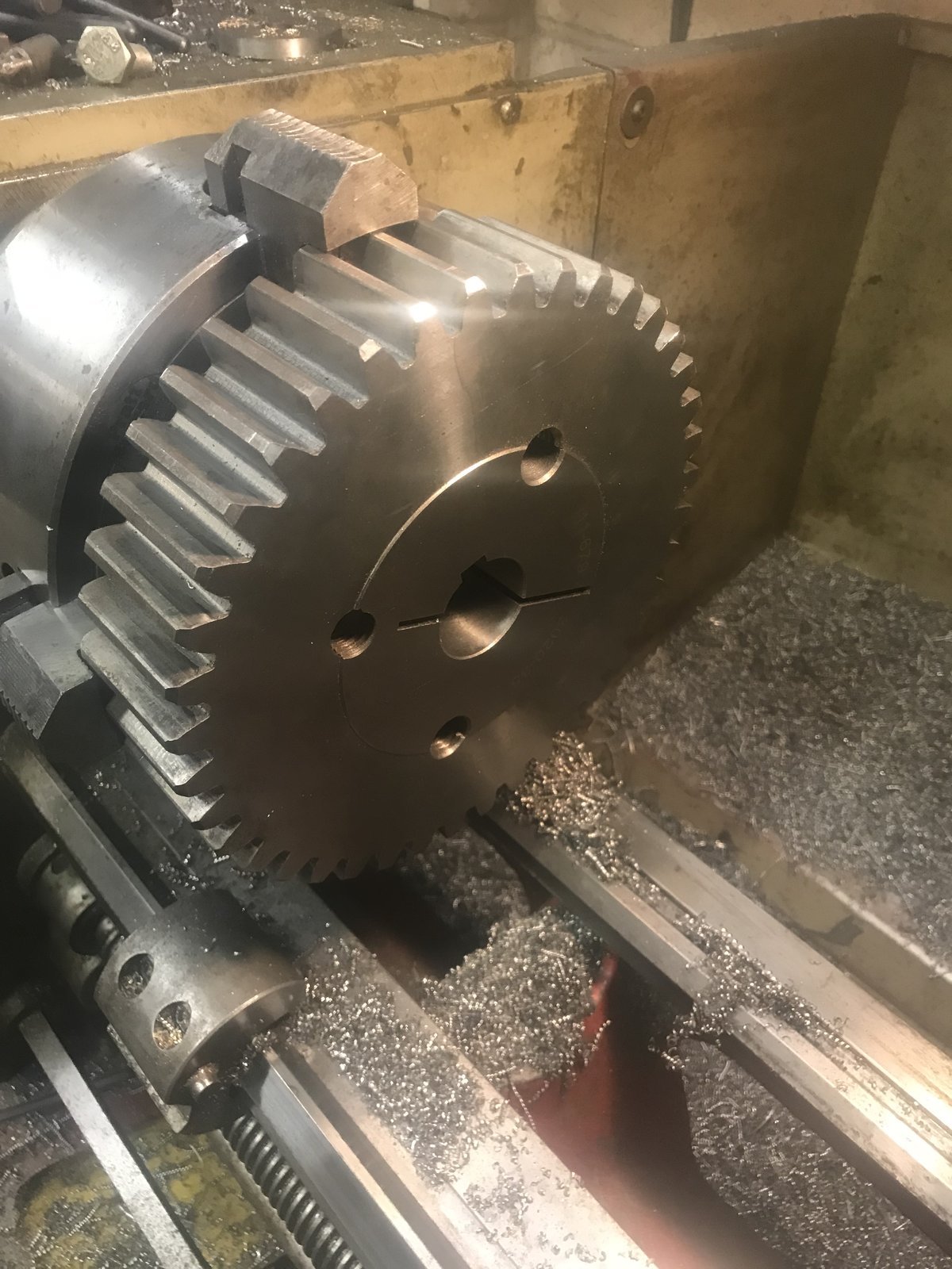

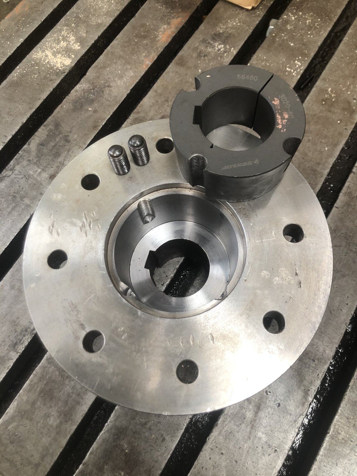

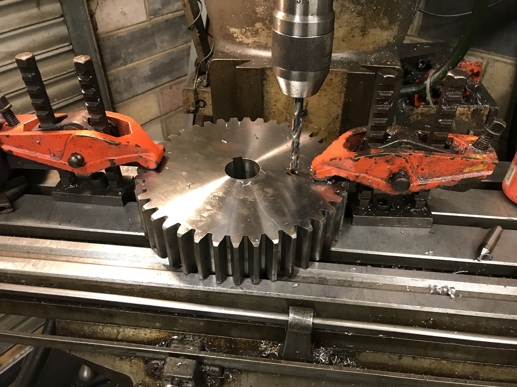

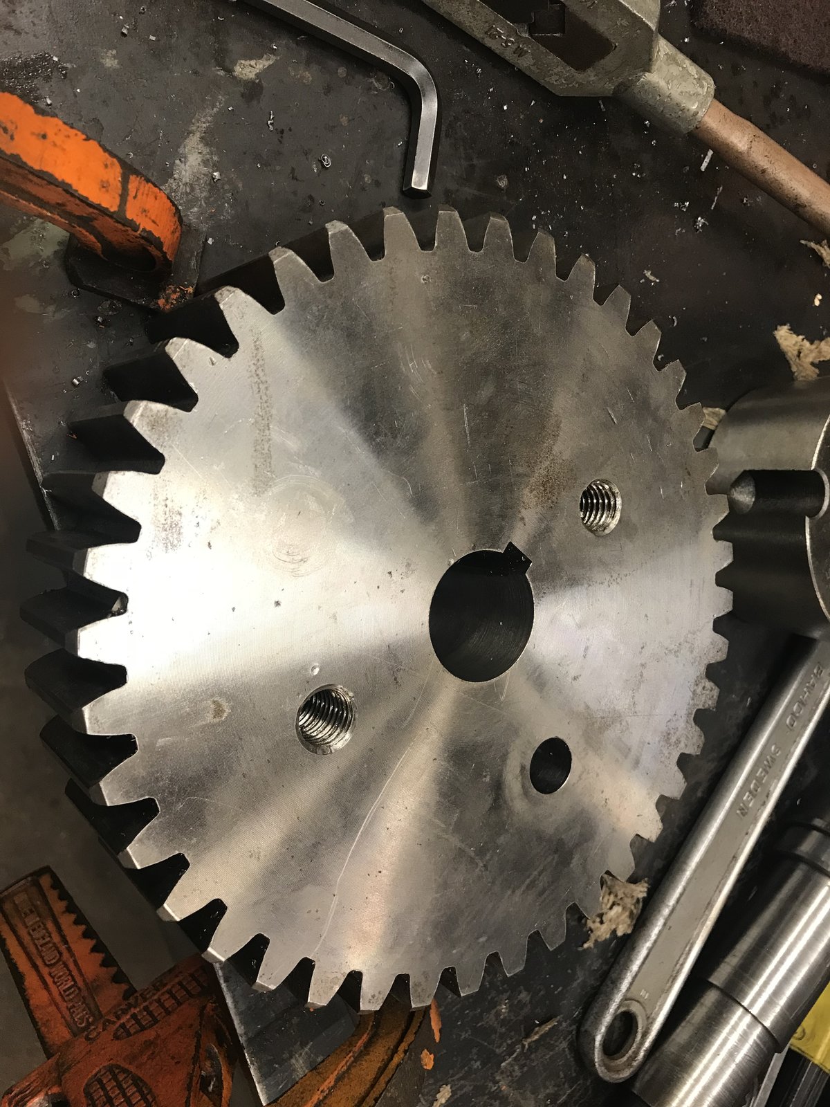

How did you pick up the threads in your new pulley?You can even bore your pulley out to take a taper lock . I don’t know why you’d want to but you can do it
That's really impressive, and way beyond my abilitiesI machined taper lock bores a number of times, it’s actually rather simple once you’ve done one:
View attachment 260258 View attachment 260259 View attachment 260264 View attachment 260260 View attachment 260261 View attachment 260262

Cross & Morse version is a bit cheaper I think. Plain bore only needed in the hub, and plain shaft. No keys. With transmit incredible amounts of torque. Very useful for start/stop indexing operations - no fretting on the keyway or shaft. Have to be fitted correctly, going around and around the set-screws to tighten them properly.When you fit a taper lock be careful with the fit of the key. If it is at all tight in the radial direction the inner bit of the taper lock is stressed over it and will crack as you tighten the Allen screws that hold it all together. Although the key needs to be a good fit in the key way it needs about ten thou ‘headroom’ radially.
I first discovered this when I dismantled my 6 foot field flail for rebuilding but have come across it several times since.
