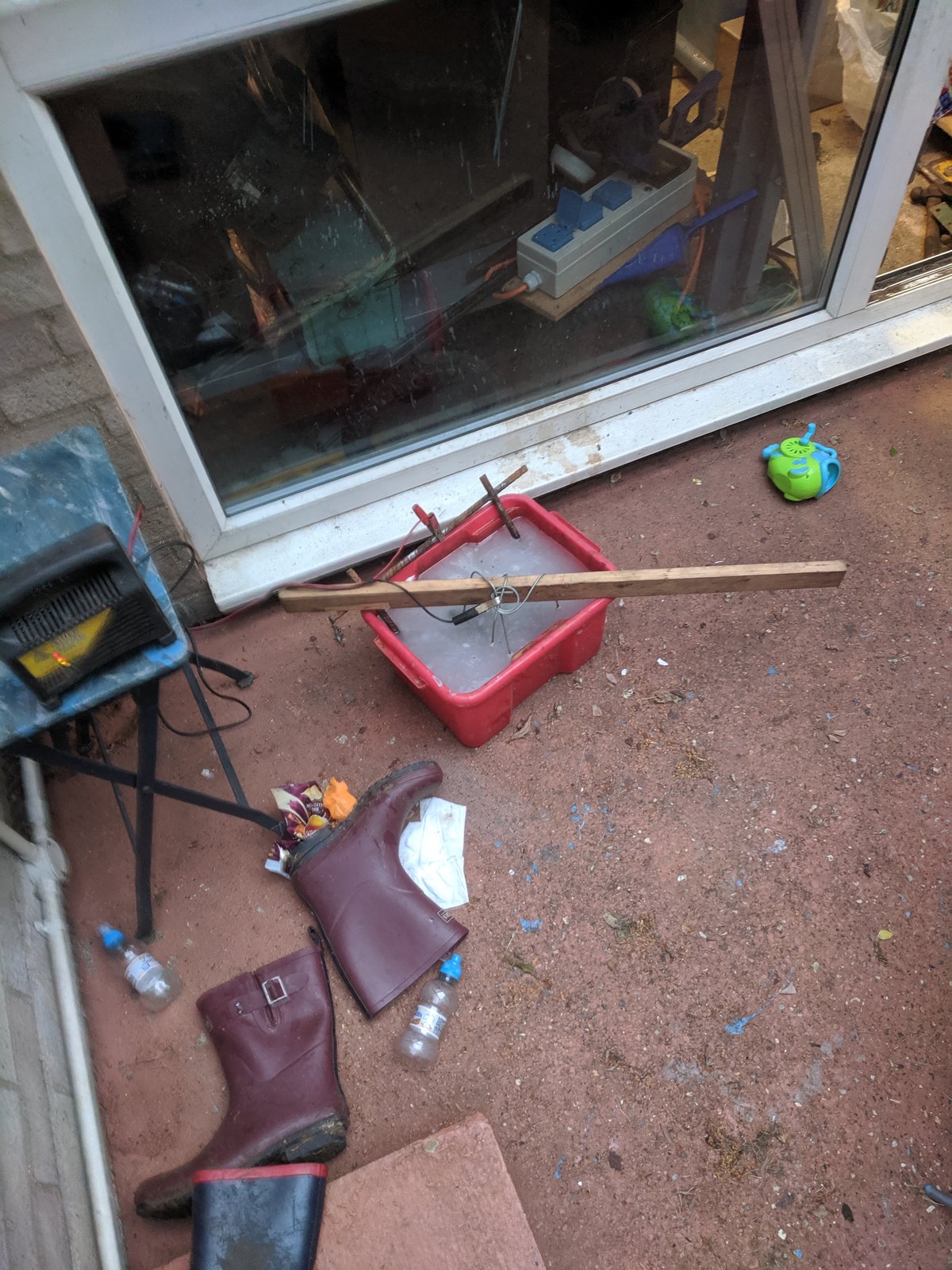

Might as well. Found my soda the other day burried under some boxes

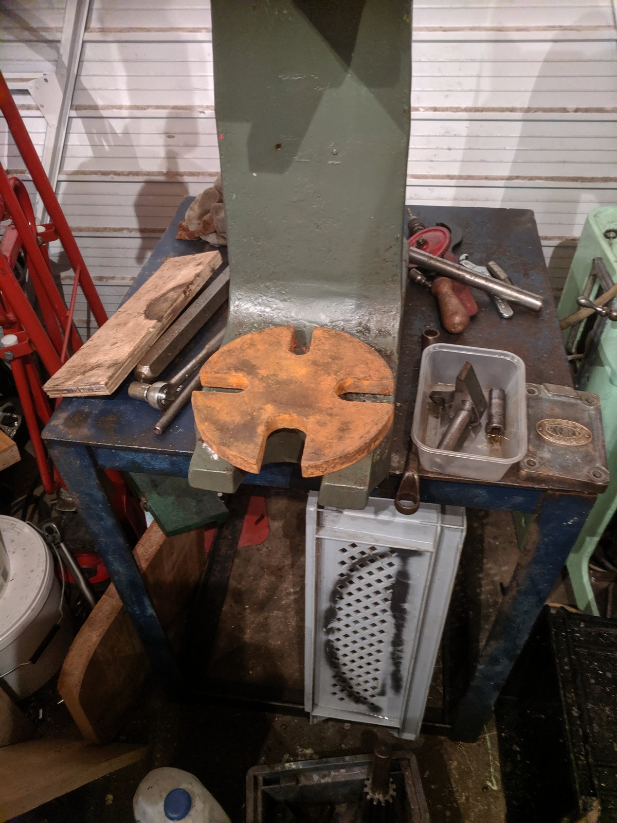

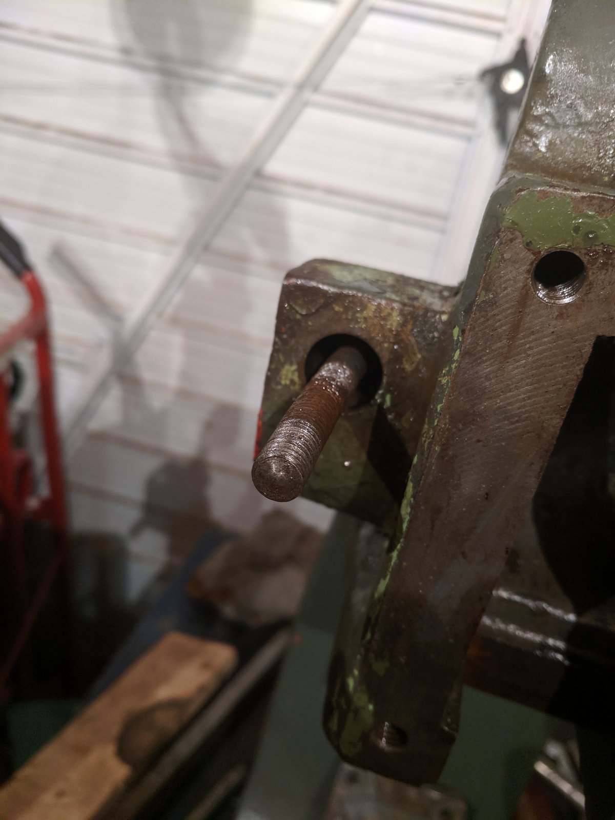

Already on it.Citric acid/ vinegar/ electrolysis, Robin.
When I did my ancient rusted solid mitre trimmer, I left it in in the electrolysis tank for days at low current.
Every bolt came out super easy. I "had" to do that because the machi e was so old, the fasteners were all hand made! I dared not destroy them off or it would have become the welding table I bought it for.

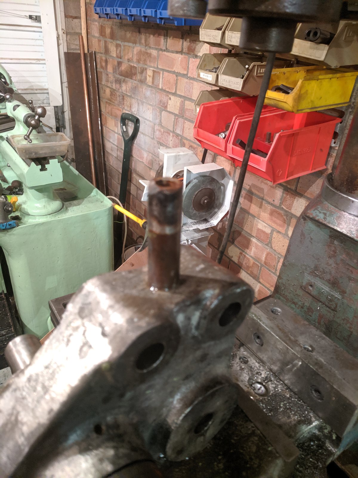

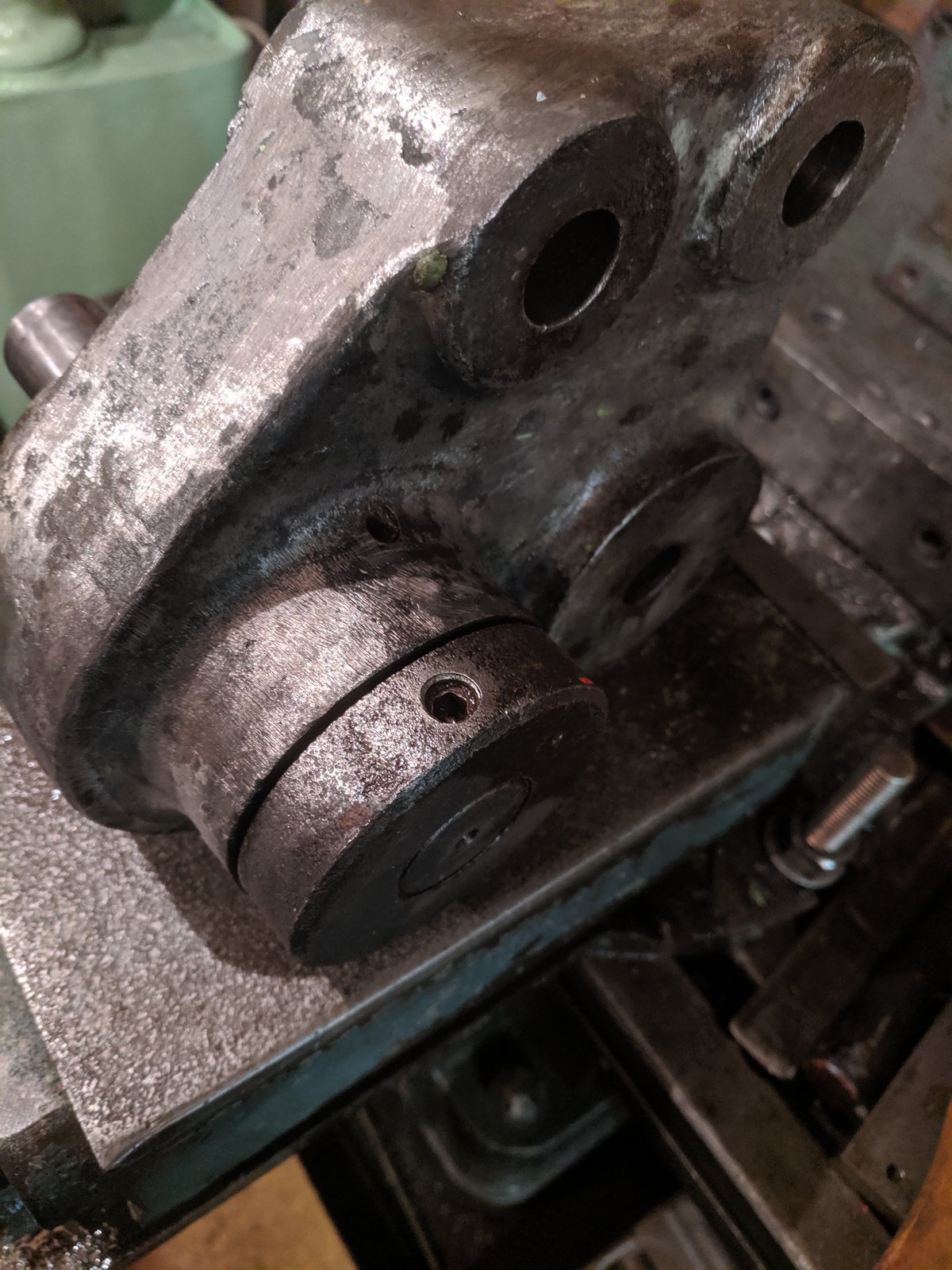

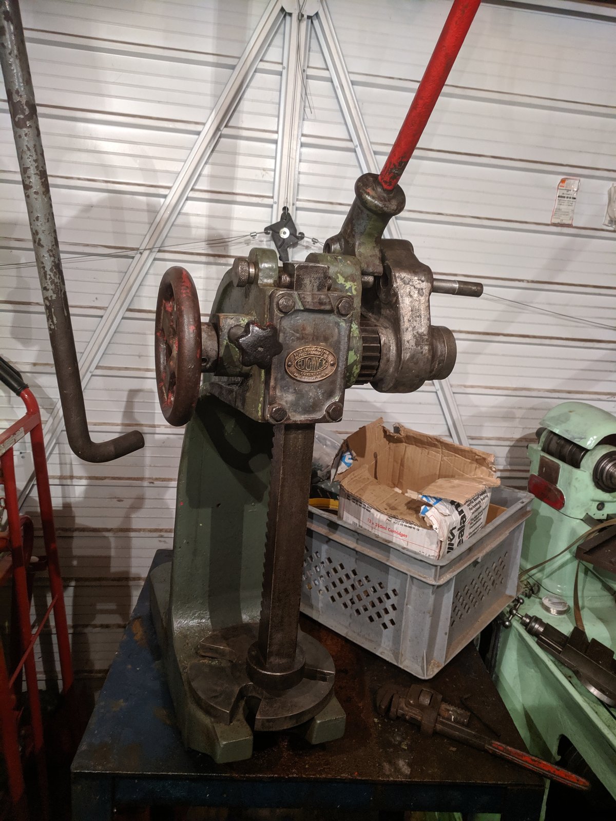

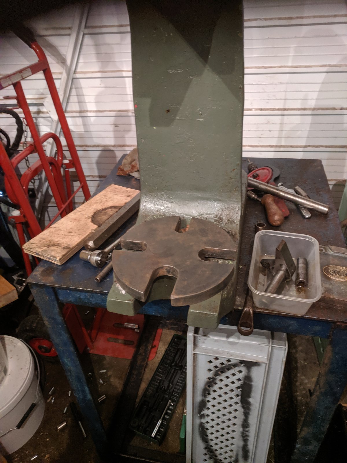

Nice idea but nope. Definitely one piece.Check to see if it’s a locking grub like on a Bridgeport. Insert a hex only a short way in and see if there is a a separate locking screw on top of the normal grub.

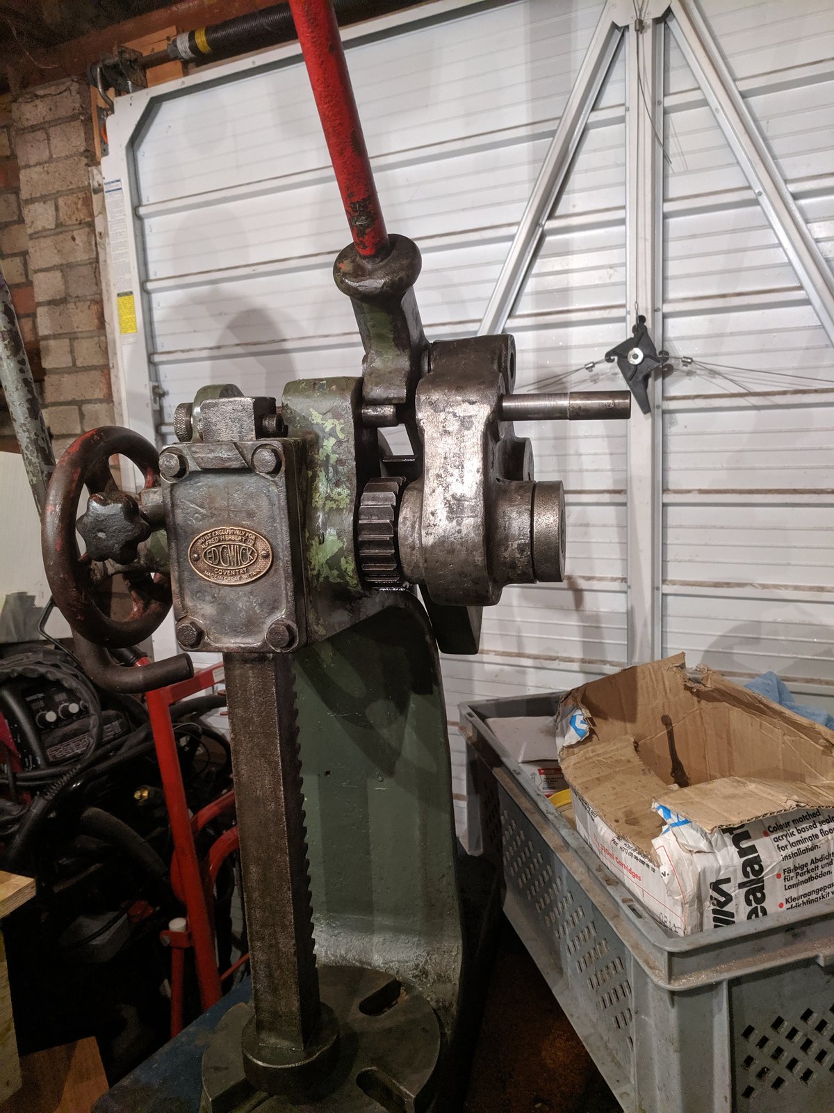

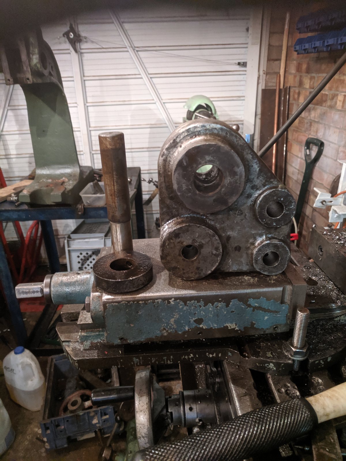

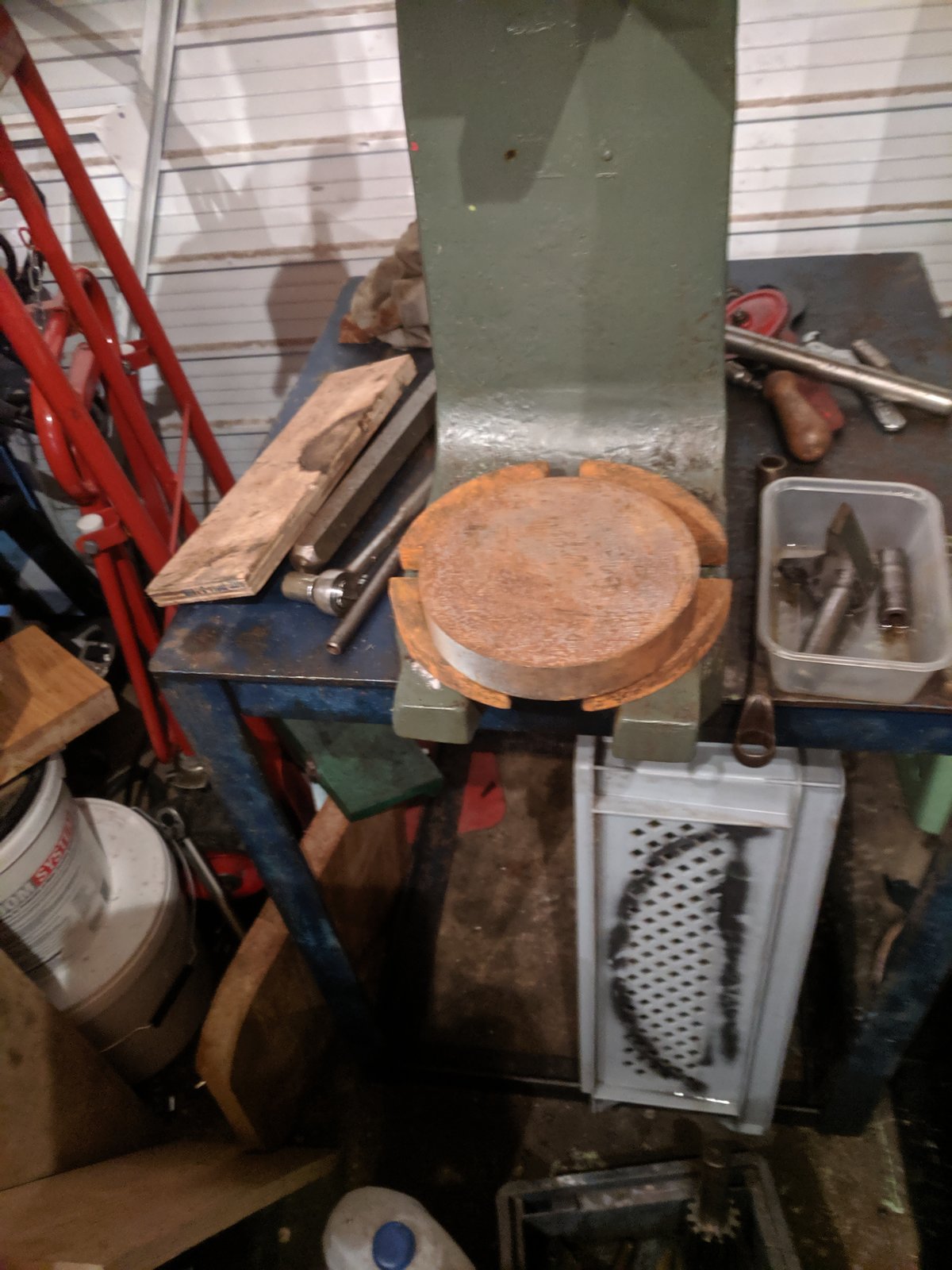

Yup. Looks good on there. Made my day.Thought it looked close. Glad it’s completed the press.
Don't suppose anyone near bedfordshire has a surface grinder.
The state of the rack/ram is bugging me.
That would be appreciated Adam.Robin, we have one at work. I can ask the tool makers nicely if they can give it a once over if you can get it to me? I'm in Leighton

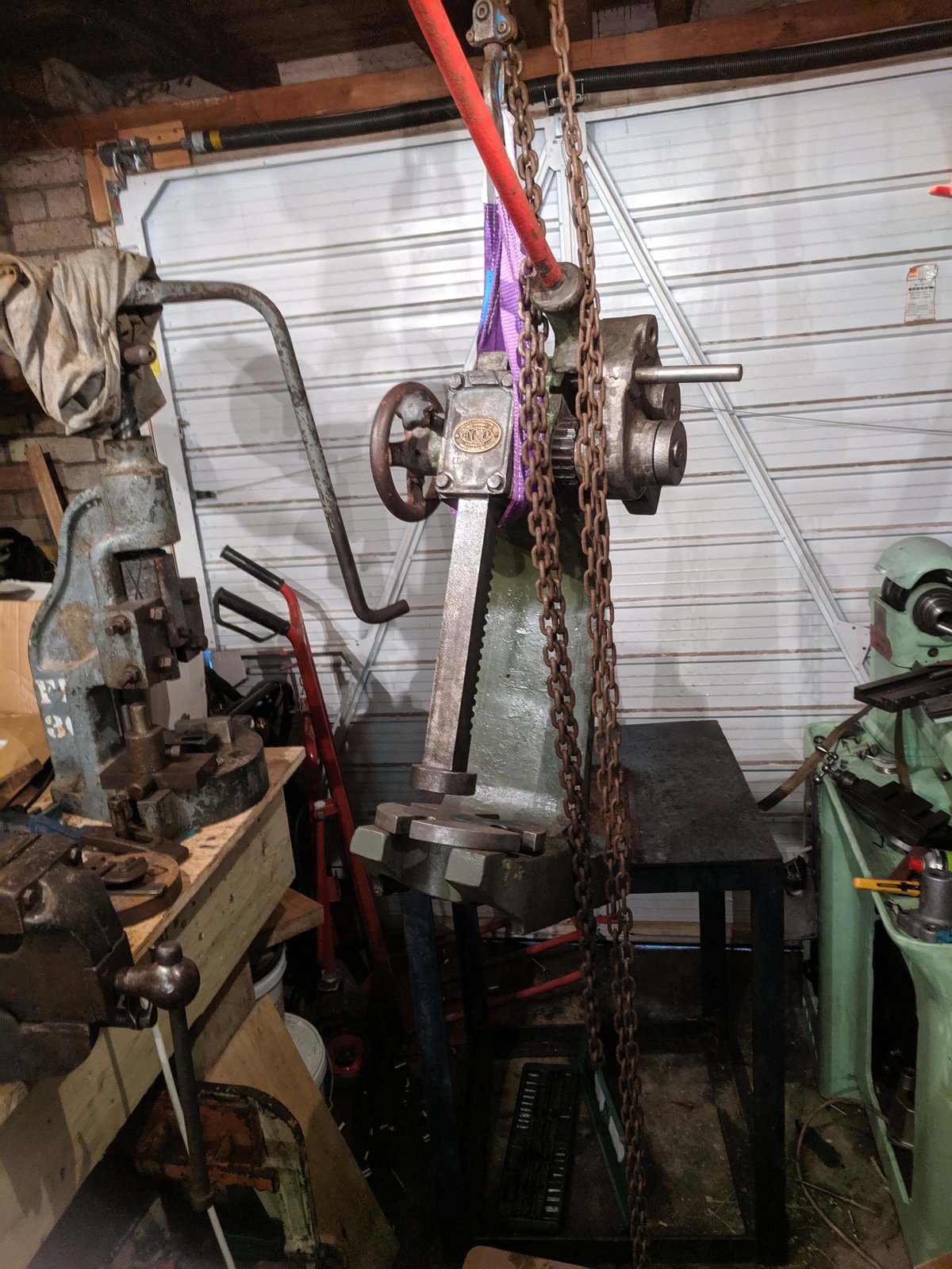

Tell the neighbor's to f off. If they still carry on then use a lump of wood. Works for meEven without the arms on it this was too much for me to lift.

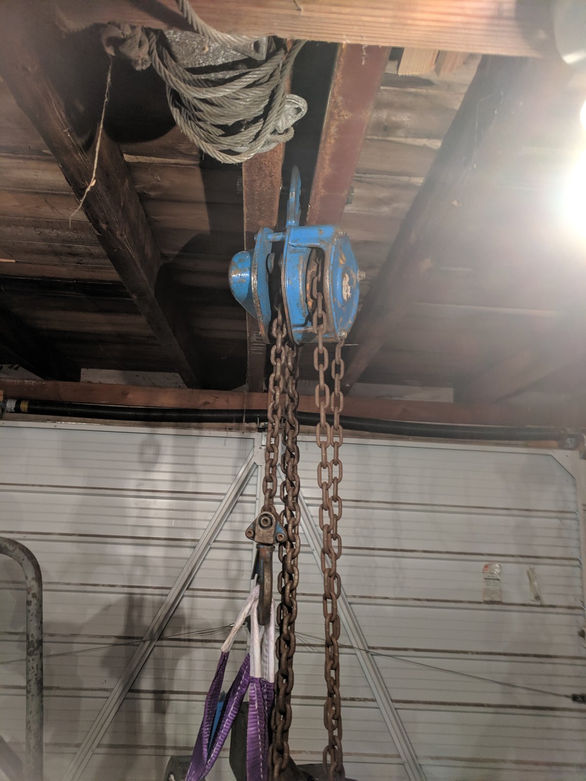

Knew the hoist would come in handy again

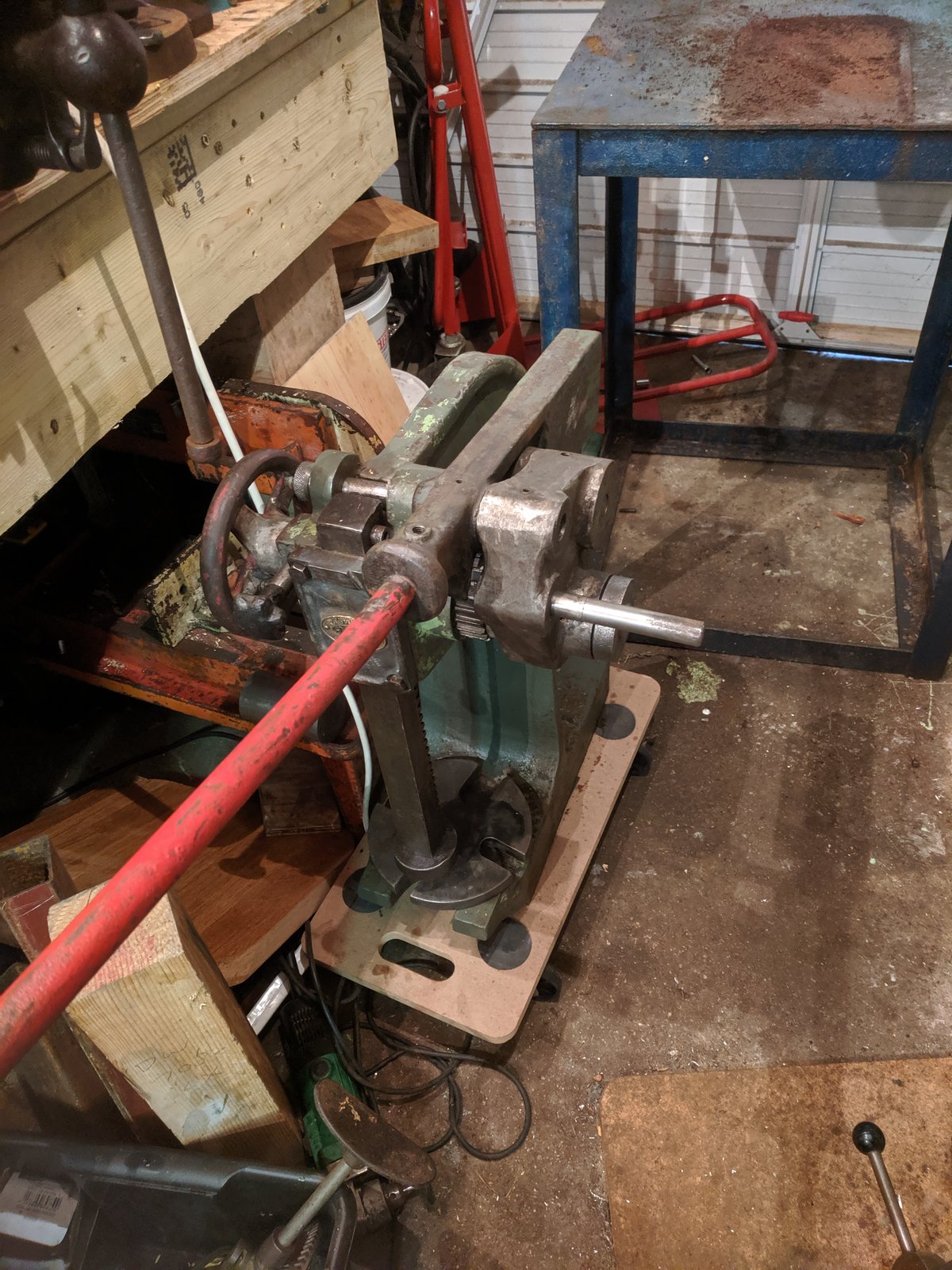

Can roll it out front and get the rest of the paint off now.

Took me 1 minute to lift and lower it.
