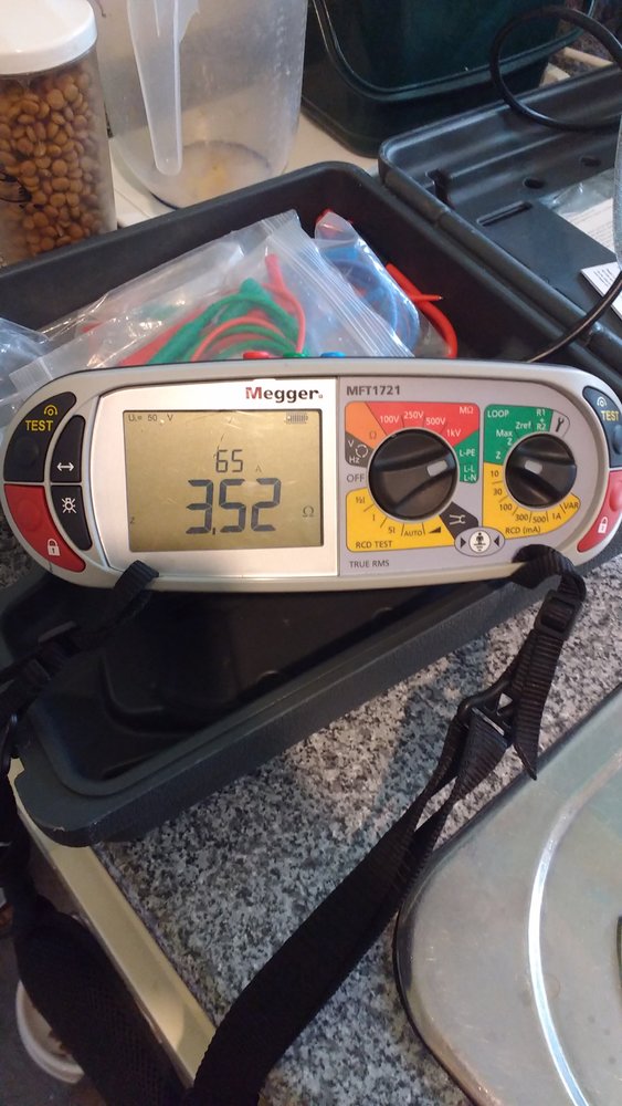

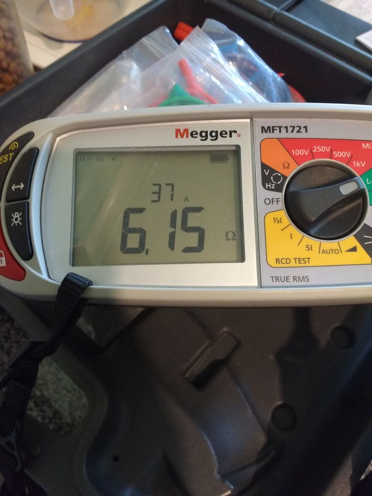

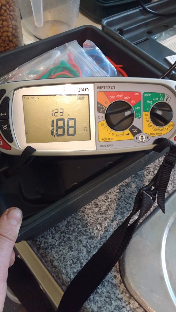

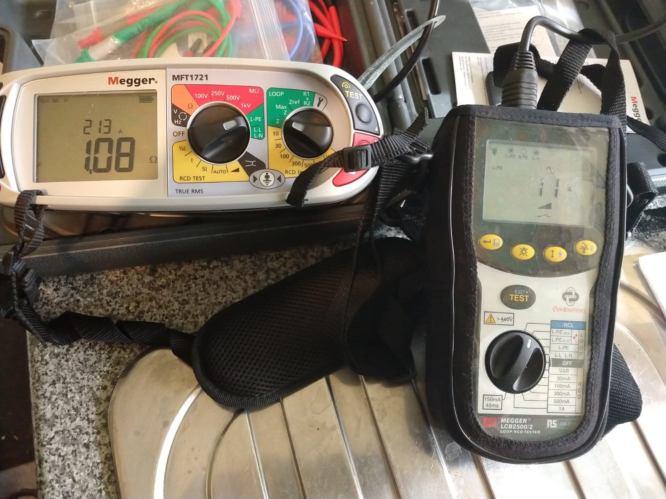

Well that's me flummoxed!
With my old meter, uncalibrated I get a consistent 21 ohms (11A to earth give or take). Tbh I thought that pretty good. The max I think for a TT in the OSG iirc is 20 + 1 "for the rod"?
I then tested using work's new MFT, calibrated etc. Got a well low reading:
Trouble is it's not repeatable, all over the shop on successive tests:
Loose connection maybe? Think I've some dead test results for that ring somewhere...
This happens with meggas if the leads are left in and layed down they become loose at the PCb
