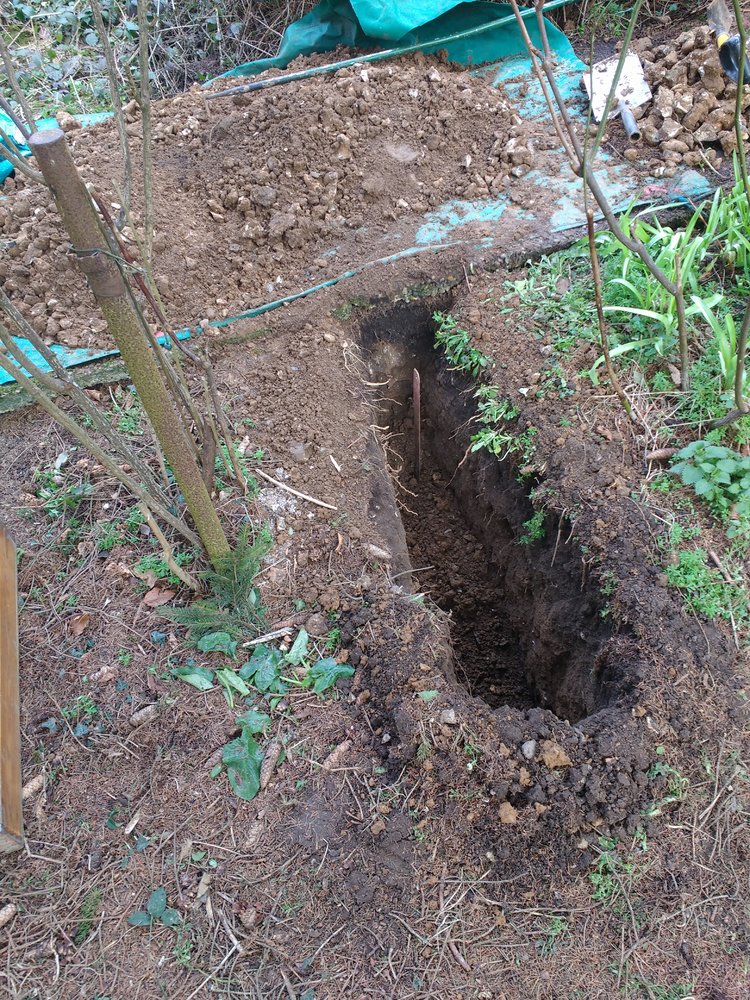

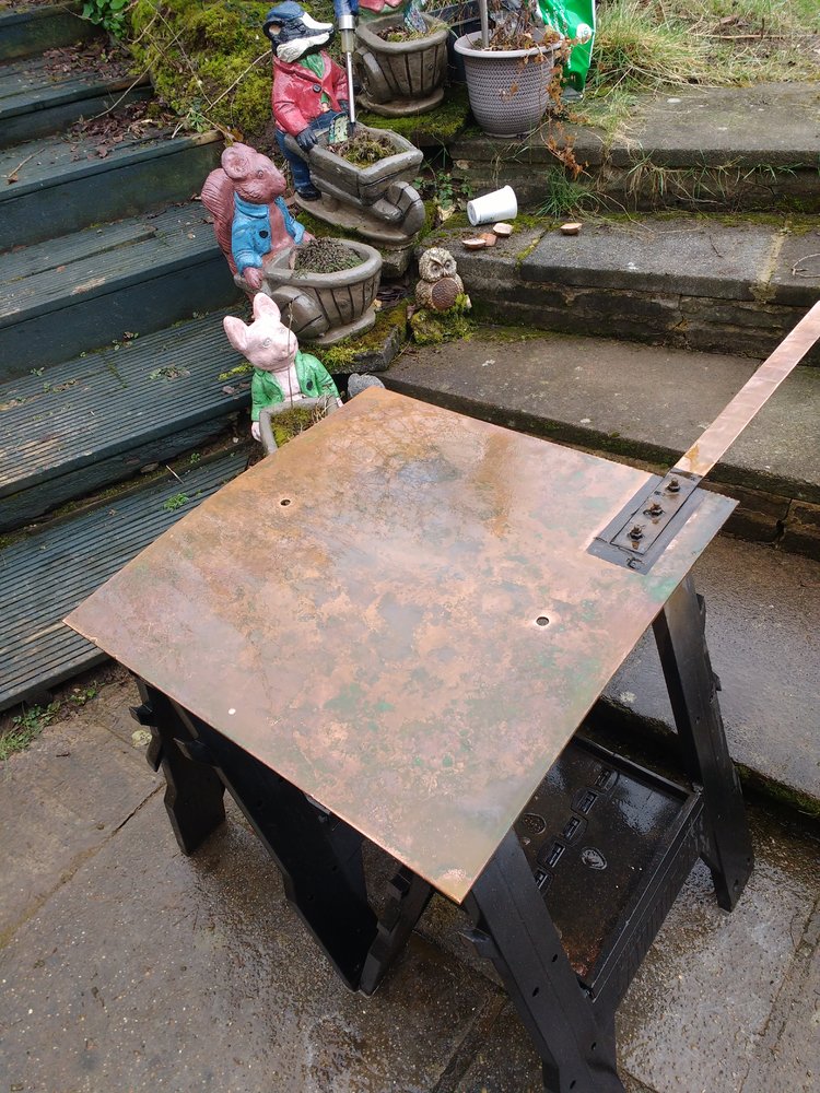

Welcome to the forum.The only time I have ever found it necessary to get creative with earth electrodes was when the client had an indoor swimming pool and to avoid issues with the supply neutral, we had to employ a TT earthing system to protect the whole house installation.
To ensure the earth touch voltage could not exceed 50 Volt we had to provide a earth electrode that didn’t exceed 20 Ohm.
To the OP, if you are committed to creating a TT installation with sufficiently low Ze to enable your MCBs to operate within 0.4 seconds in the event of your RCD failing to operate; are you aware of the maximum permissible impedance needed to ensure that your MCBs will operate?
The impedance of your electrodes will vary and may also depend upon the reliability of the earth conductor termination to the electrode or any other metal to metal joints.
If your 30 mA RCD is in good working order your main earth conductor only needs to flow 0.03 Amp to operate.
Good luck with your project.
