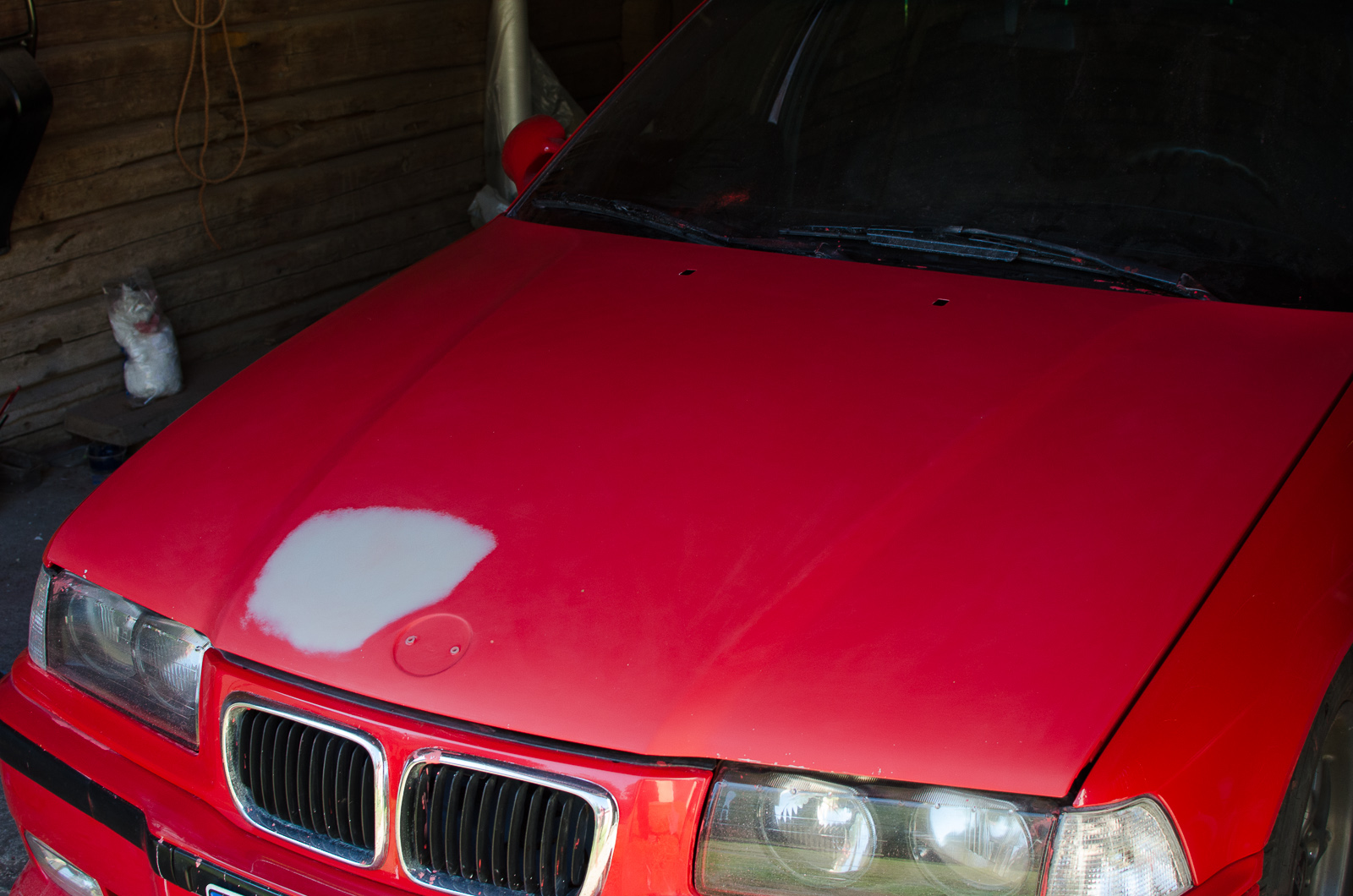

    Thanks. There has been times where I felt like selling mine when doing projects like this.
    Work with old BMW has kept going.
    Paint in the bonnet was showing age it was like rough sand paper, I tried polishing it in the spring without much luck so old paint wet sanded down with 600 grit, filled some small indentation from stone or possibly ice block and spot primed with epoxy:
    Otherwise it's looking like a car, nearly everything put together:
    Layer of dust everywhere but bonnet in fresh paint waiting for final stage of color sanding and polishing:

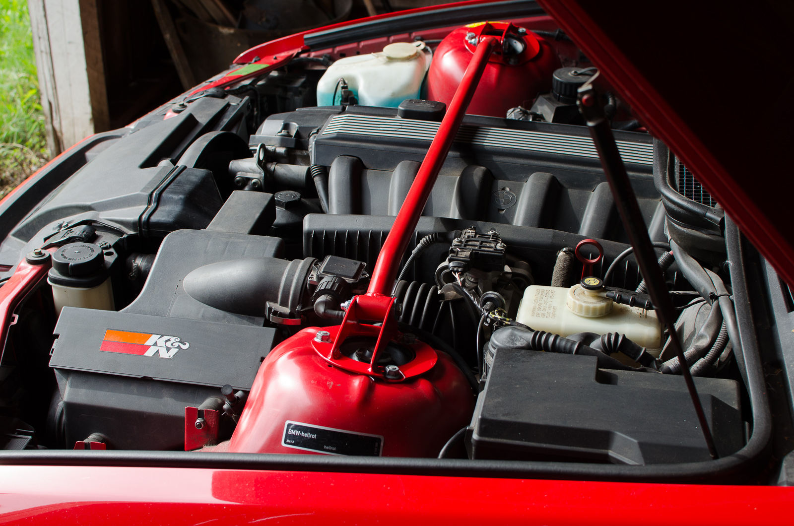

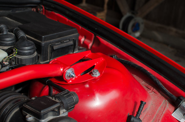

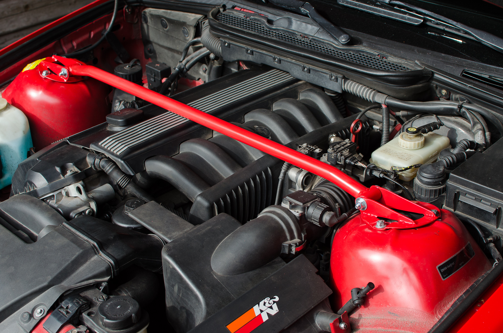

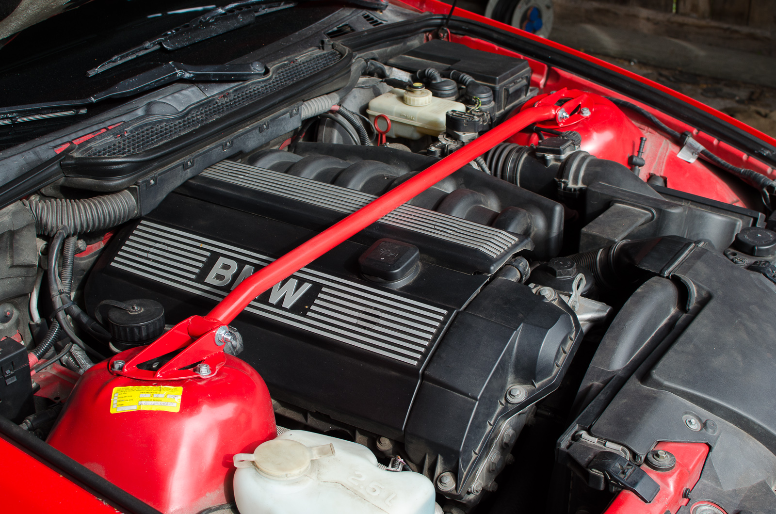

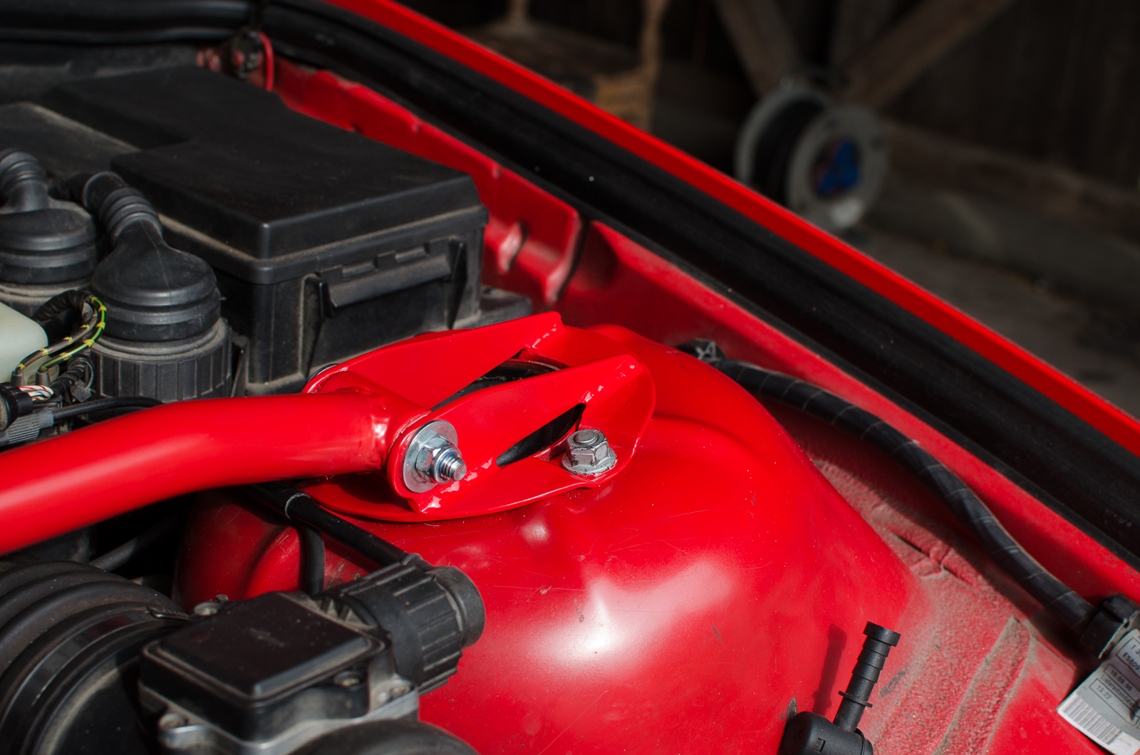

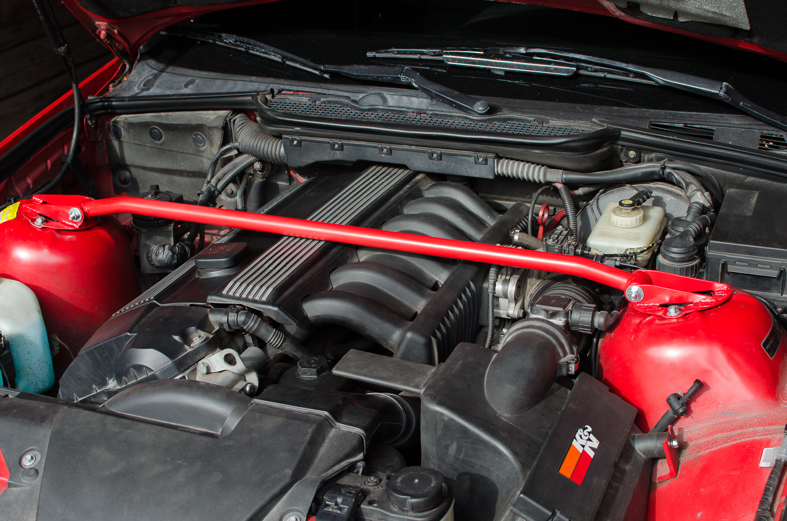

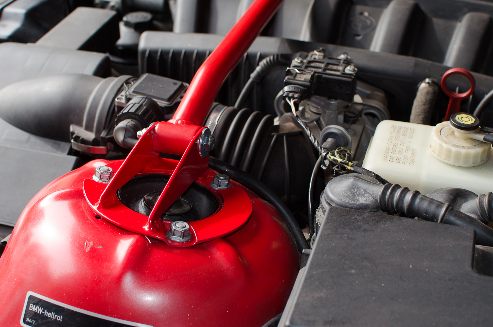

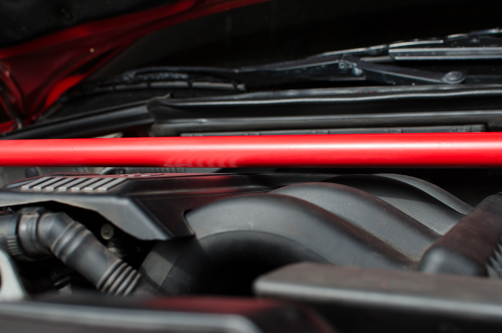

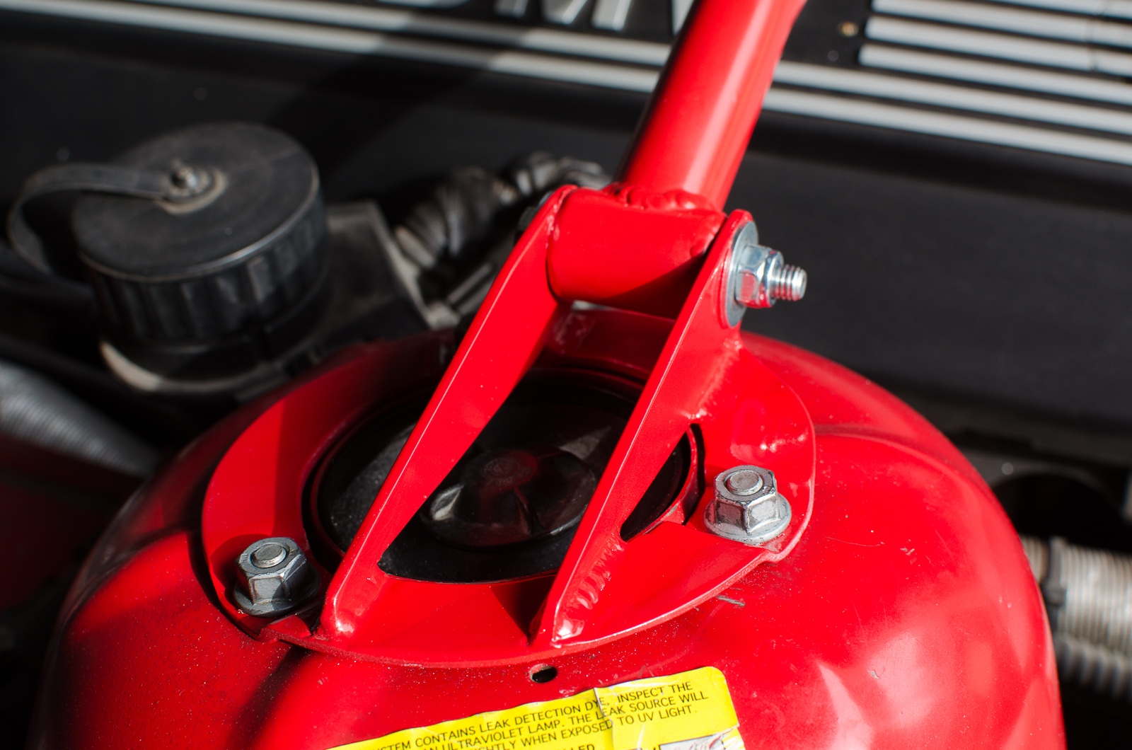

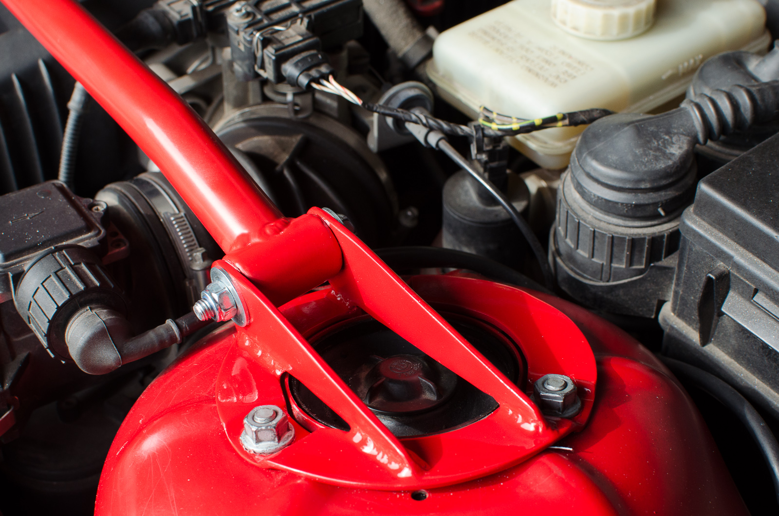

    Made a DIY strut brace for E36. Using 3 mm steel and 25 mm tubing, welded with TIG. Bolt holes were recessed with simple steel plate dies and hydraulic press.
    Took few pics after spray can paint job:
