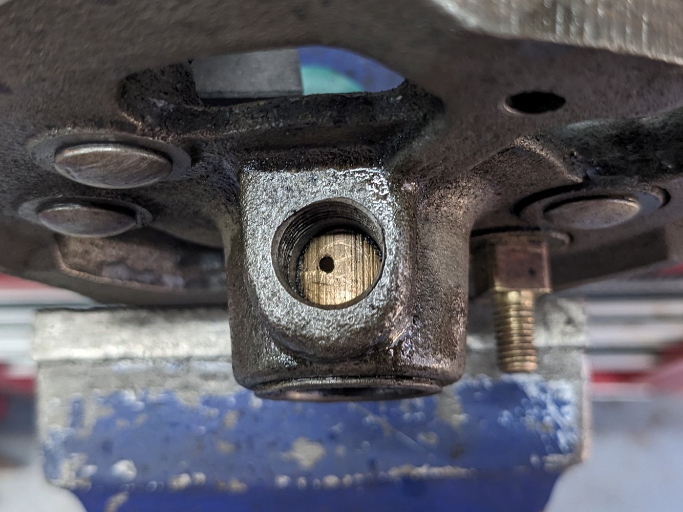

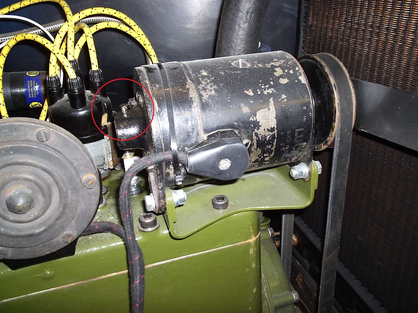

As the radiator is off for rebuilding I took the opportunity to gain access to the front of the engine. After cleaning it down and removing the fan I tackled the dynamo.
I haven't encountered one with a lubrication fitting for the rear bush.
Should there be some kind of lubricator or just a felt 'reservoir' and plug? The best Google result seems to be an MG specialist Brown and Gammons, but there isn't a useful illustration.
Given that I found the studs for the fan in the cast iron water pump pulley were UNF, the studs for the dynamo bracket to block were BSF and the nuts and set screws for the dynamo tension adjustment were BSW presumably this thread is British Cycle Thread or something equally unlikely. At least I haven't found any OEM Metric yet.
