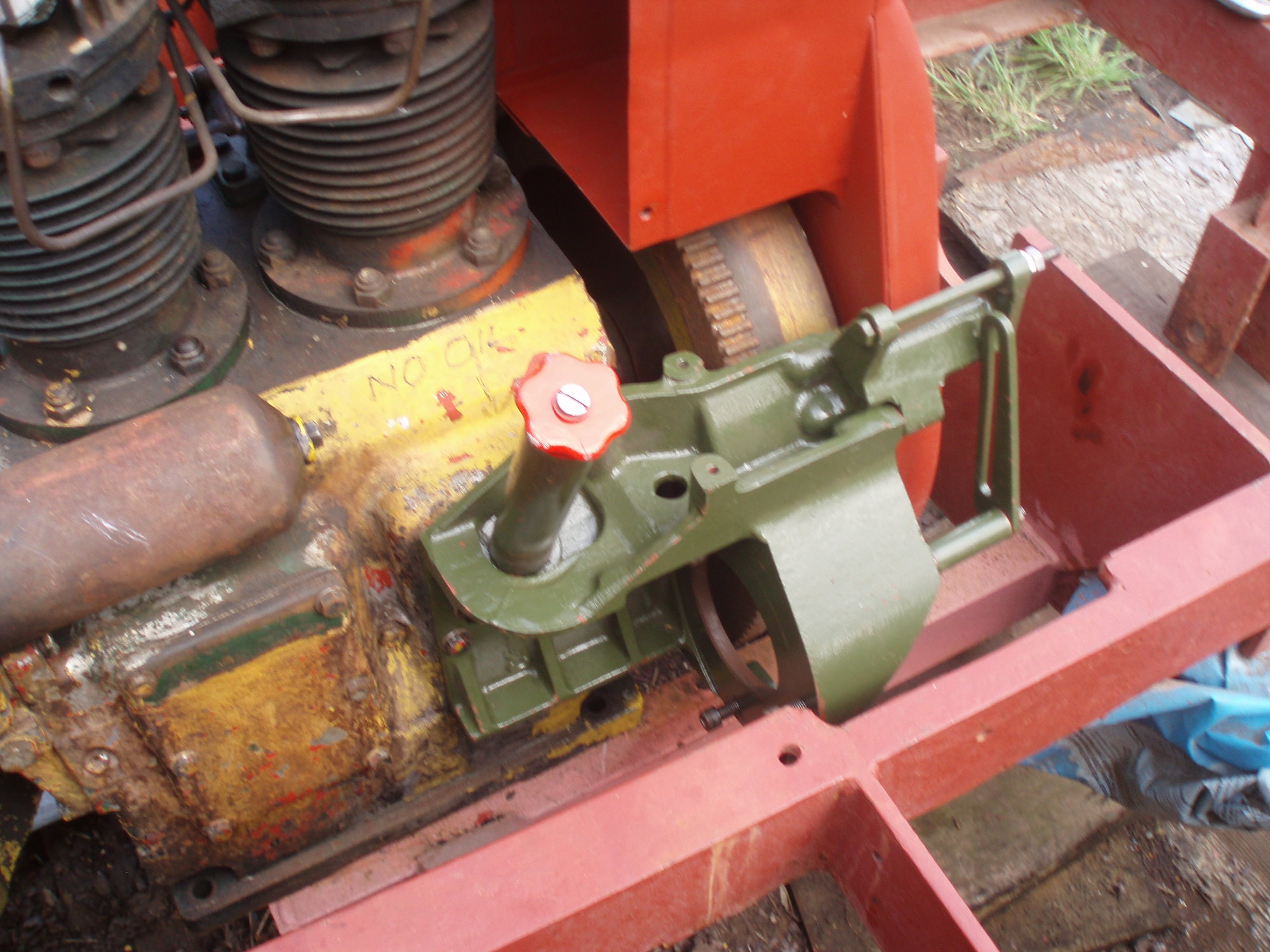

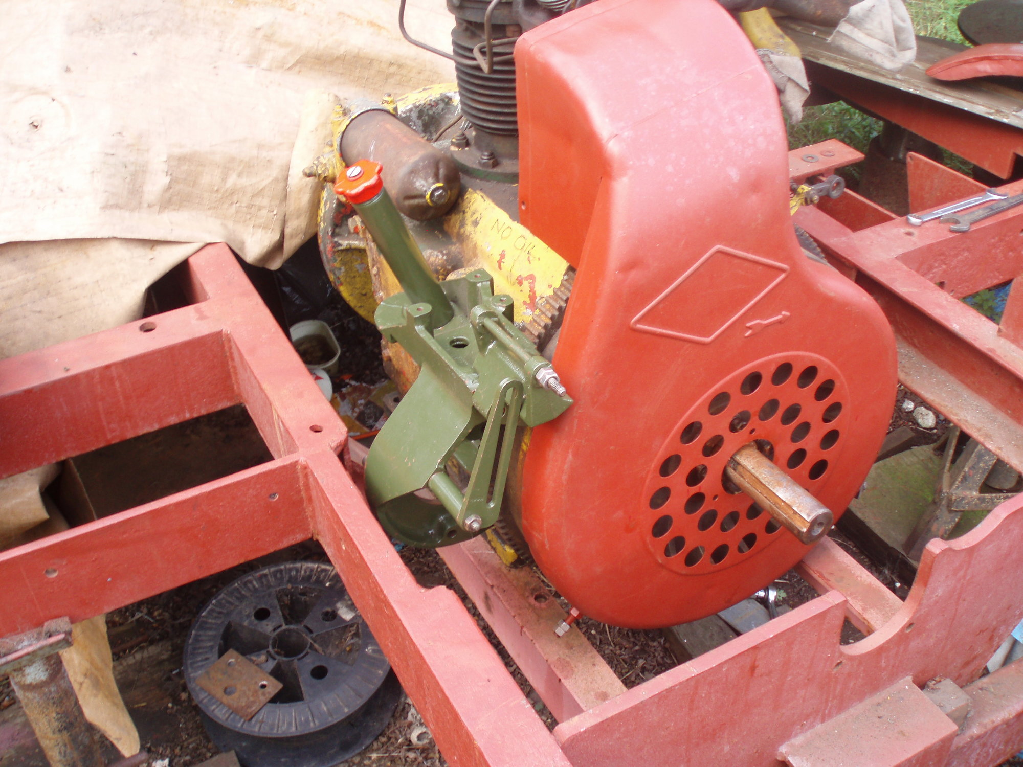

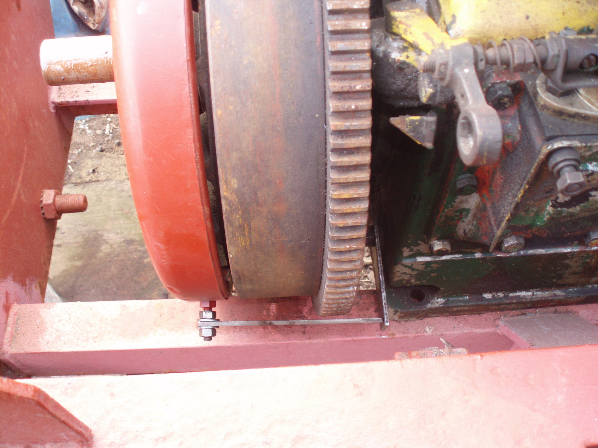

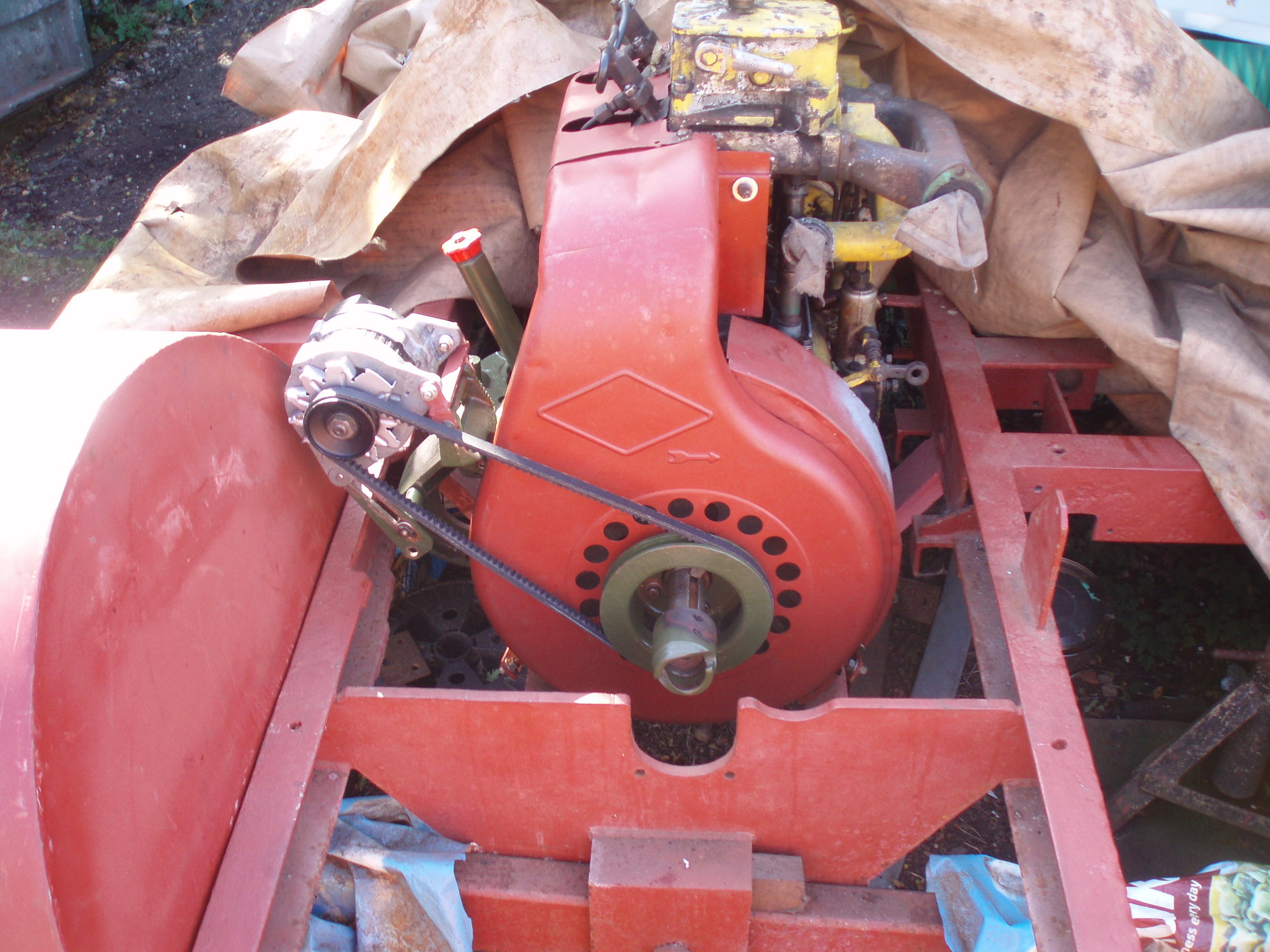

    All sorts of mods to get this far.

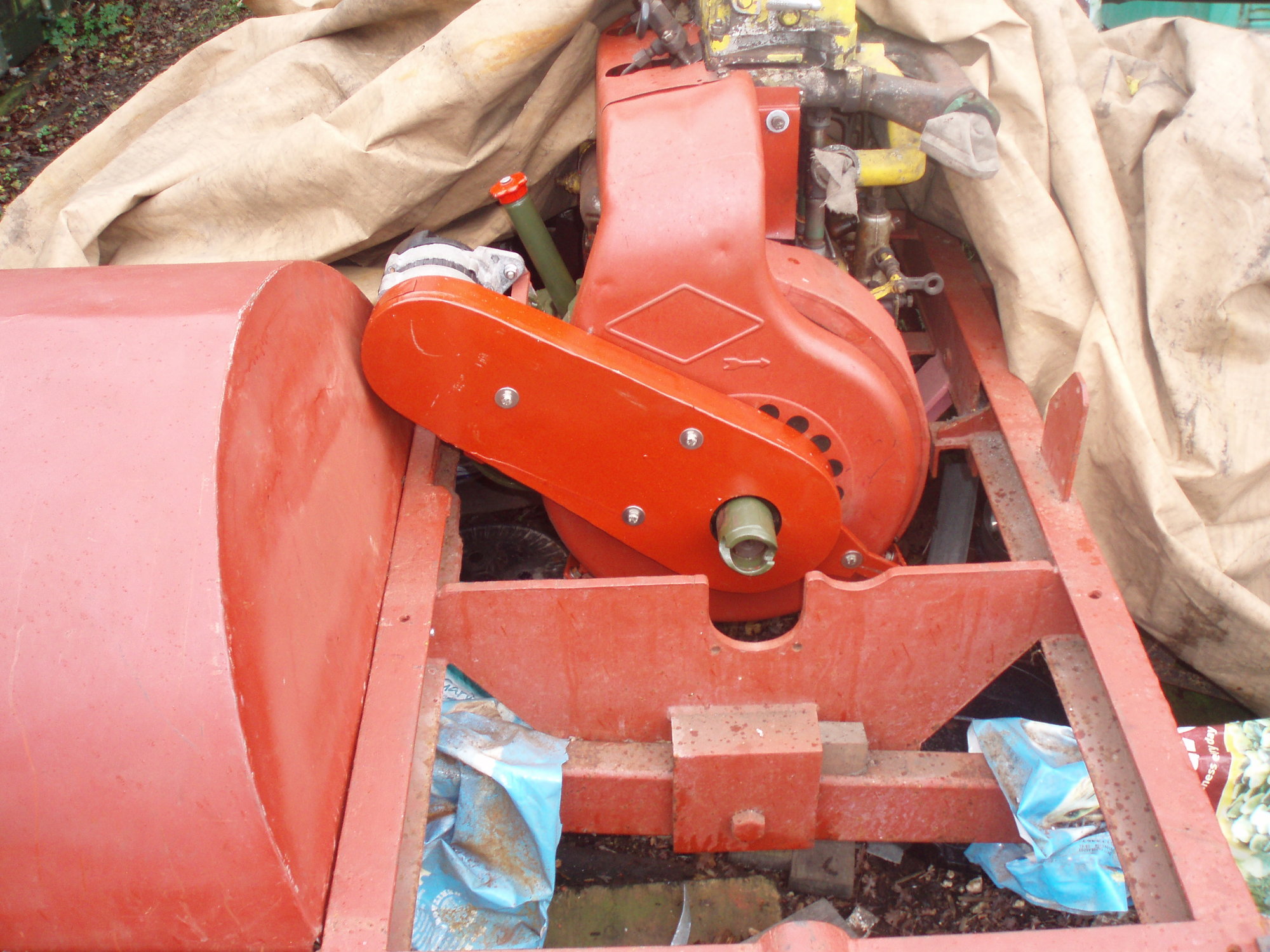

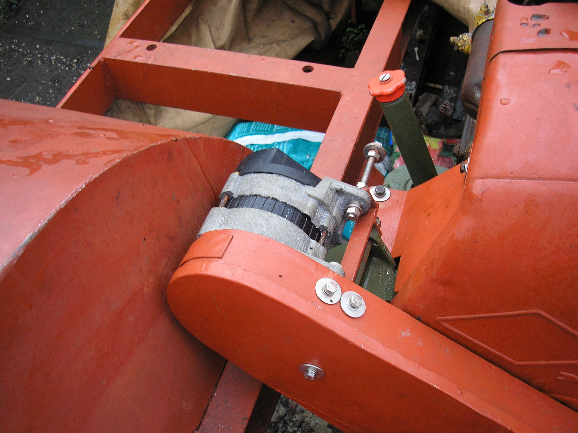

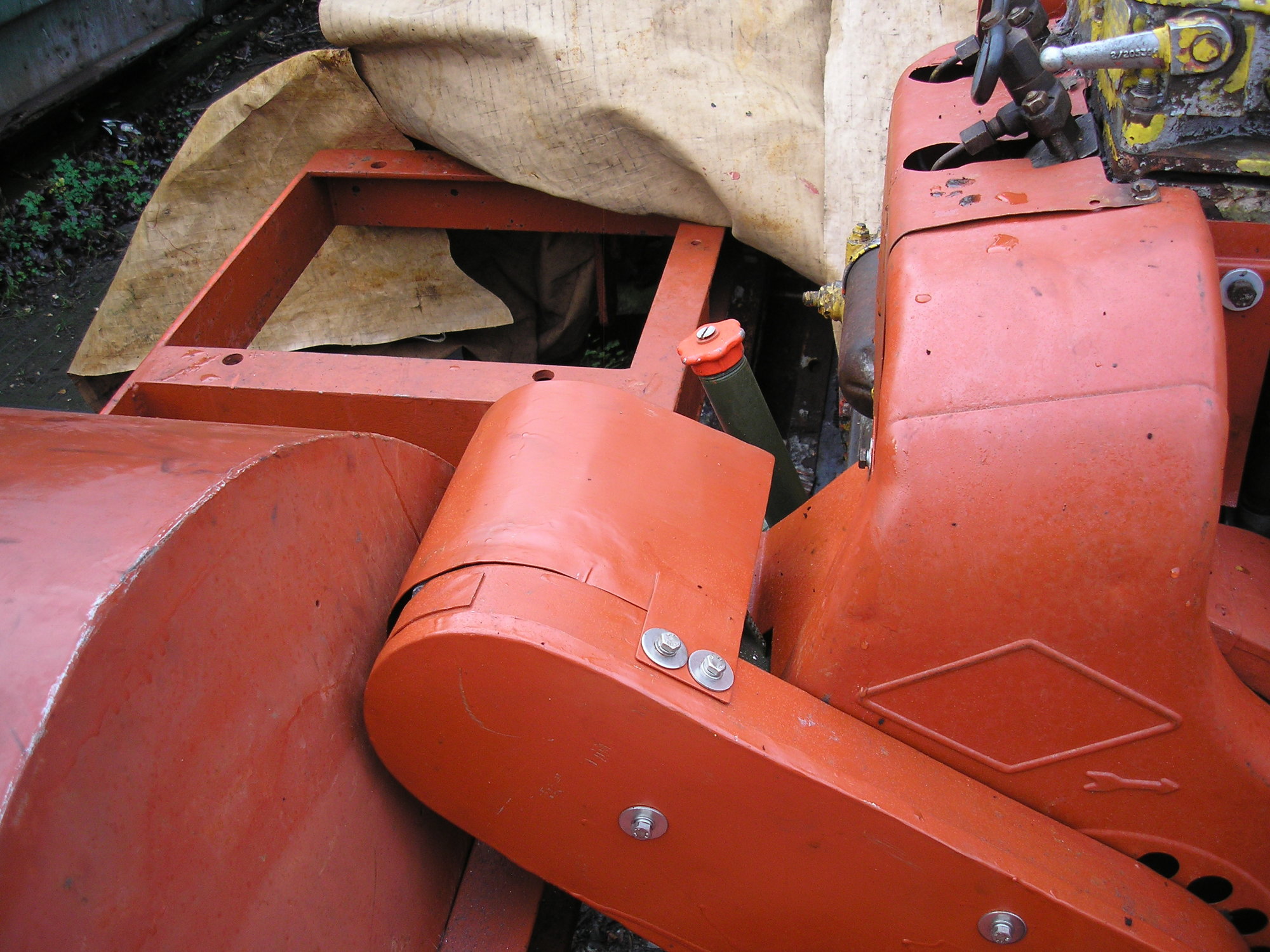

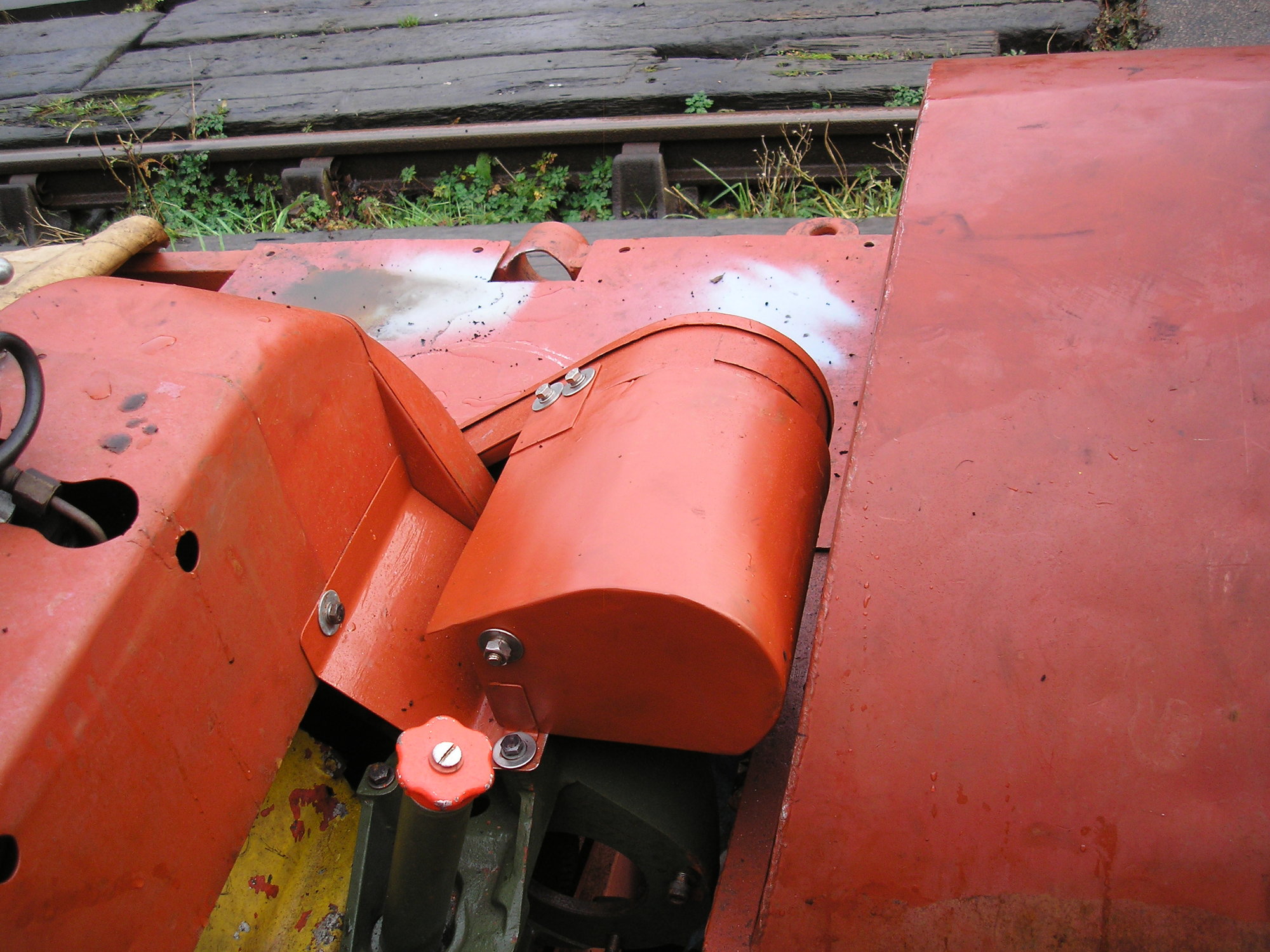

    Got the tin ware done eventually. The belt guard took a bit of fettling as there isn't one made for this model and had to fab it from scratch. I can start to put the lumps back together now.

    super nice work on the belt guard....
    JP

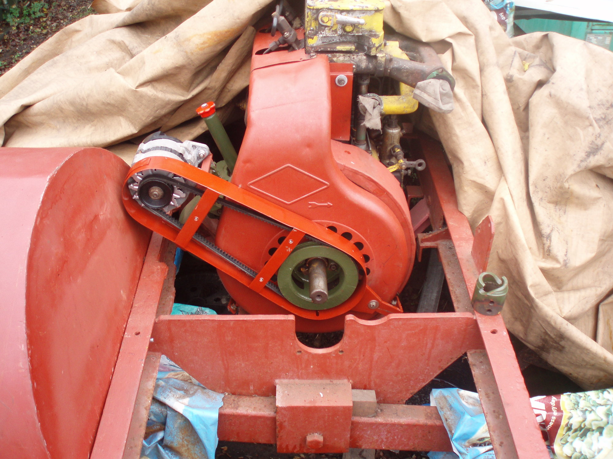

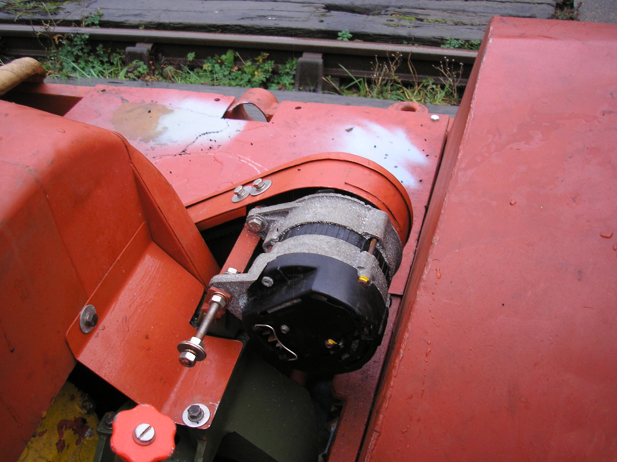

    Well I decided to give the alternator some protection from the elements etc. That will be it until march. P1010191.JPG P1010193.JPG P1010192.JPG P1010190.JPG

    I'm going to wire it when I get back, not being right into electrickery I might need a bit of guidance. Batt to starter Ok. so the rest is a bit grainy, 2 wires to alt 1 from ign in, heavy 1 out back to batt and one from ign to starter. Is that it?. it has to be simple (same as me) It's only a dumper so it just needs to start and charge, accessories might come later.

    Alternator wiring is reasonably straight forward for that type of alternator (Lucas ACR/A series)
    The two large spade terminals go to the battery. Depending on the exact spec of the alternator, both terminals may simply be paralled/joined together, or one is the output, and one is a battery sense. Easy option, is just wire both to the battery positive using reasonable sized wire. Given you won't be using that much power, and I doubt the alternator will be spinning all that fast, I'd probably aim for some wire rated for around 25-30A.
    The small spade connector beside the large spades needs to be connected to positive via a 2.2W (or equivalent) warning lamp. The reason for the relatively large bulb, is it's relied on to excite the alternator. Without it, the alternator would probably have to spin up to 3-4000 RPM before it would self excite, which I doubt this setup will ever achieve.
    Off course, 2.2W warning lamps are pretty hard to come by now, so easy option is fit whatever warning lamp you can find, then add a 5W 60-80ohm resistor in parallel with the lamp.
    Also given it's a basic dumper with a pull stop, you'll probably want to wire in a suitable 12V buzzer as well to avoid the ignition being left on. Just wire it in parallel with the warning light bulb.
    If there are any other spade/stud terminals outwith the main three, it'll likely be a tacho feed, which you can just ignore.

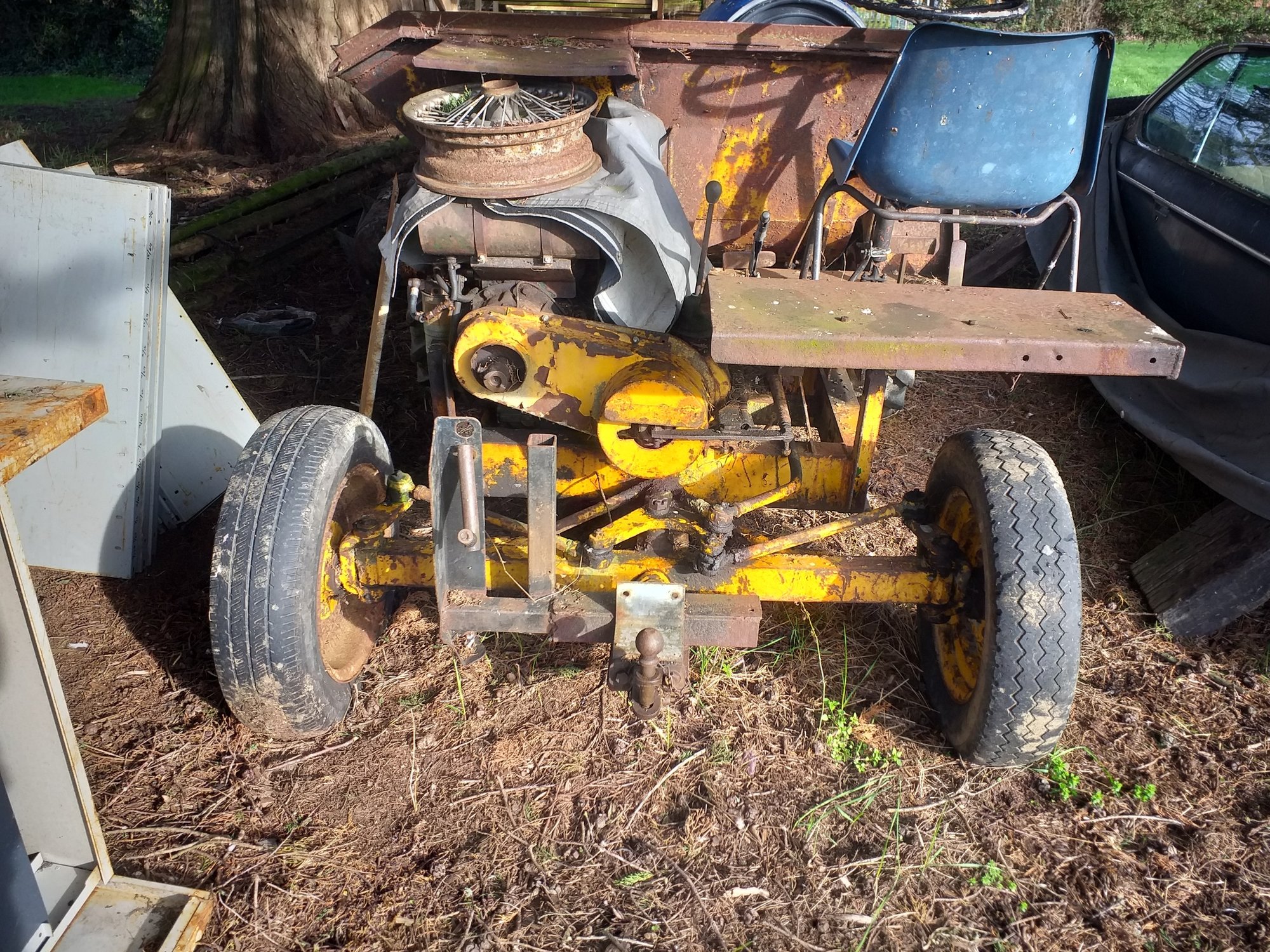

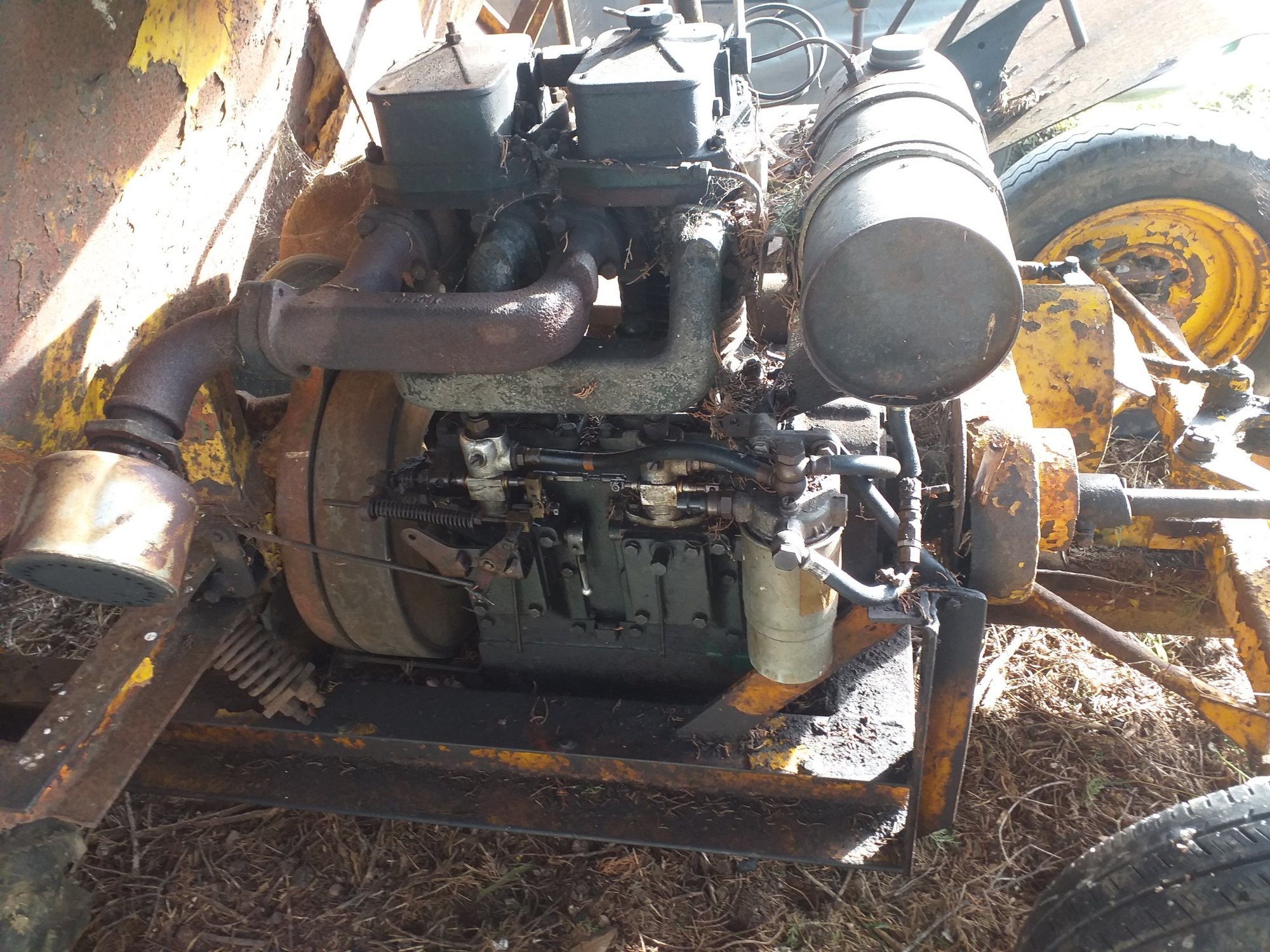

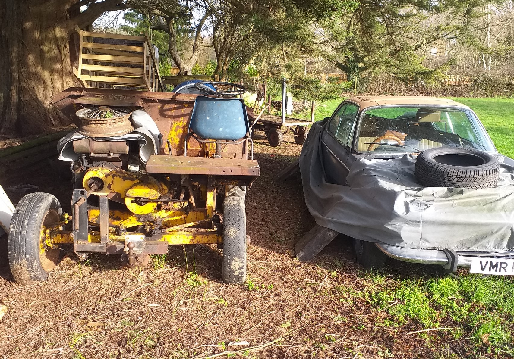

    looks a lot like the one I want rid of, correction, my wife wants rid of!, I cut off all the rusty bits, and left them off, life is too short to start another hobby restoring plant! I already need to live to 120!
    20200128_110911_resized.jpg 20200128_110821_resized.jpg 20200128_111001_resized.jpg
