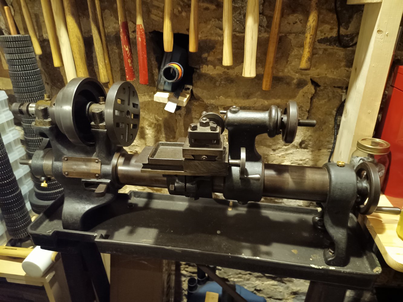

Looks very nice. Got enough gears there?
You still need to be able to alter the belt onto different pulleys otherwise you will lose torque/power when machining large diameters. When running the motor slowly for long periods you reduce the cooling so you could overheat the motor.VFD should eventually arrive next Tuesday , I'm going to bypass the counter shaft route and go direct from motor to the pulleys on the lathe ,should work okay ....right ?
Sounds like you need to put an extra gear in or take one out of the gear train.Roughly set up the gear train , when I lock the leadscrew the carriage move away from the chuck , am I missing something in the setup![]()
Cheers MartinSounds like you need to put an extra gear in or take one out of the gear train.
If I remember right roundbeds have a right hand thread on the leadscrew which is the opposite way most other lathes turn. Which means your gear train needs to finish turning the same way as the chuck is.
(I might have just made that up!)
Crash proofing for beginners, the other way invites clouting the rotating jaws.Roughly set up the gear train , when I lock the leadscrew the carriage move away from the chuck , am I missing something in the setup![]()
