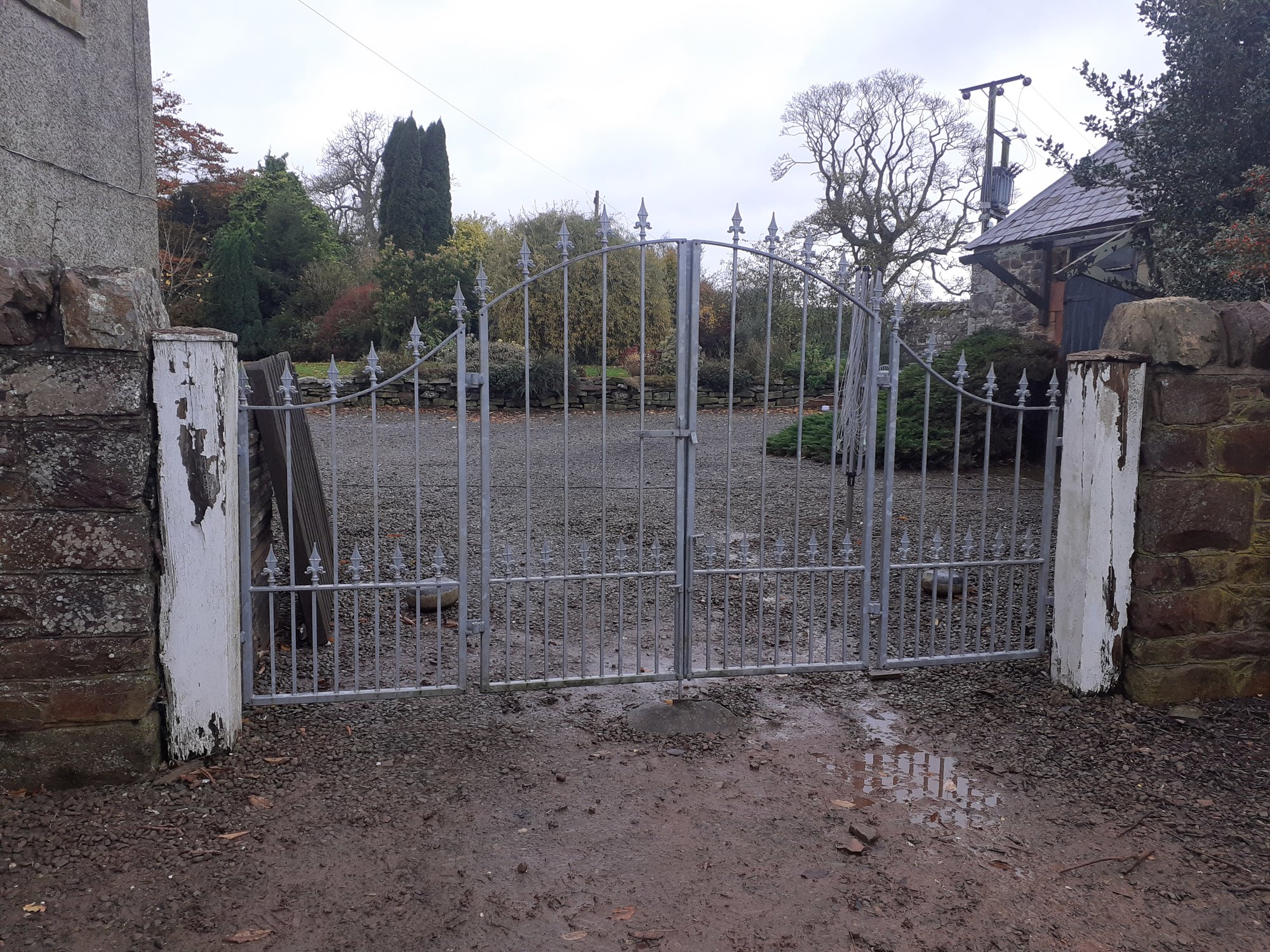

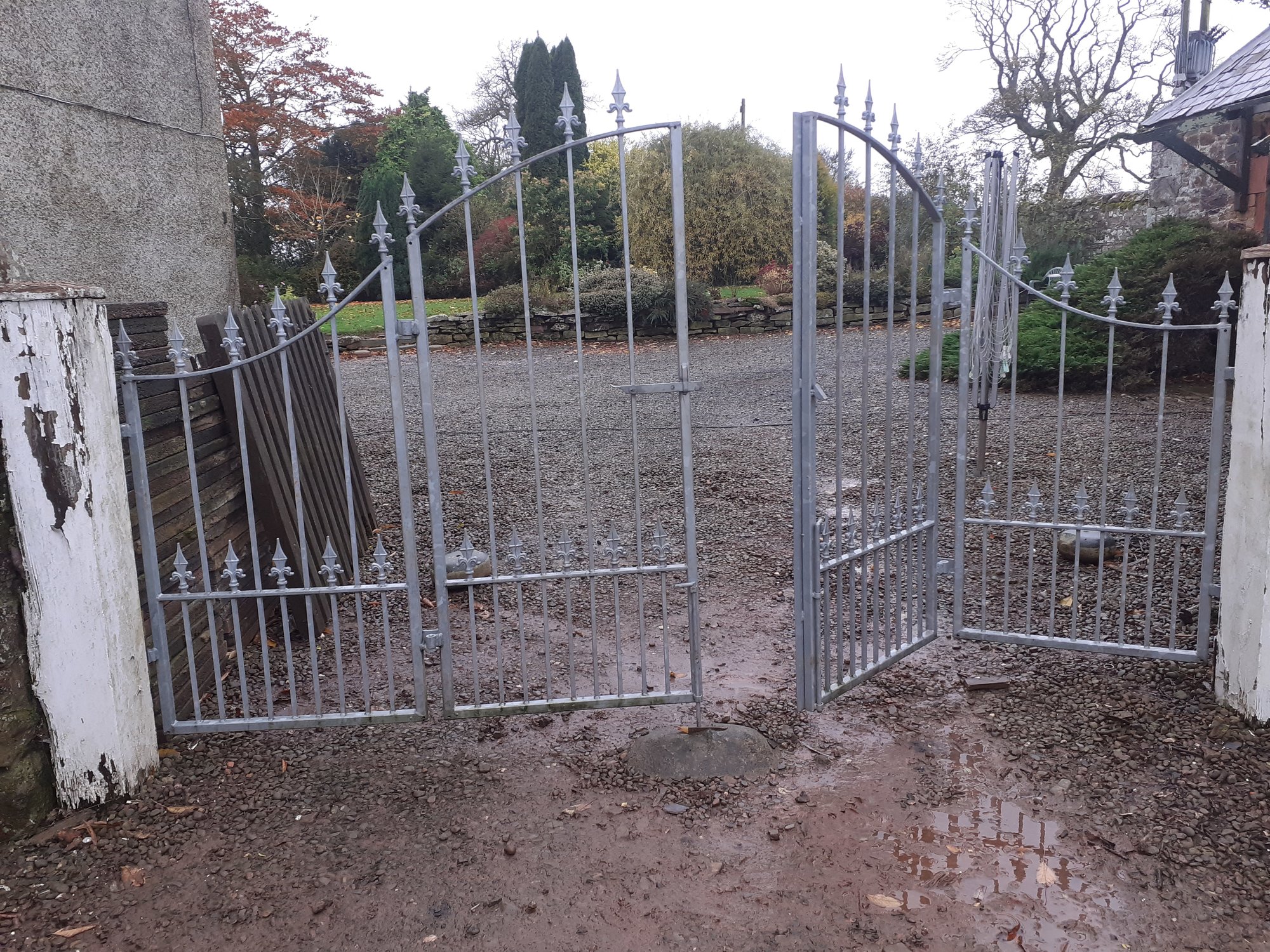

    Bought these on gumtree last weekend and as you can see, hung in the dark:cool:, already used the room to sag excuse and got away with it:thumbup: but only her pals seen it so far:D. 30mm box over 10ft seem strong enough, needs some pillar work now.

    If the gateway's flat and level (mine was when I did it, concrete drive) a caster helps... I had to turn mine from 2 separate hinged gates to a single folder so I could get my sorely-missed camper van down a narrow alley (an opened other half would have made it too narrow) so put hinges on the back wall of the house, hinged the second gate to the first with a caster/swivel wheel in the middle (oddly similar to a supermarket trolley wheel...), no problems with sagging! Could make her "access" gate the same way, put a caster where the two hinge together?

    Steel alone would have cost a bit, never mind bending, building and galvanising.
    30mm box just about strong enough 40 would look beefier but angle a non starter, will be wobbly imo.

    those are nice gates ,you did well .obviously you dont have to reply but what price did you pay as if you can get them from places like gumtree @ reasonable price its not worth making them, as long as of course they are not lets say warm

    No problem arther paid £120 for them definitely not hot, saw the gap they came from, also included a length of railing to match and a post, not long moved in and he was needing a wider entrance. Definately well made smiddy gates, not mass produced.
    Was going to have a go making gates till I saw these, don't think you could make them for that as a business anyway, theres a guy in town makes a lot of gates advertises on Ebay, he's 3-5 hundred for parallel gates, haven't seen a price for arched.
    The beauty of those as bifold is they fitted in the car, don't have a towbar.
