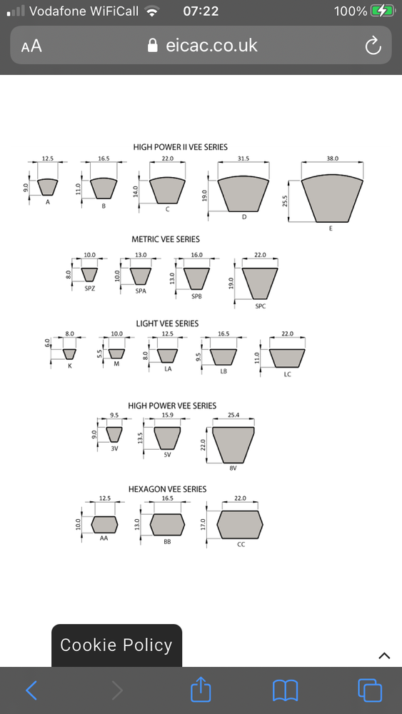

b is the thinner of the 2. i use twin b on my latheYep A or B
I will measure up in the morning

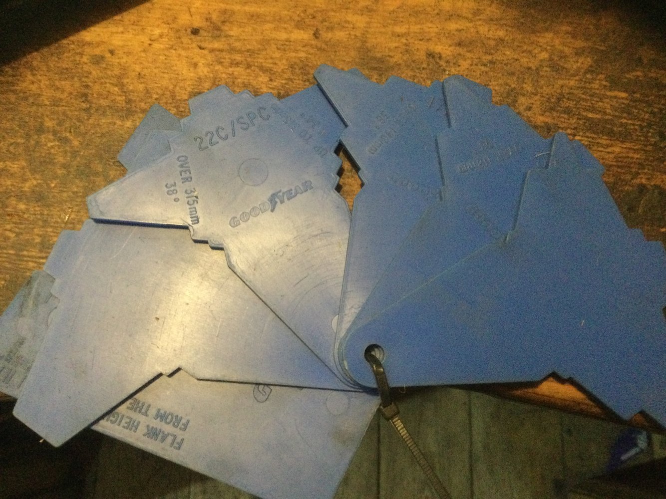

I will ask dad. I’m sure he will have one somewherePlaces like Bramer sell these V pulley gauges, takes the guessing out of belt identification.
Still might not stop you losing them!Never put your fingers where you wouldn’t put your willie!
No it isn’t - A is thinner than B section.b is the thinner of the 2. i use twin b on my lathe
