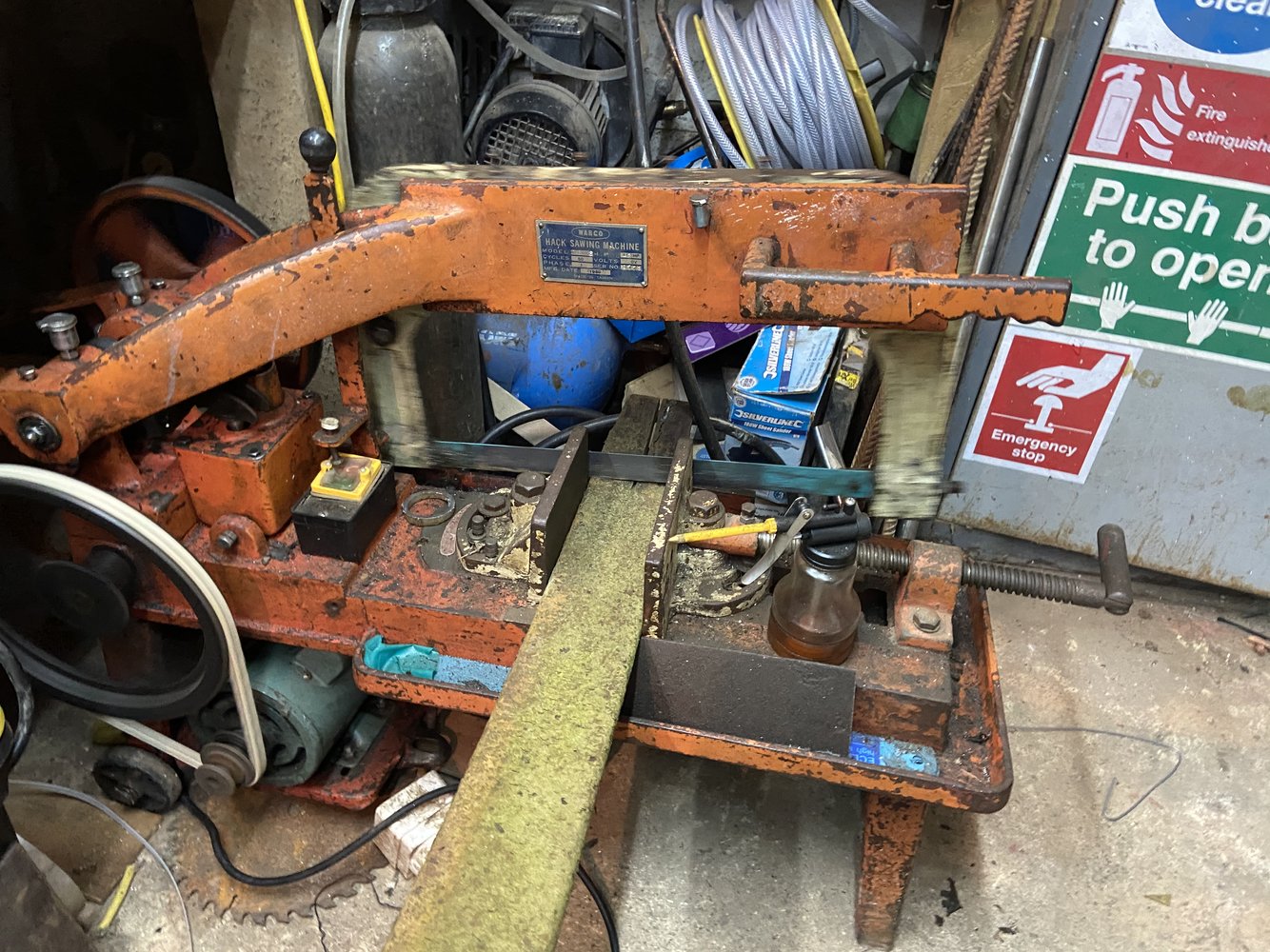

Trust youA new belt?![]()

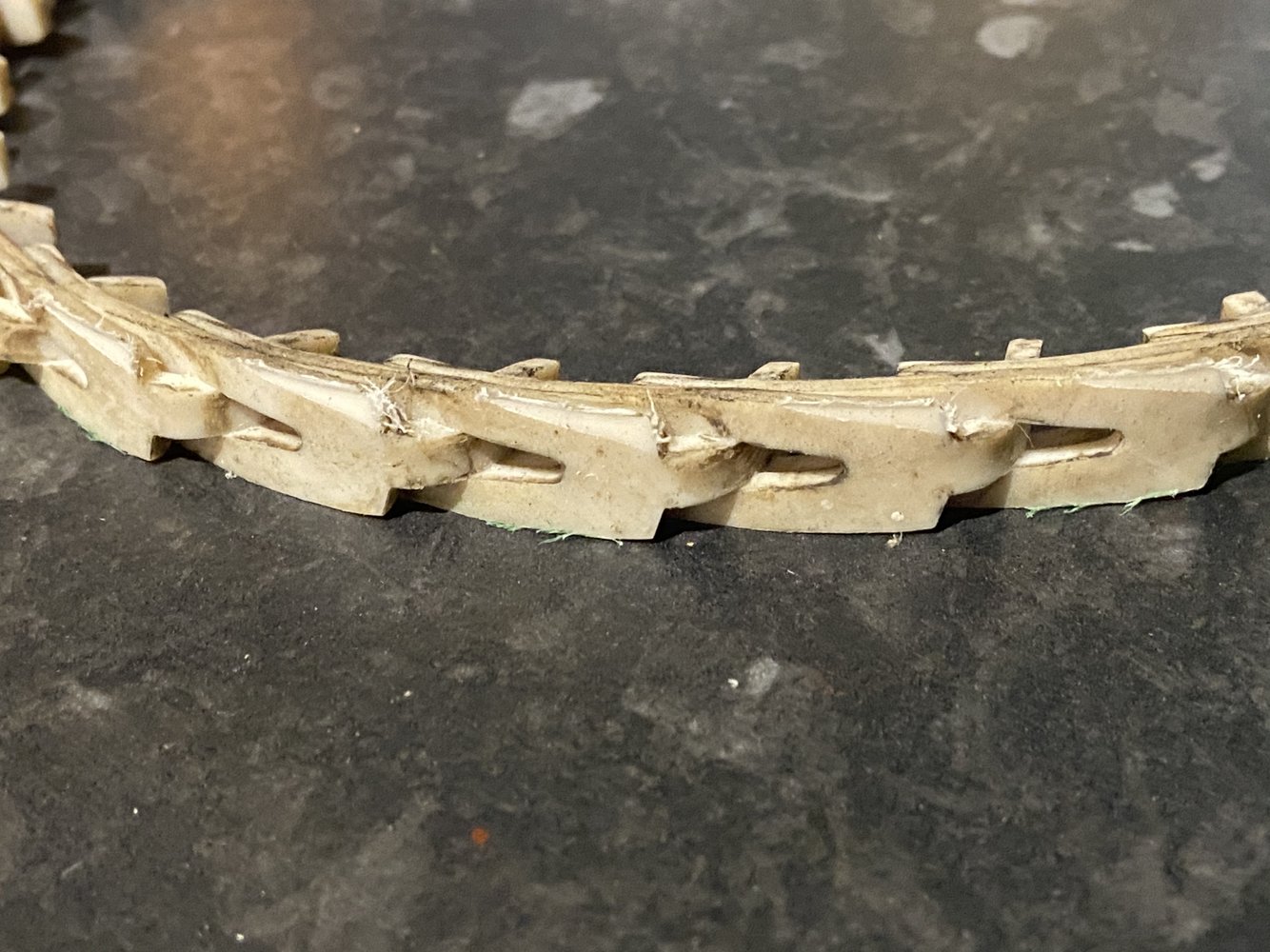

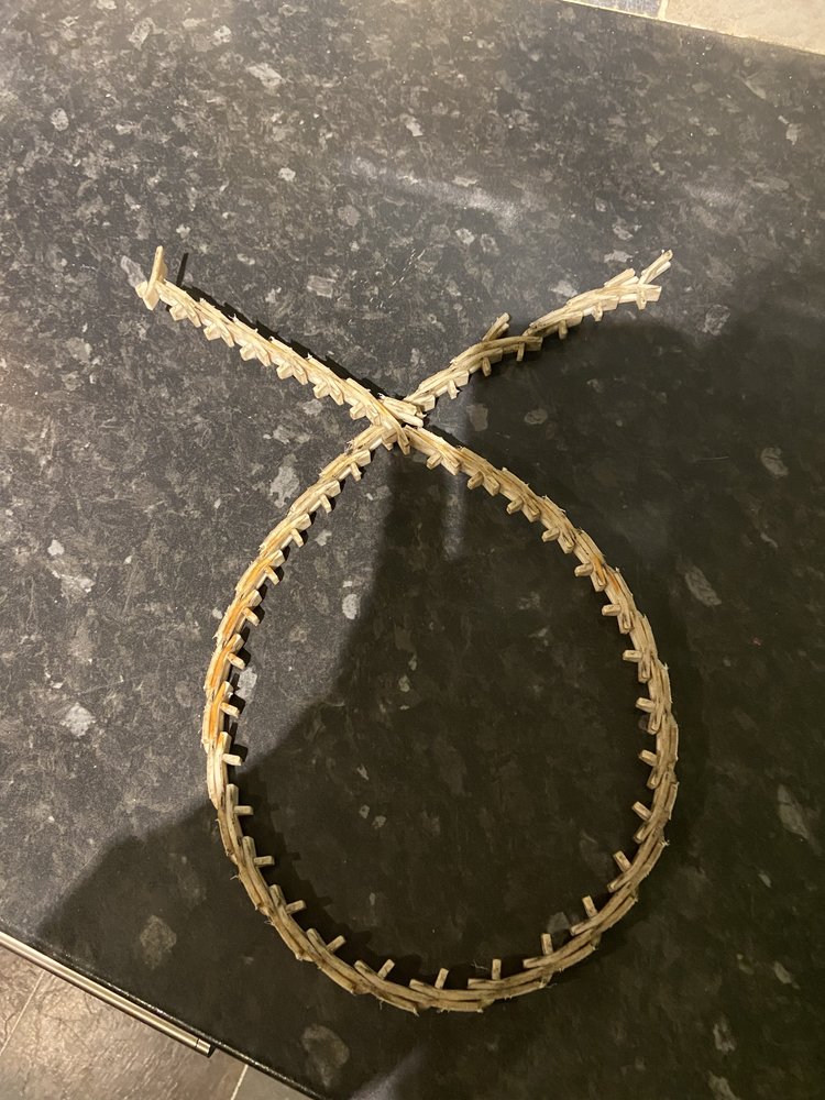

I will need more help, I’ve never bought a machine belt beforelinkbelt or just buy a solid one you need the section profile though
If you’ve got the old belt intact measure it’s entire length and the width of the belt.I will need more help, I’ve never bought a machine belt before
I’ve got the old belt. It’s snappedIf you’ve got the old belt intact measure it’s entire length and the width of the belt.
take it to a bearing and transmission suppl;ies they will match it for youI’ve got the old belt. It’s snapped
Yeah - lay it out and measure end to end - that will give you the length required (roughly). The width gives you the section required. As said above it’ll likely be an A sectionI’ve got the old belt. It’s snapped
Measure the length of the current belt that will give you the length you need.I’ve got the old belt. It’s snapped
Or thisJust link it together for now with wire..get you over the holidays![]()
