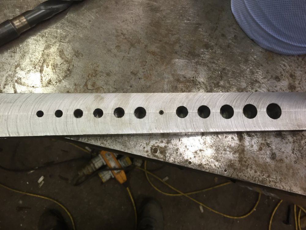

Wire stripper I assume ??I got the holes drilled today, it was mutch less complicated than I expected.

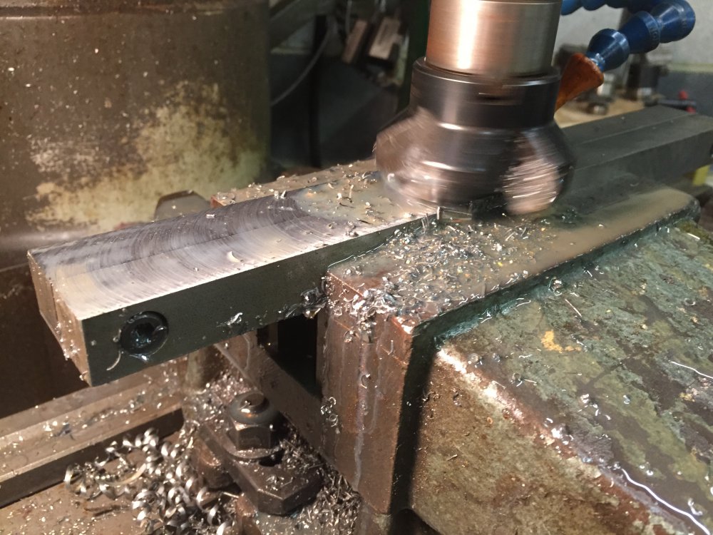

First I dowel'd and bolted the 2 pices together then skimed each side to give a nice flat surface to work from:

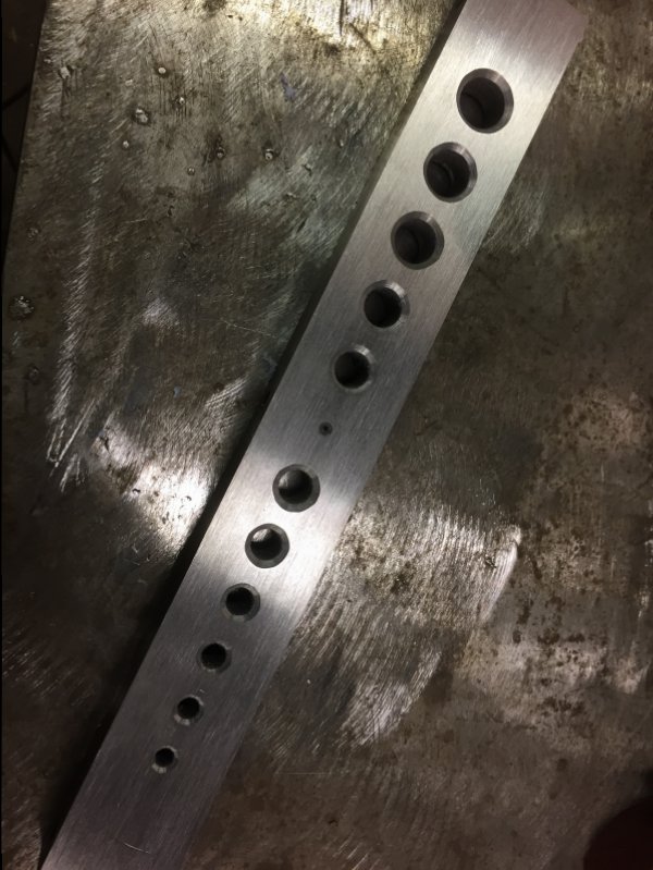

Next I centre drilled, pilot and drilled each hole, and it didn't seem as though it was 2 pices of metal, very happy.
once faced they are easy to work on, good shell mill there.
you need to tram that head a bit better tho.
