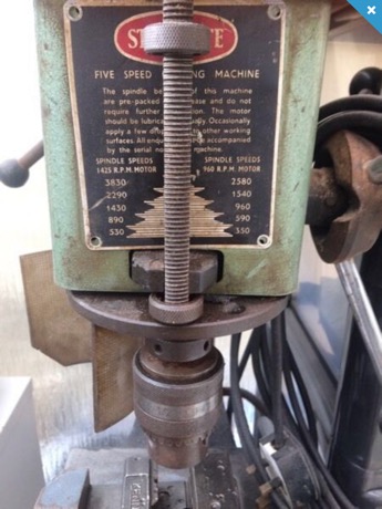

Sticky pin ( a lump of plasticine and a pin !)No actually it's a Startrite mercury mk11 it was more than a tenner but it was about a mile out of my way on my route home from work if that counts
I don't believe it has a taper quill just the rohm chuck pops of a small taper on the end of the quill using that knurled ring with the 2 holes
Again if anyone knows different speak up

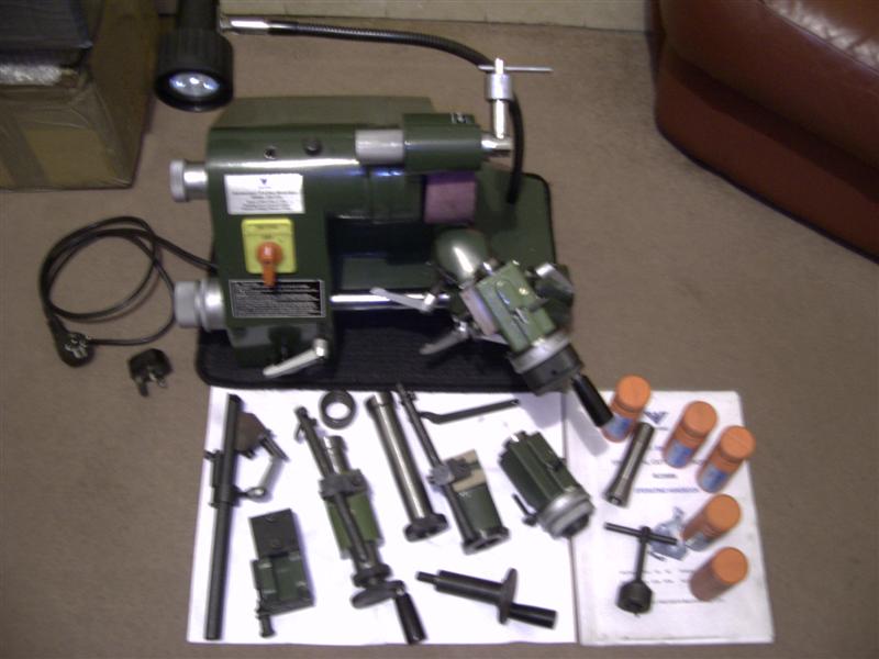

Yeah, maybe I should keep my mouth shut too. I just picked this up today. It has attachments for sharpening Mill, Drill, & Lathe cutters. Won it on ebay.
That's nice mate is it a lisle?
, import model.It's a big issue for me especially with tapsIf it happens on occasion, I just tap the base of the drill and the bits fly off; not really an issue for me.
