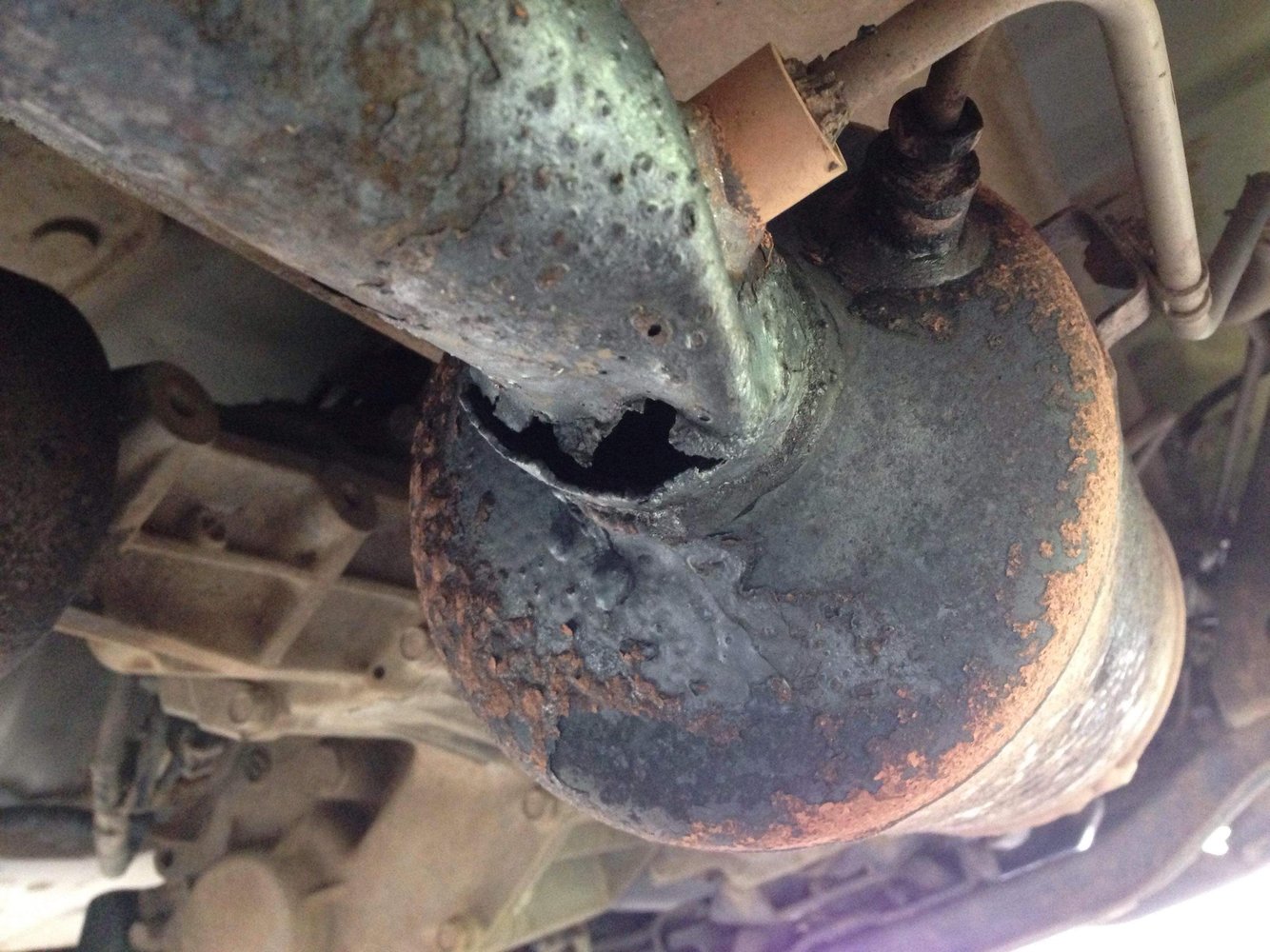

Or at least until you know what the problem was/is,Possibility
Probably time for a new one!
Disconnect and run up to make sure no lasting damage has been done.
If has blocked and cooked the temps have possibly been put into the egr cooler, turbo, and all exhaust side.
Hole burnt and poked at I would guess. Water was used to extinguish the flames. The truck itself is untouched by the flames. Looks like it had pin holes before yesterday’s events.
Would a pin hole introduce oxygen to the dpf helping a 600deg regen make 1000deg and melt its way around the hole ?
Ive not had to weld any dpf yet or seen one like that
Id check the breakers yards , get a genuine one off a written off L200 for a couple hundred
That looks an expensive mess to me (sorry!)![]()
The above would my thoughts as well.
Chances of getting a good servicable DPF used is thin to nothing I would think!
You might be lucky...![]()
All my thoughts too.
I would be running it up with the exhaust separated in front of the DPF - to see if it has cooked the turbo/exhaust valves/piston rings - I would not wanna be seeing too much blueish oil smoke - before I parted with too much of my hard earned money on a new DPF filter.

Sons got the DPF off it, looks like we’ve been lucky. Not much blue smoke.
