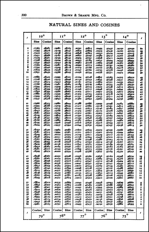

I still have mine. Used daily when I was at school before calculators!Back in school in the 1960's we each had a light blue book of tables of all the trig functions, log, log / log, and anti log (Godfrey and Siddons iirc) - there must have been gazillions of them printed so surely they'll still be around in book shops?
Yes here you go:
Godfrey and Siddons - AbeBooks
Four Figure Tables by The Late C. Godfrey and A.W. Siddons and a great selection of related books, art and collectibles available now at AbeBooks.co.uk.www.abebooks.co.uk
I think we were shown excerpts of these types of books and it was quickly brushed aside.Back in school in the 1960's we each had a light blue book of tables of all the trig functions, log, log / log, and anti log (Godfrey and Siddons iirc) - there must have been gazillions of them printed so surely they'll still be around in book shops?
Yes here you go:
I still have mine somewhere.Back in school in the 1960's we each had a light blue book of tables of all the trig functions, log, log / log, and anti log (Godfrey and Siddons iirc) - there must have been gazillions of them printed so surely they'll still be around in book shops?
Yes here you go:

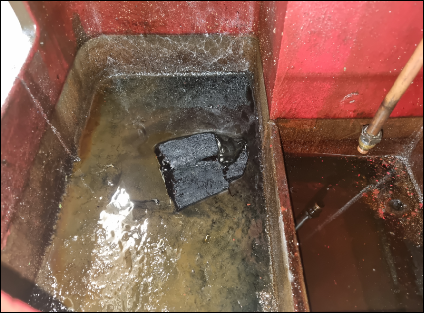

That looks like the makings of a good Christmas puddingEarlier in the day I had stripped out the oil pump and du-gunged the sump. There was no metal in it just the heavier elements of the ol cutting oil had settled out over 30+ years and formed a tar in the base.

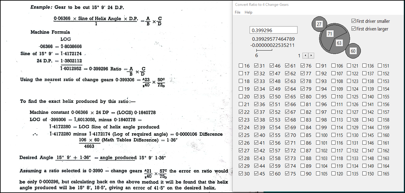

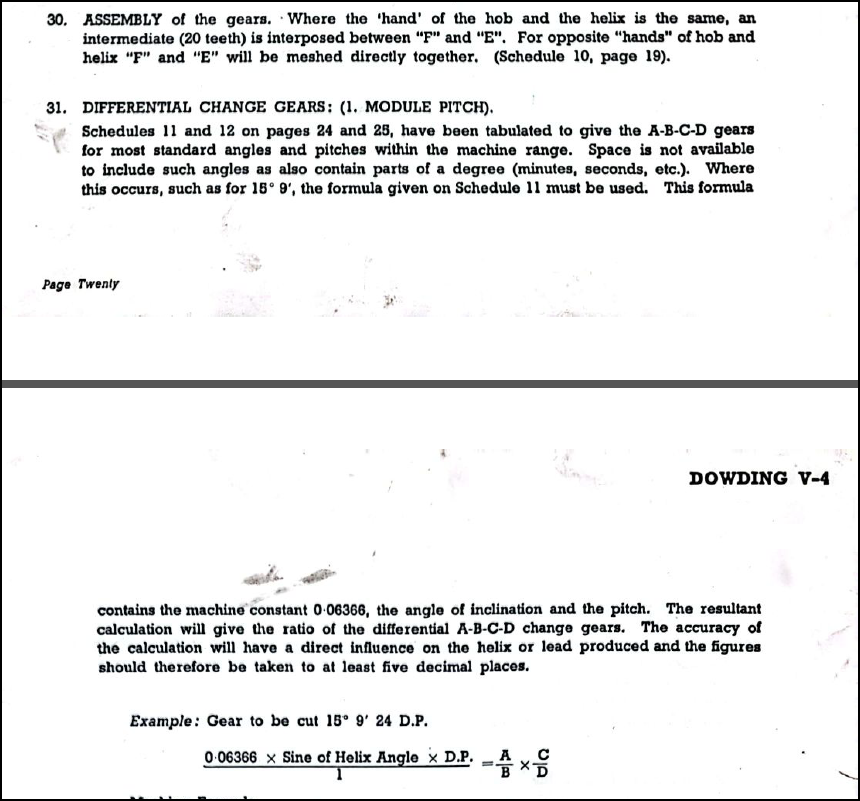

The pitch diameter of a helical gear increases slightly with the helix angle. So if you have two gears at fixed centres (perhaps on a common shaft as in a gearbox) you can fine-tune the mesh/backlash of the gears by increasing or decreasing the helix angle which will bring the gears closer or further into mesh.Can someone tell me whether gear helix angles are that unique to their application?
Sorry I can’t think of a better word to explain. The gear in Pete’s example using the calculator he has found has a helix angle of 15.15 degrees. Would this be something you’d encounter commonly? Why would this not just be 15 degrees? Pressure angles seem to be set to standard angles what does the extra .15 gain?
My naive first impression was that there would be the fixed gear sets for whole degrees (which I think is what it says in manual) and bobs your uncle helix away my friend.
(Apologies in advance for expressing an angular measurement in decimal hail Mary’s have been said)
