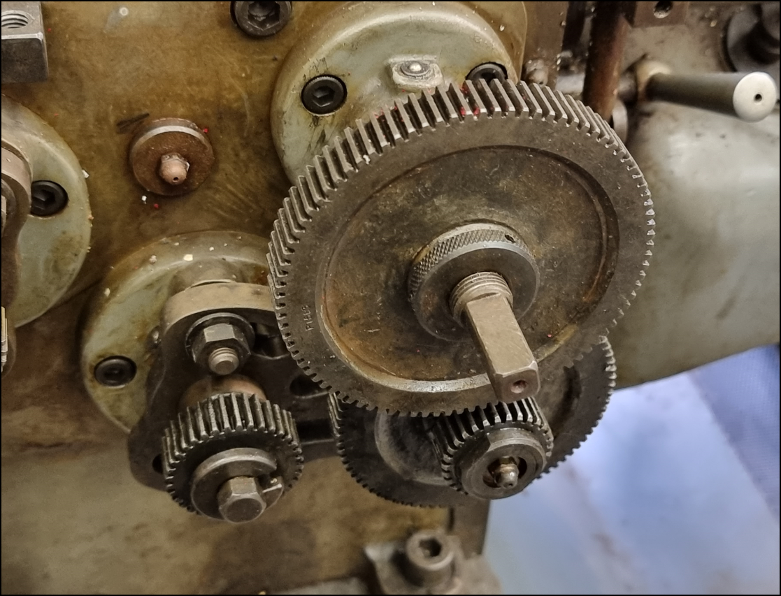

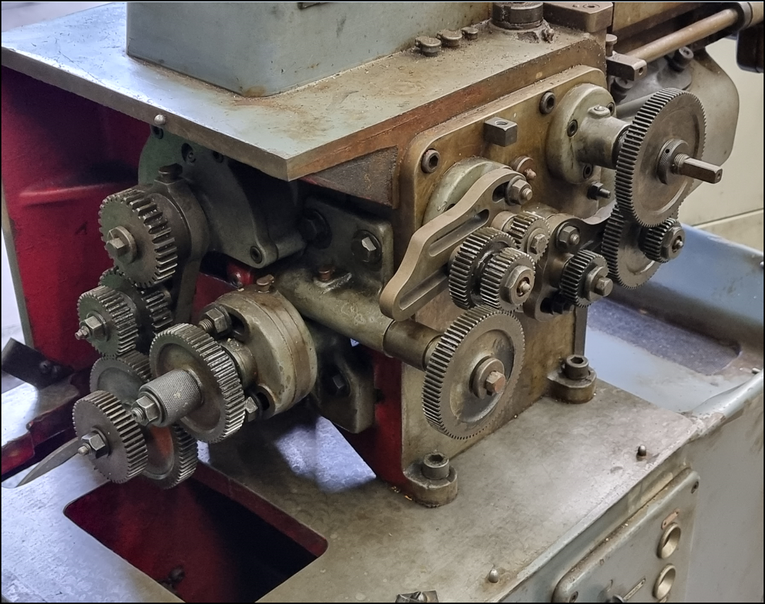

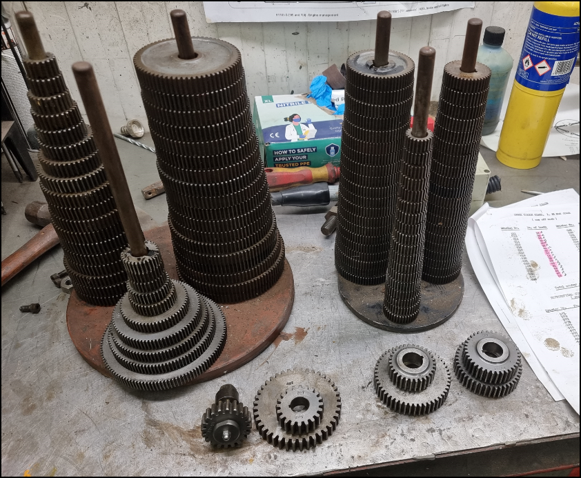

The three sets of gears:
This arrangement is how you set the gears according to how many teeth are on the gear you want to cut. It's the same regardless of whther it's a spur gear, a helical gear or a wormwheel.
This set of gears determines the feed rate for cutting spur gears. Since the teeth are square across the gear you only need to set the feed rate you require to get a nice finish on the tooth, and to give good tool life. The square drive end pokes out through the casing and allows for a handle for moving the feed slide manually:
These are the differential gears. They are arranged (using fancy calculations) to turn the gear blank at such a rate that it allows for the extra rotation required to time to hob and blank correctly when cutting helical gears. This is something I have to learn to do.

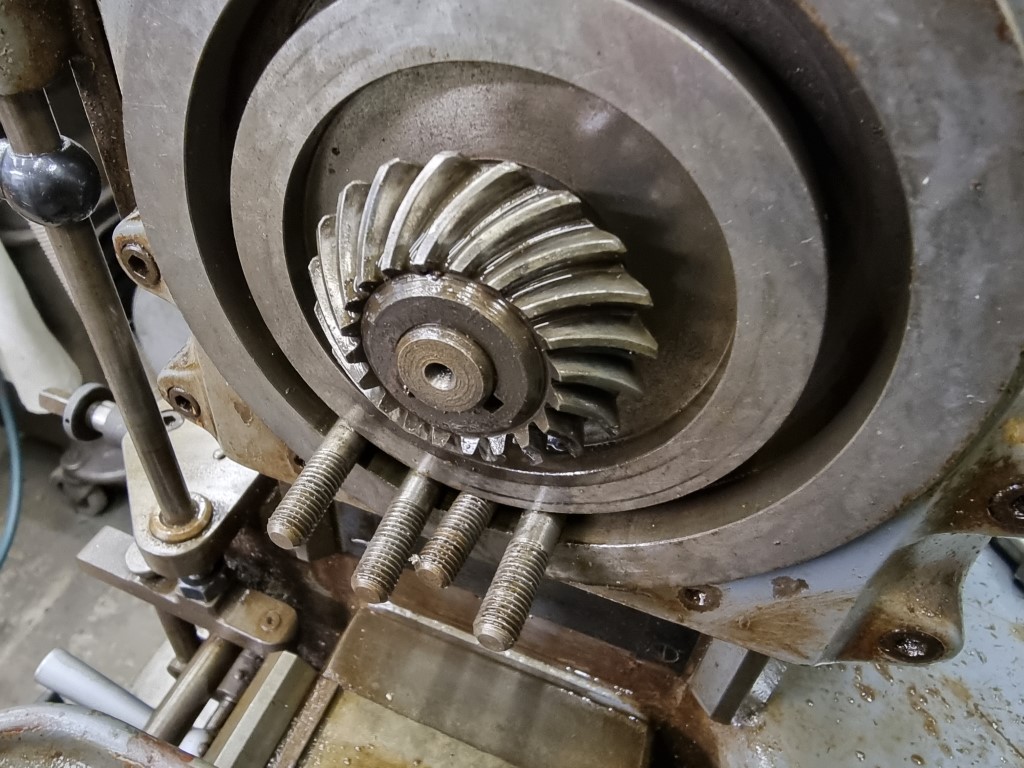

There's a warning in the manual that you must be sure to disengage the feed gears before engaging the differential gears, or serious damage will result. It's a bit like putting your car in 1st and second gear at the same time (if you could) - you're going to mash something up. I suspect that someone has done just this because one of the feed gears has damage in several places:
Thankfully, the damage seems restricted to a few teeth on one gear. I can re-make this one easily enough.
