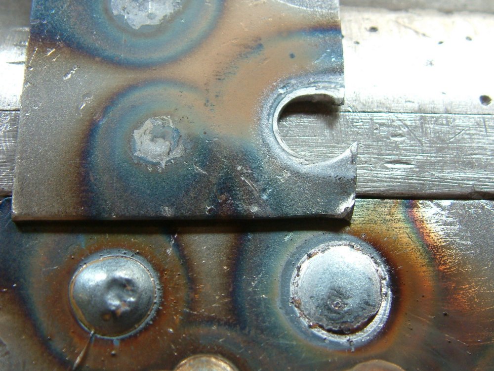

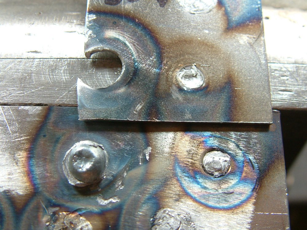

0.6mm. Thought the tip voltages might help give a comparison to your machine as mine is 215A, 34v was setting 7/12. Here's a photo I took sometime back of a spotweld torn apart.
Old Test piece using Clarke CSW13T spotwelder on 1.5+1.5mm mild steel sheet.
