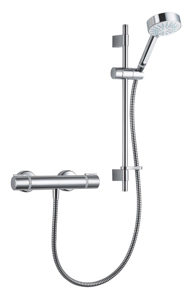

The problem with those adjustable sets is that the bar will end up anther 40mm plus off the wall , then you’ll have to pack the riser bar , if it’s rigid pipe off the wall too . Plus it makes for a good weak point being nudged about , and they will start leaking .
The offsets were really meant for being half buried in the wall … so none is seen once the cover plates are on
Sure.With a slim bar and those dog leg things it would still be a massive improvement over the existing one.
I've installed one of those and just got a second to put in. Happy with the units though they are bigger than you may imagine. Had to reposition the temperature know to suit our HW temperature.![]()

Looks like it comes with the "z" connectors as standard now, it was an optional extra when I fitted mine 7 years ago.
Check the specs/installation instructions.
-There is iirc some flexibility on mounting width.
-quite large diameter cover plates that will hide a lot of things.
-might look too big in a 700mm shower?
