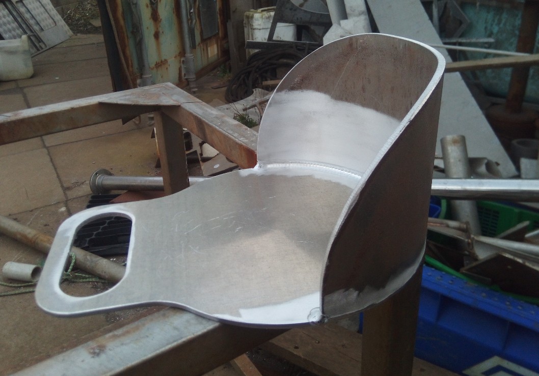

You need to make yourself one of theseplanning to do this on monday just getting the thing in the back of my pick up seems to be a lot harder than it used to be
