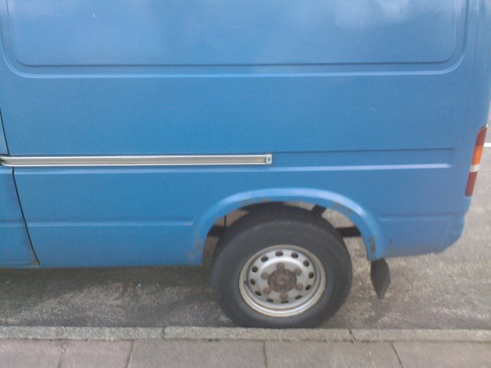

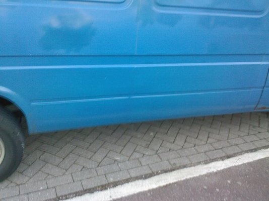

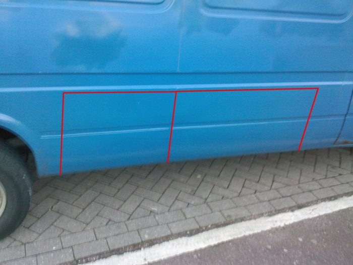

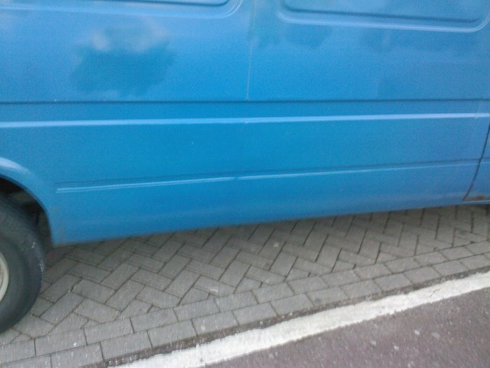

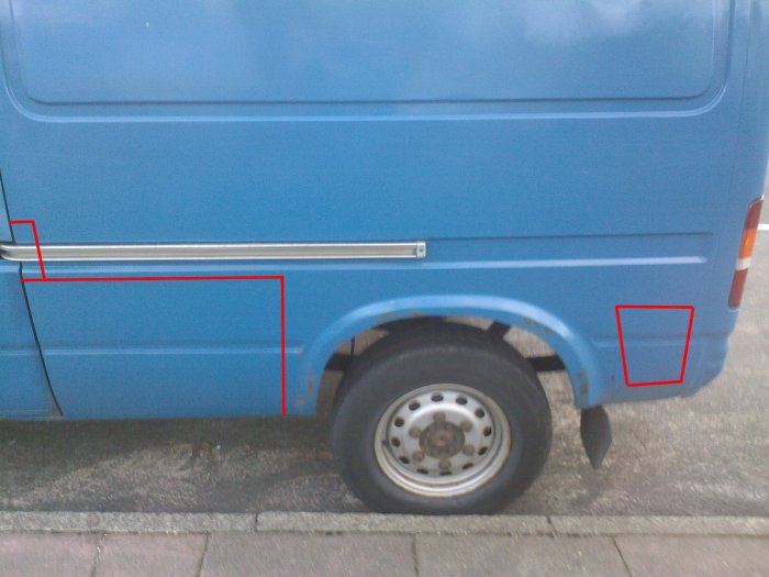

) high power technique is not suitable for use in critical or aesthetic applications, but it didn't stop me playing with this ratio (machine settings + material + user input) the other way around, in replacing the vehicle's exterior side lower quarters.
