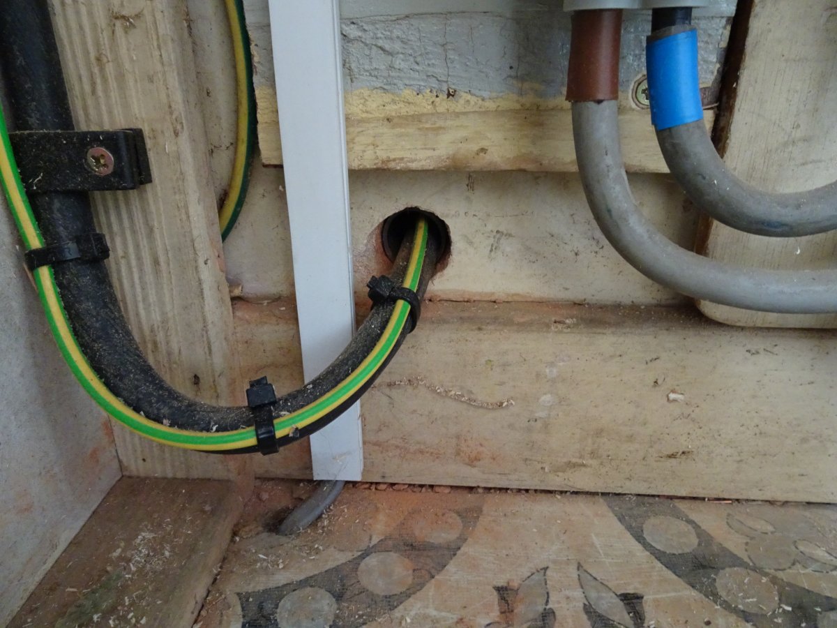

maybe I"m missing the point here, they've done a poor job, so why not get them back to sort it correctly. You've paid them for the job, they've not done it to correct standards which you have discovered later, are they then not liable to rectify the error?
don't see why it's down to you to rectify this, when you've used professionals...
edit - then when they've sorted it correctly use that to power the garage...
I don't know the regs in the uk anymore, last one I did was the 13th edition IEEE so probably fair to say I'm well off the pace these days.. to me it's not right way, and certainly seems wrong for the reasons given above, but is that "official enough" I don't know. Surely one of our professionals on here could confirm if it's acceptable or not to the standards, citing the relevent reference to the regs? presumably if it was inspected officially they could give a report..
went to connect a new cooker hob up last week replace the old one and some nerd electrician wired it in 10mm when 6 would be well adequate .he had shaved the cores down to 4.0mm to get it connected the punter whose house it is was going to connect it himself and thought better of it I just stuck a jointbox on the end of the 10mm and reduced it to 6 mm and no botherWhen you take them out check if they’ve given the copper a haircut to fit them in.
luxury last month replaced a hob that had 1.0mm flex a meter long and a burnt out conector plate don't think they must have used all 4 at the same time because it was like that for a few years I see that many balls ups 2 many to listgotta be better than the opposite - wiring a cooker with 2.5mm t+e - which i have seen on a job.
