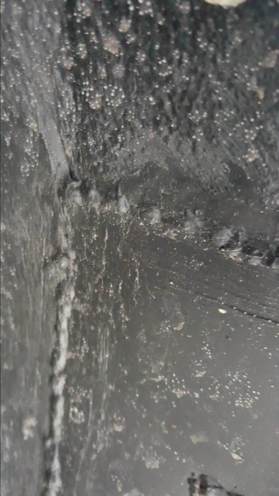

^ Looks like they've finally clarified the wording which states that patch repairs including flanges which were originally spot welded can still be spot welded and don't have to be continuously welded.
I've lost count of how many times I've explained that on here and been disagreed with.
nope just look with you ministry supplied, x ray eyes
and guess
took it back and guy said fine and it passed

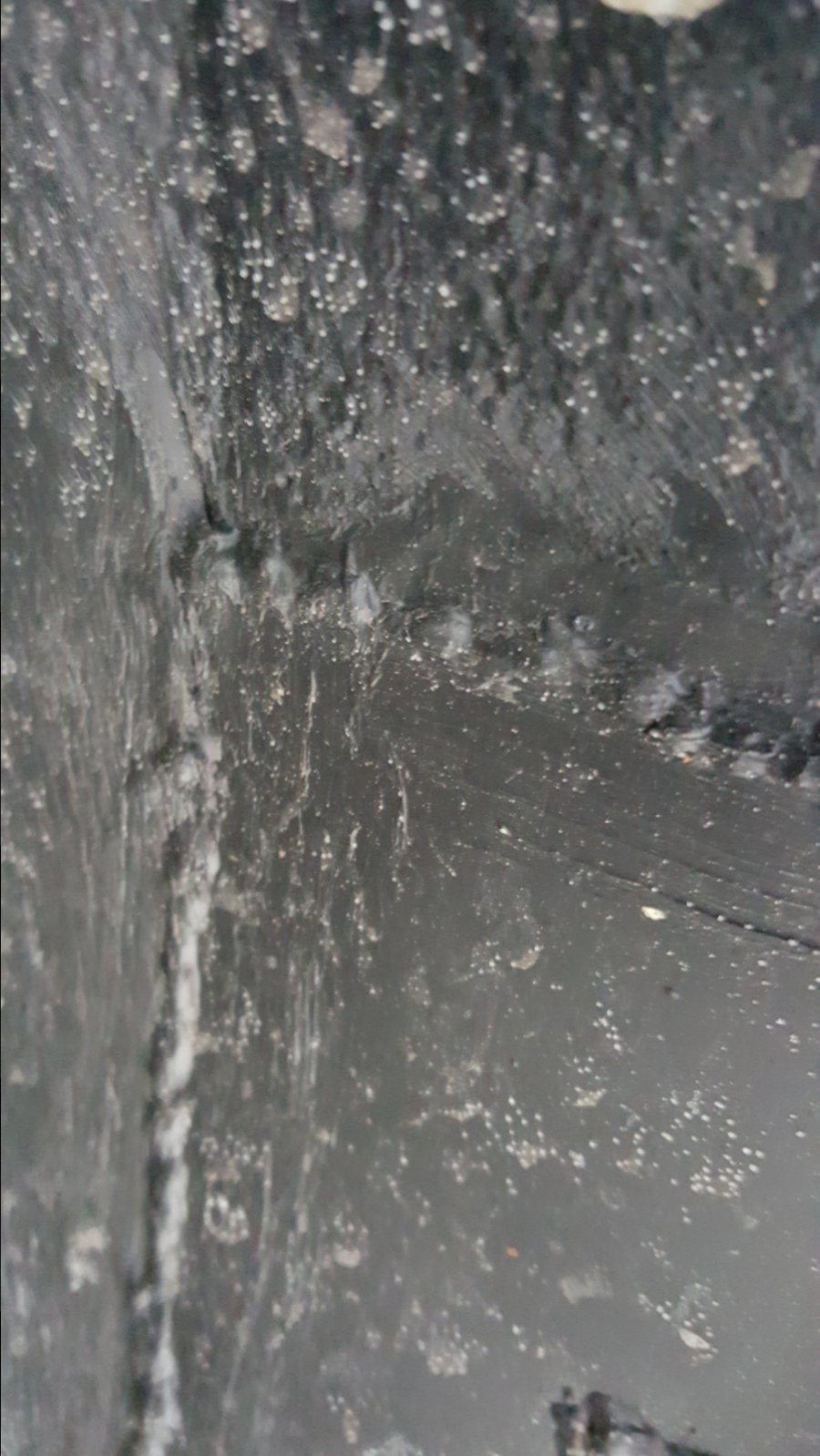

just to pick up on this point made by David 2015, it's really hard to see from the photo that I took,the bit you've highlighted far right is where the underseal had lifted, the Elongated "c" shape you've highlighted at the front was seam welded from above, the big blob on the left is where I ground back and the mirror finish looks like a hole, and the other bit on the left if you look closer isn't part of the same continuous weld, since this repair I've invested in a decent esab helmet that fits my massive head properly and doesn't get condensation forming between the 2 layers of glass if I breath on it twice,
