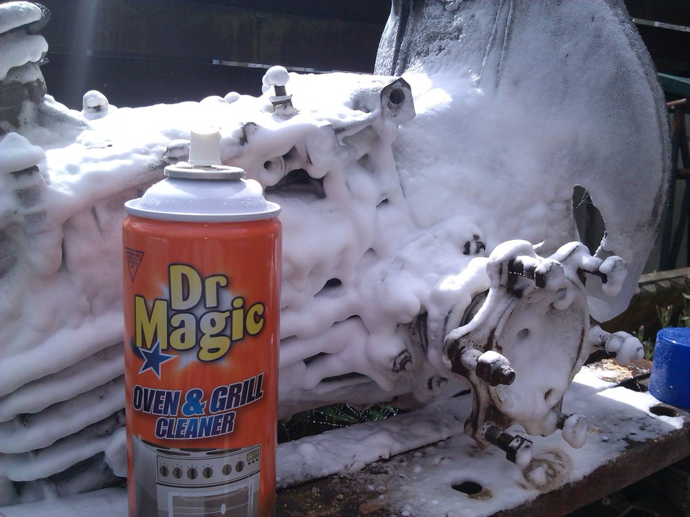

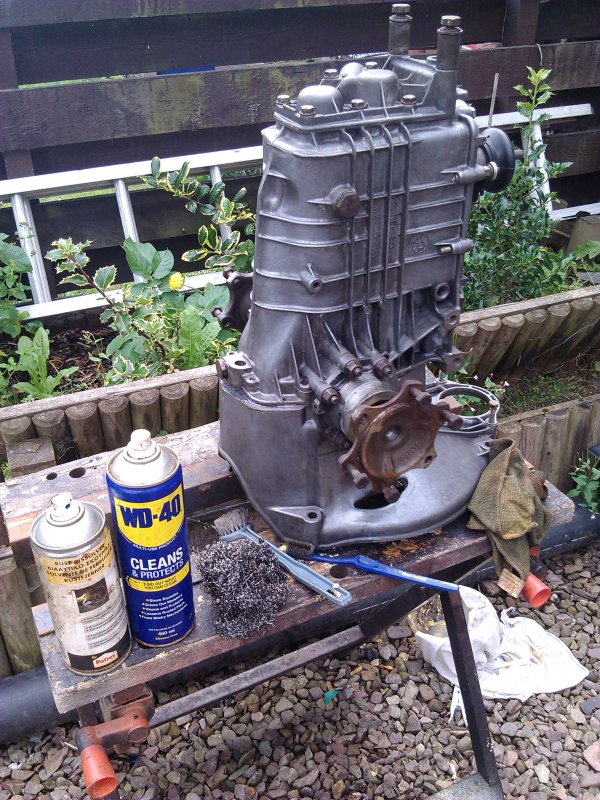

Dish washers are rubbish - look under the sink for some oven cleaner i jest not Ok it says "do not use on aluminium" - but as long as you dont let it dry, rinse it well with hot water and then spray with WD40 to get rid of any residuals then it brings machinery up a treat - manky black gearbox 30 years of clutch and brake dust as well as oil
Oh and its designed to cut through veg oil - might need some help from a scourer ( usually found near her oven cleaner)
