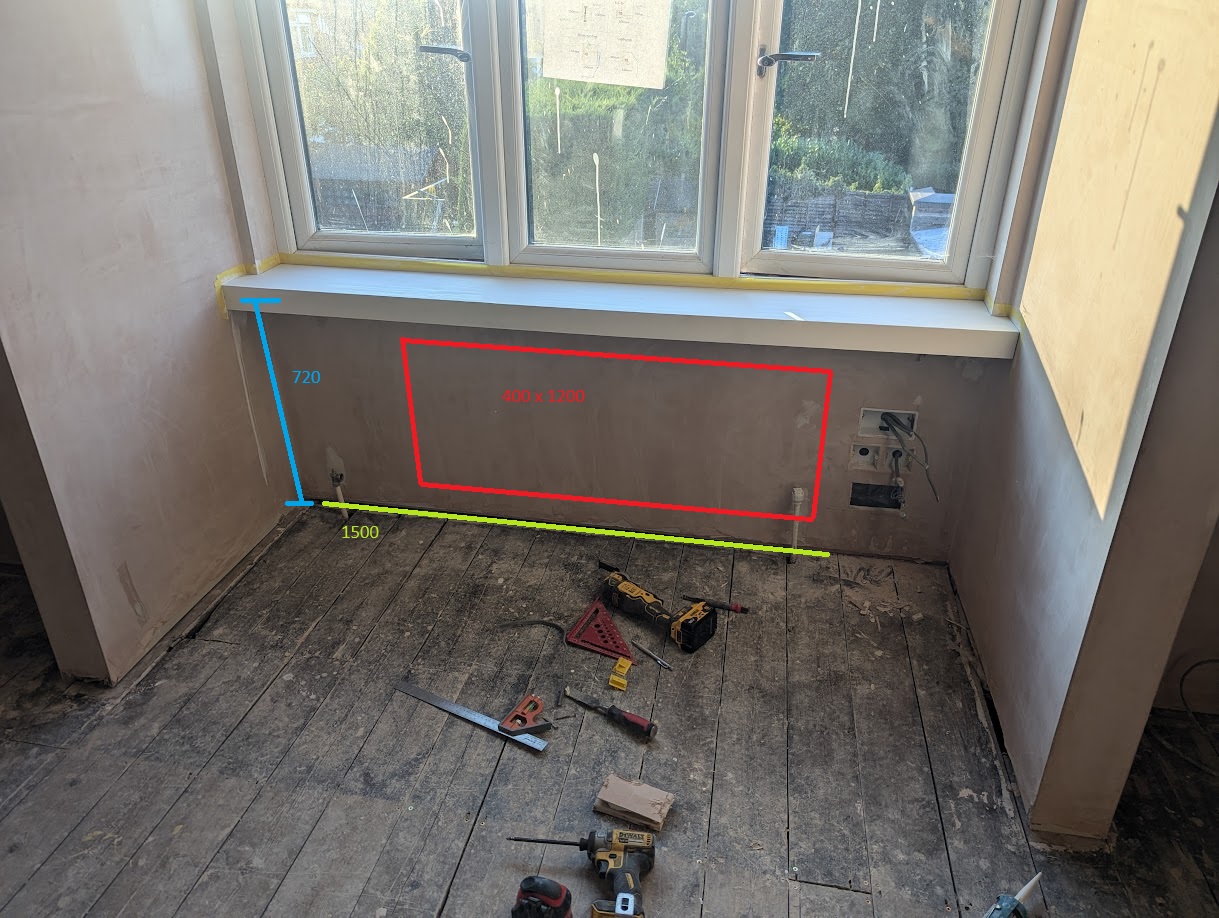

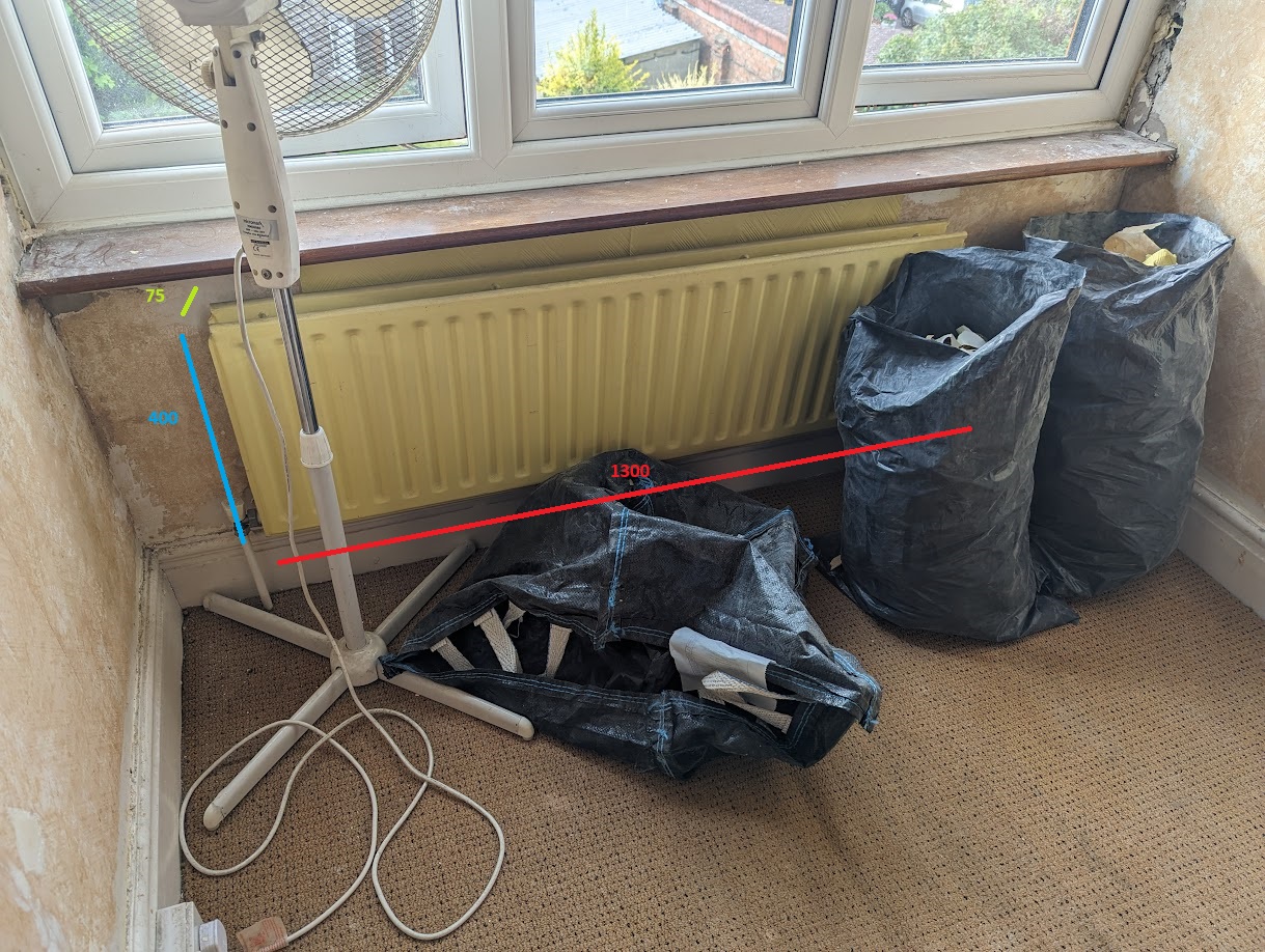

From past experience I'd first check that the original plumbing hasn't been fitted by a muppet...on my renovation the 22mm copper came out the boiler....then dropped down to 15mm with no lagging. No amount of radiator upgrading would have helped in this case and I had to redo all the plumbing!
If the plumbing is good then just measure the room and size using an online BTU calculator....no point guessing.
