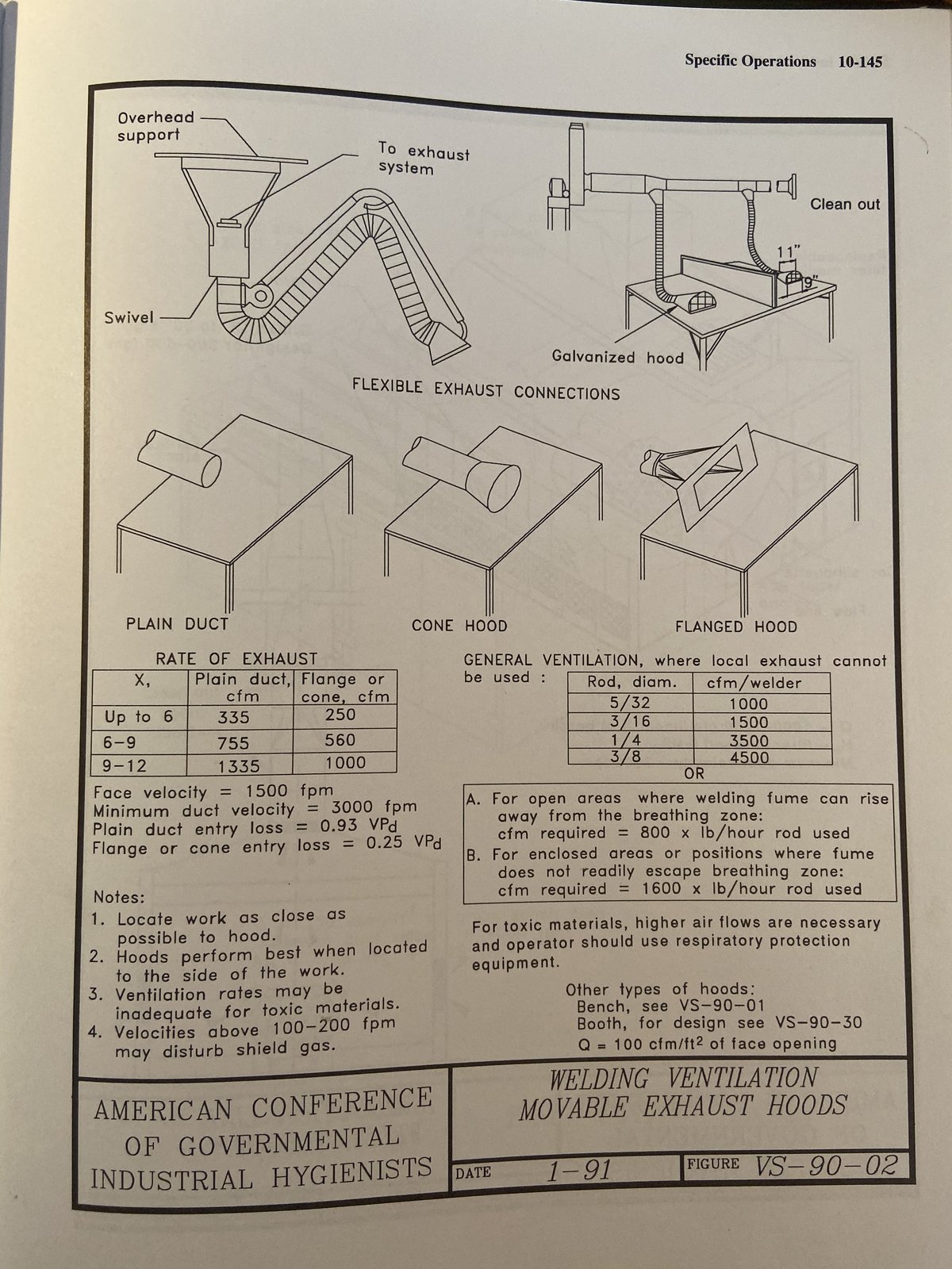

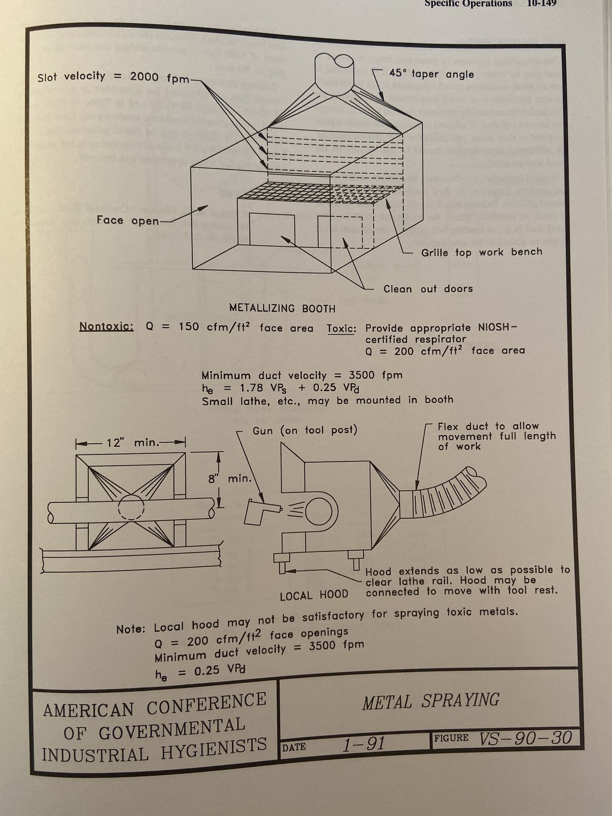

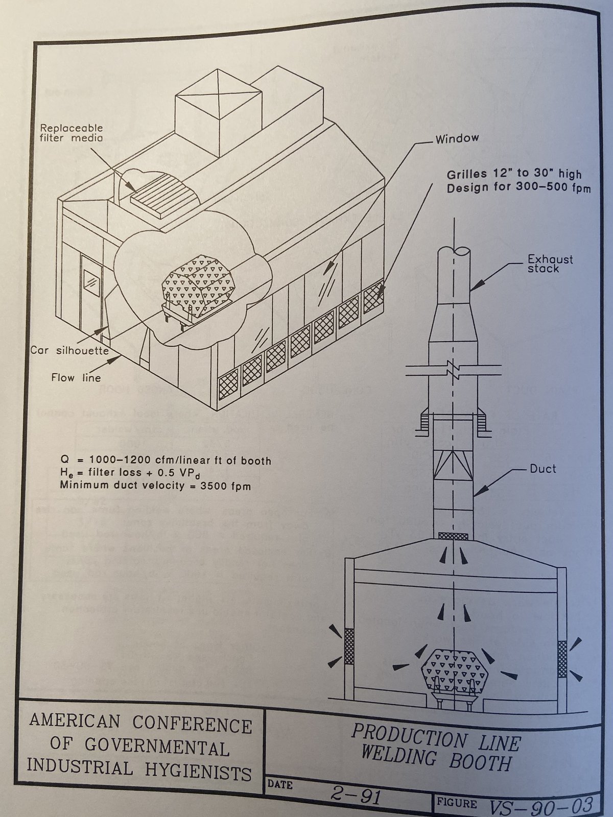

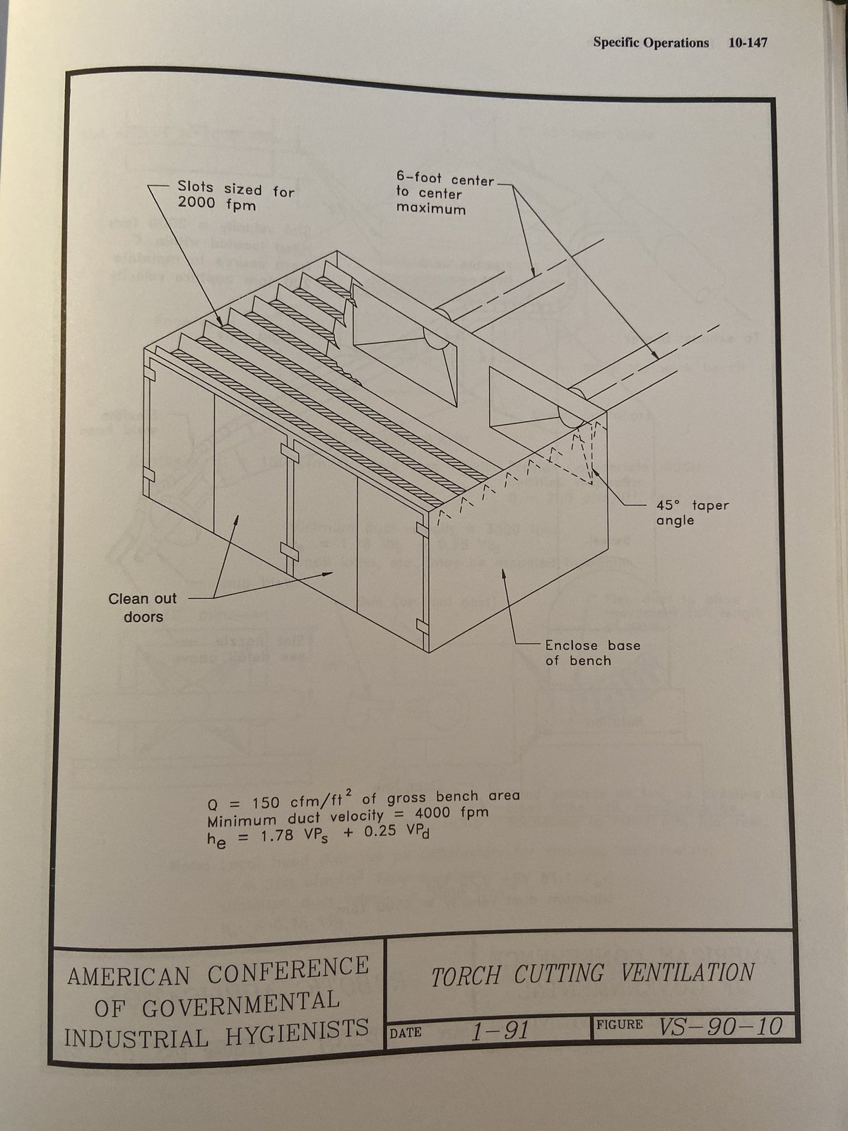

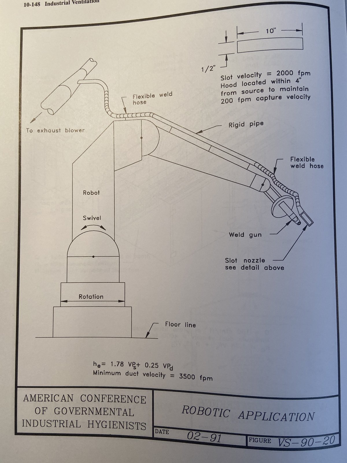

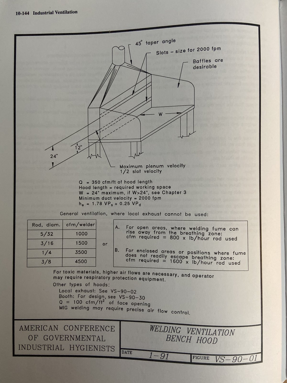

Here you go @Yamhon
Was being lazy and didn’t put the book on the scanner, some relevant pages photographed
This is the bible of industrial ventilation and is the bench mark standard. It’s American so units all old fashioned

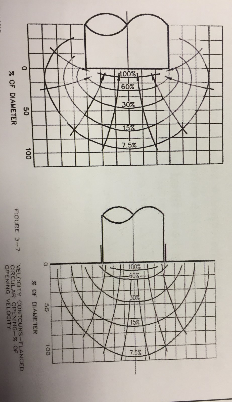

It might be worth considering a cheap hot wire anemometer, or borrowing a good one - perhaps someone at college can help you out.
Weld fume is not my area, but like most extraction the problem is that expectations of how well it works outweigh actual performance. A bit like this:
The fume needs to be captured at a velocity of 0.5-1m/s. At half a duct diameter away you’re down to 30% of whatever the measurement is at the face of your ‘hood’. At one diameter away you’re at 7.5%.
Probably from the same book as Parm
I won’t go into measuring this and calculating an effective range, but suffice to say just having the hood in the vicinity of you’re working area isn’t going to do anything much, and it all comes back to the fan spec and ducting design.
