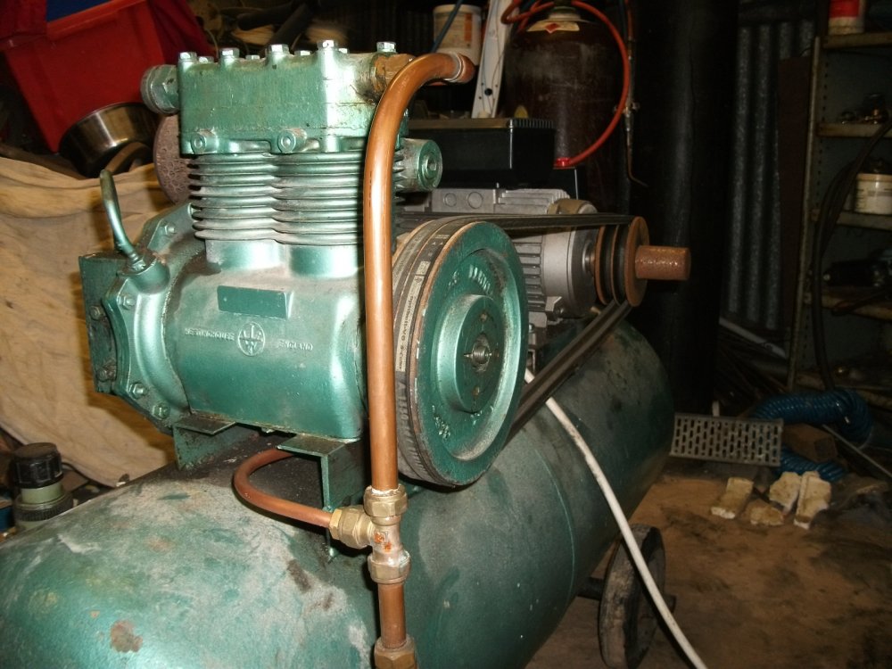

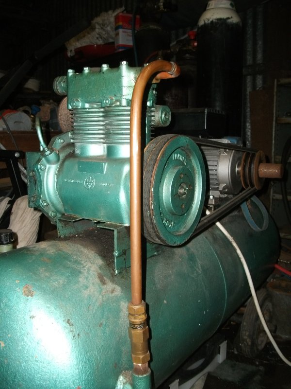

and that only ever got to a maximum of 100 psi (6.8 bar).
there compression fittings and reduce the pipe when they tighten up otherwise they would just blow off if they didnt . the ones on my comp have run to 150psi no problem for years. they may be rated to only 7 bar but there covering there own a rses and actual burst test pressure will be double that
