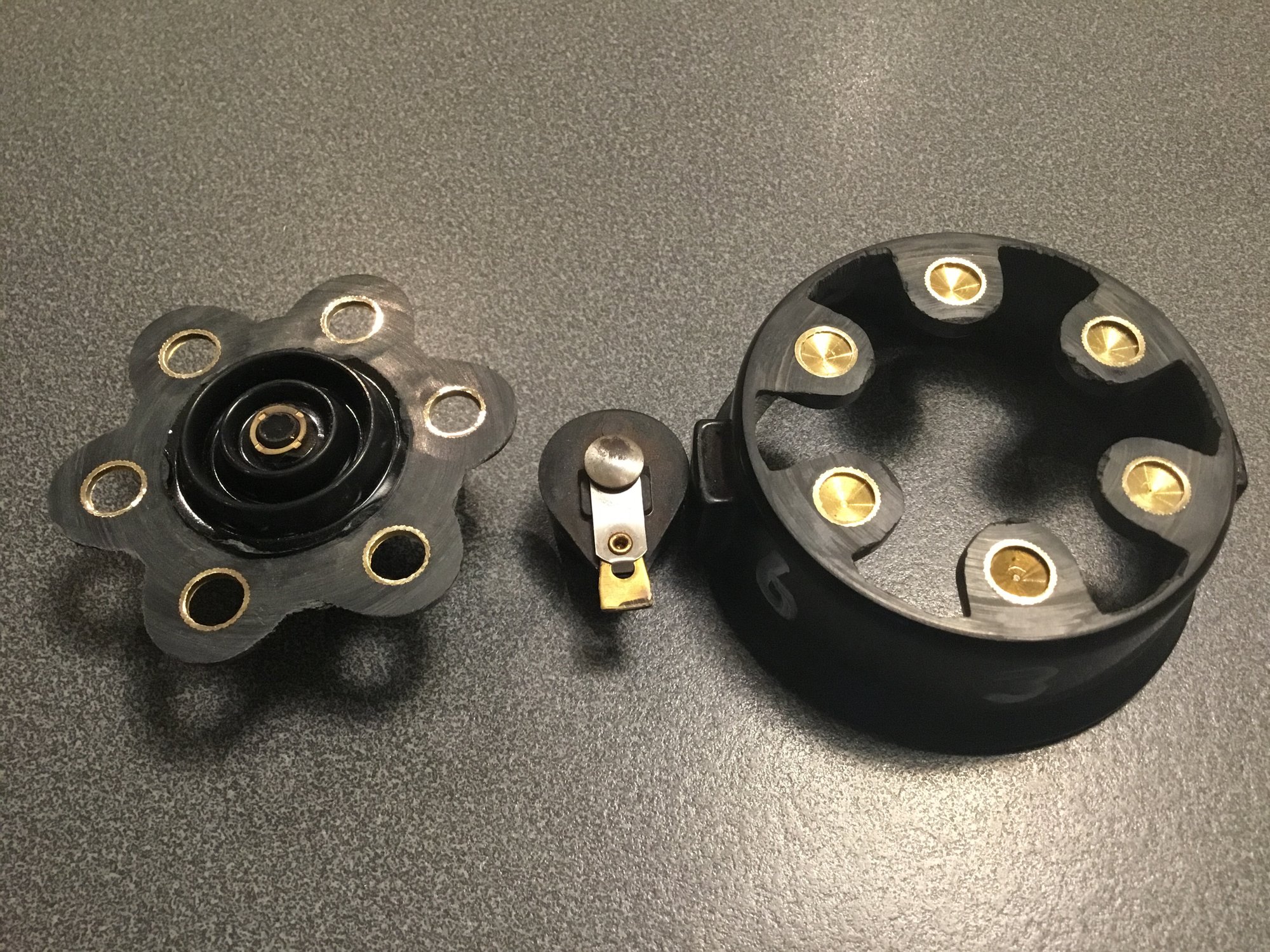

if you was fouling plugs at 25 thou sounds like you need a hotter plug plugs always used to gap at 25thou in the old days and yours is an old motor
would be tempted to order a dizzy cap and rotor arm and condenser from the states
