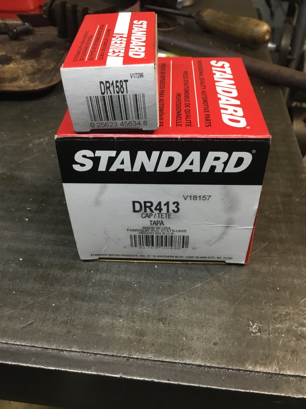

I’m going through Distributor caps and rotors at an alarming rate
. This one lasted 3months.
Symptoms are;
Centre graphite nipple errosion along with heavy pitting to rotor cap top. This doesnt always happen. I’ve checked there is good contact between the two when replacing. It still happens but not always
Grey/black arcing marks to the pickups. Rotor shows little tip damage.
Pertronix ingintion and coil. New leads, Plugs NGK B-1 gap set at 35thou. No vac advance. Wiring is new
Any suggestions
