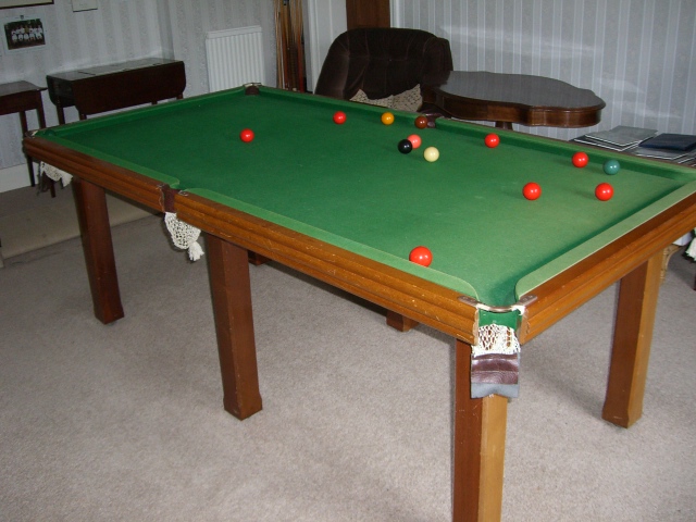

On a table that size slate should be in two section. Remove the top rails, fixings should be visible from under the table. Remove felt (will probably need a new one) remove slate. This should leave a wooden frame that is best remved in one piece after the legs have been taken off.
When putting it back together get it level, install slate, level again and then fill the joint between two slabs with moulten beeswax and scrape flat

Got it dismantled in an hour and home in two. Slate was in 3 bits so comfortable enough for the two of us to lift.
Got it all into my father in laws Citroën synergies. Job done![]()
