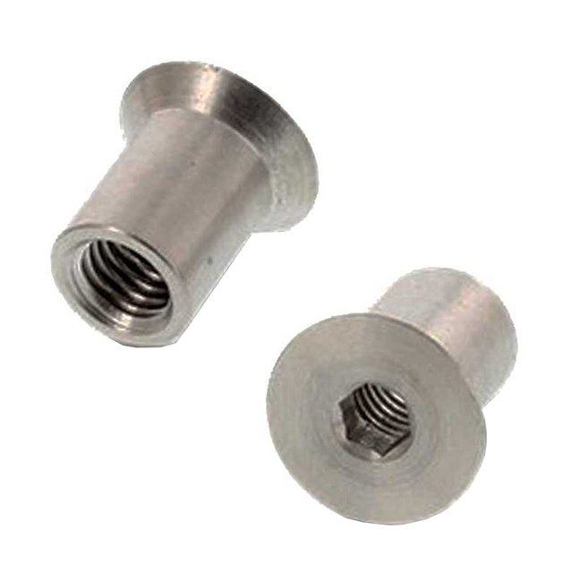

I.have to make a 2m diameter globe for a customer. Due to its size it has to be galved in two pieces.
I'd like the bolts holding it together to be as discrete as possible.
It will be made of hoops of 30x5mm mild steel strip curved along the flat side and doubled up along the joint.
Plan A use countersunk m8 bolts going into countersunk nuts.
I have seen these online. Can you buy them by length? Say 6mm?
Something like these.
I think they are called sex bolts.
Great name
