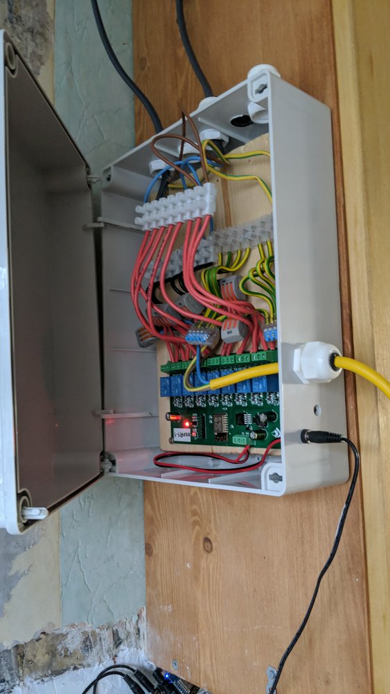

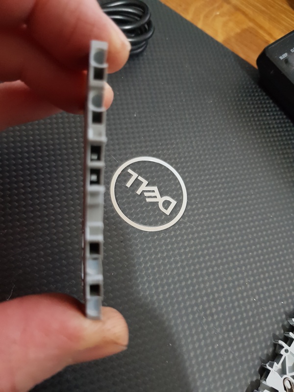

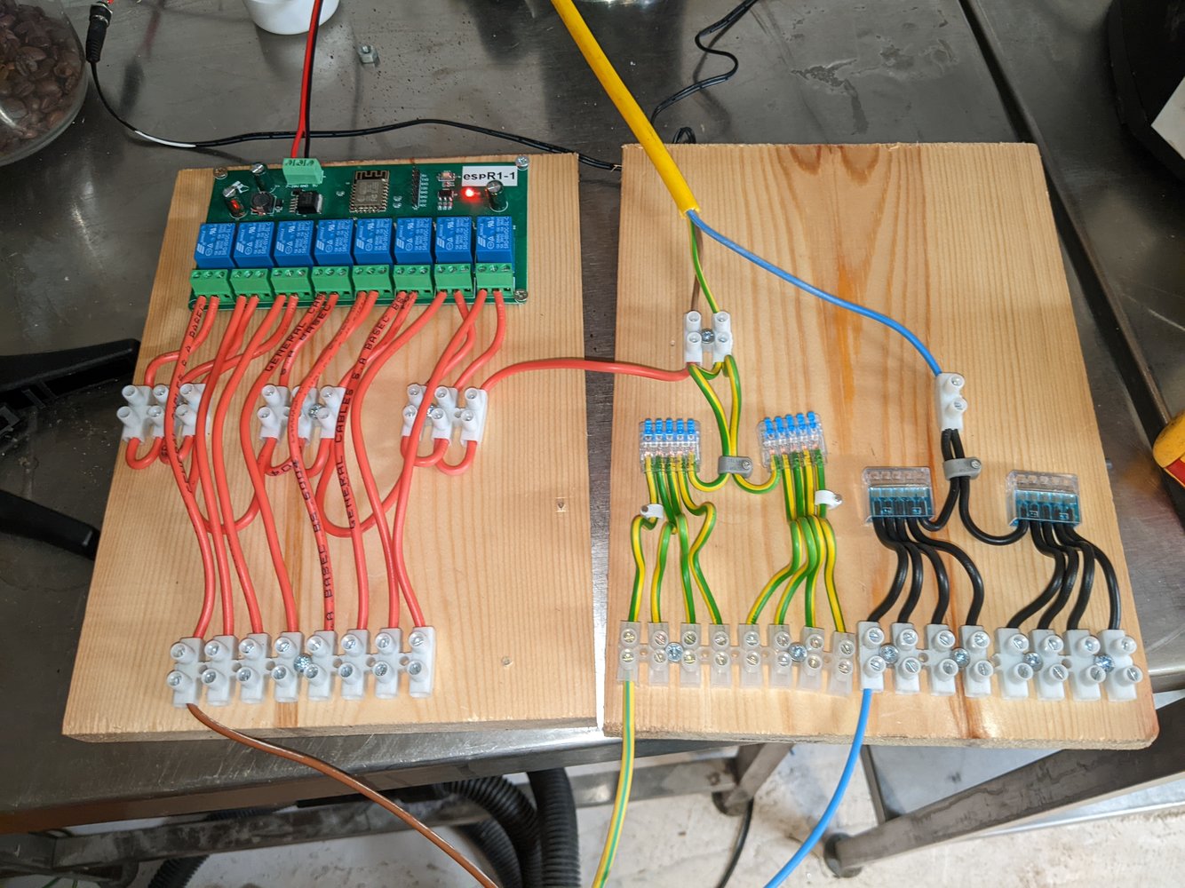

I have a "home made" junction/relay box which controls the lights in my kitchen.
I want to swap out all the choc blocks + wagos for DIN rail terminal, but I can't find a "bus bar" to conmon a row of DIN terminals.
(Basically, I have mains coming in, and eight switched lives +N+E going out via a row of microcontrolled relays, plus live feed to the PSU for the controller)
Are they called something else? Or is there a different way of connecting a common feed to to a range of outputs?
